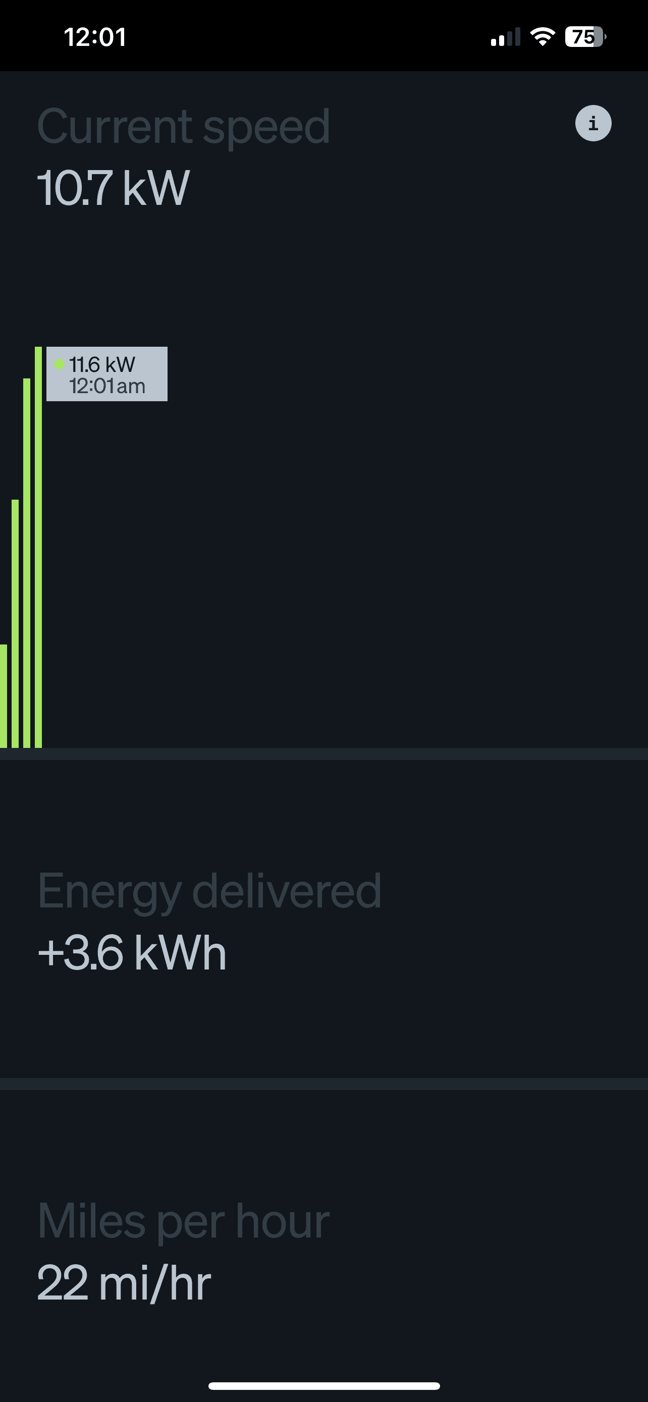

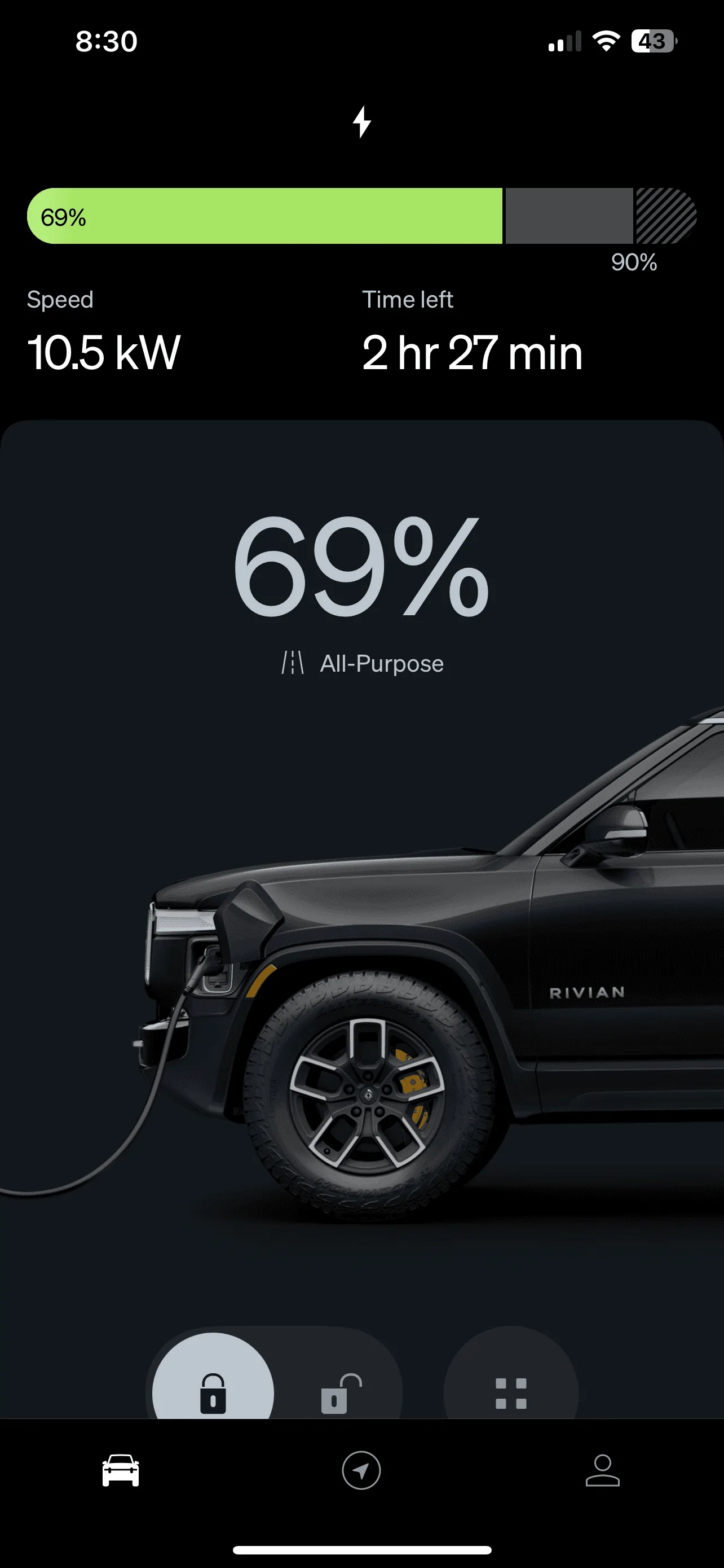

I just noticed the last couple days my Rivian home charger is charging 1 kW slower @ 10.5 kW instead of 11.5 kW.
The car shows 10.5 kW now and charger settings still shows 11.4 kW
It’s always charged at 11.5 kW and no changes have been made to the original install.
I verified the dip switches are set to 48 A default setting and sent pictures of the breaker, charger install, and the inside, including the dip switches to the Home charging team so they can investigate further.
Hopefully they just need to push an update and let it charge back at the normal speed.
The temperature in the garage is 82° and not hot enough for it to throttle down to 8 kW because of a warm plug.
I’ve cycled the amp limit settings from high to low with no difference.
Rivian R1T R1S Rivian Home Charger running at 10.5 kW instead of 11.5 kW IMG_6127
Rivian R1T R1S Rivian Home Charger running at 10.5 kW instead of 11.5 kW IMG_6124

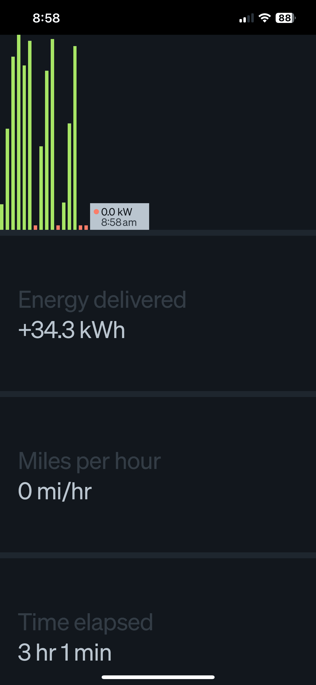

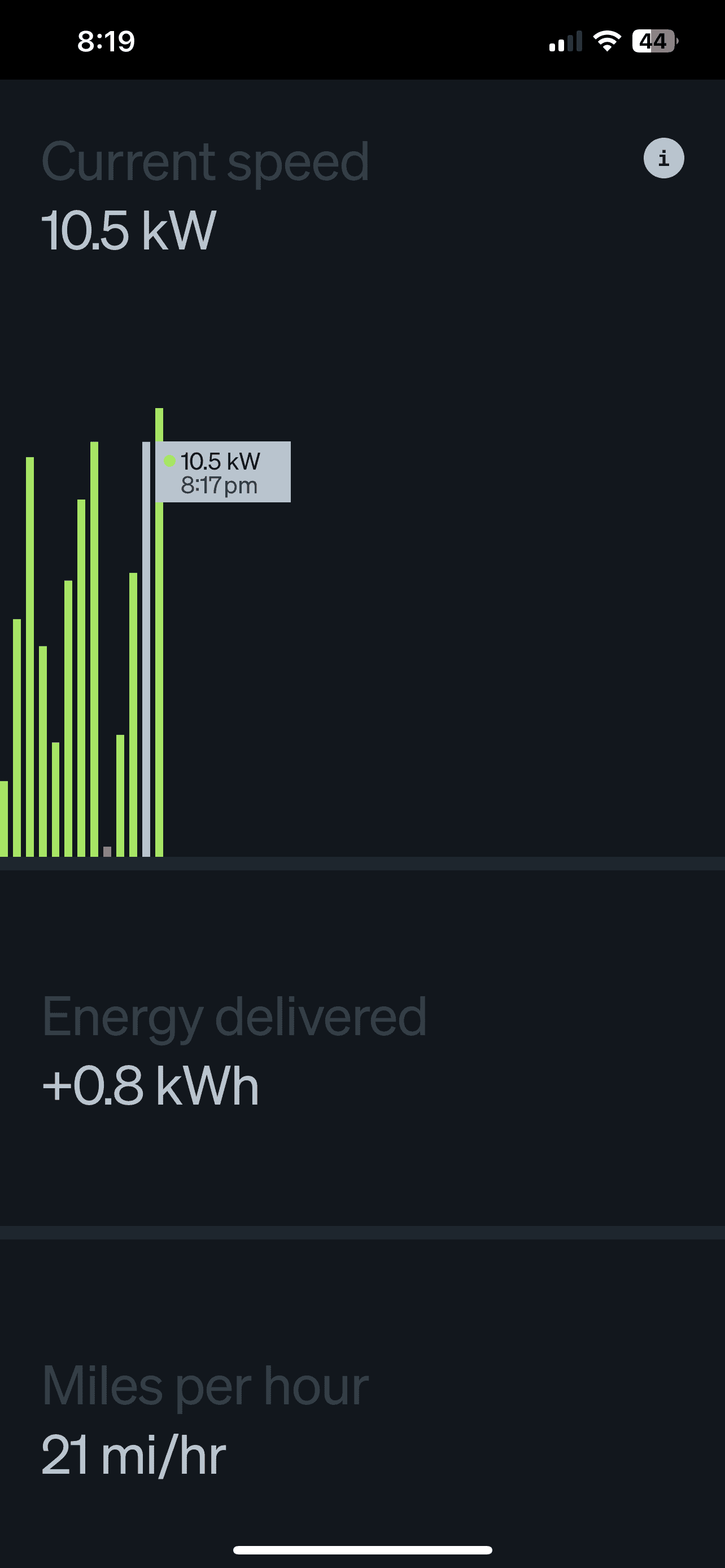

1 hour charging test and 3 hour charging test
Rivian R1T R1S Rivian Home Charger running at 10.5 kW instead of 11.5 kW img_6131-
Rivian R1T R1S Rivian Home Charger running at 10.5 kW instead of 11.5 kW 1699714852297

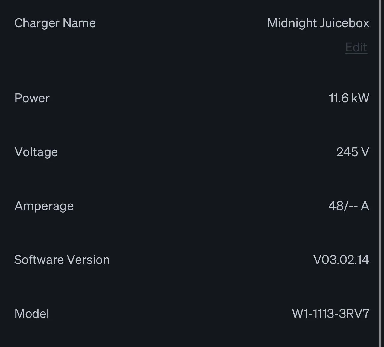

The spikes look like thermal throttling, but is this residential on single phase 240v power and not a 208v condo? The latter will see 10kw since a recent more accurate metering upgrade.

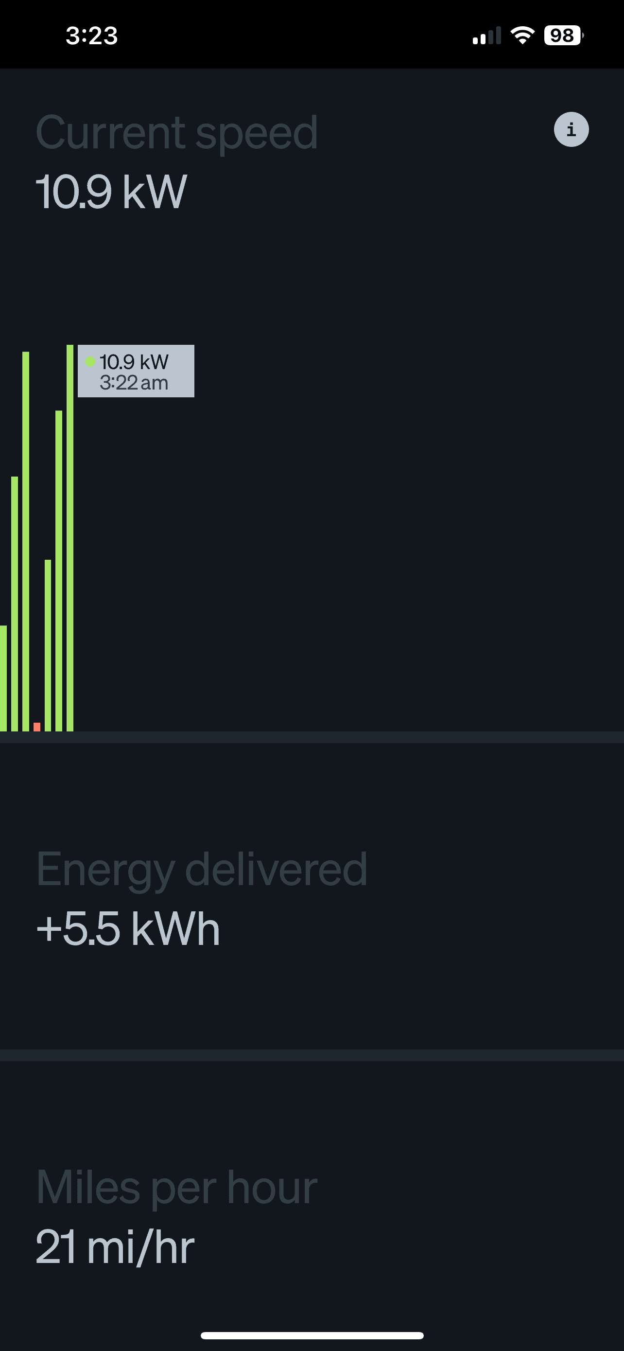

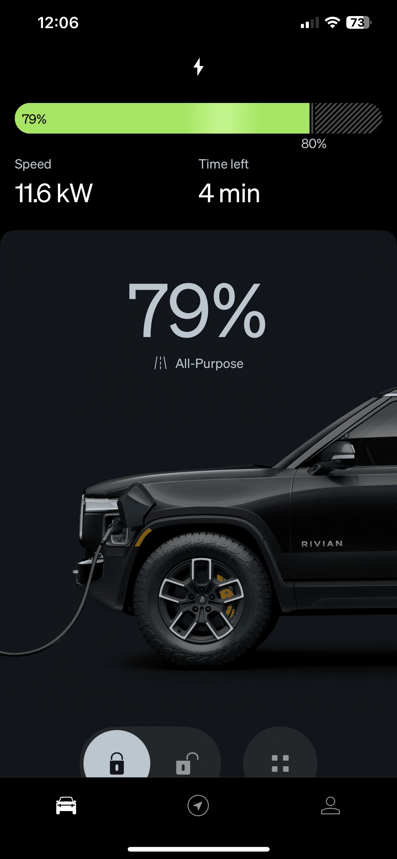

Just your standard 200 AMP Single Family Home residential. Here is the screenshot showing 245 volt and 48 amp / 11.6 kW direct from the charger. The car is only registering 10.7 kW now.

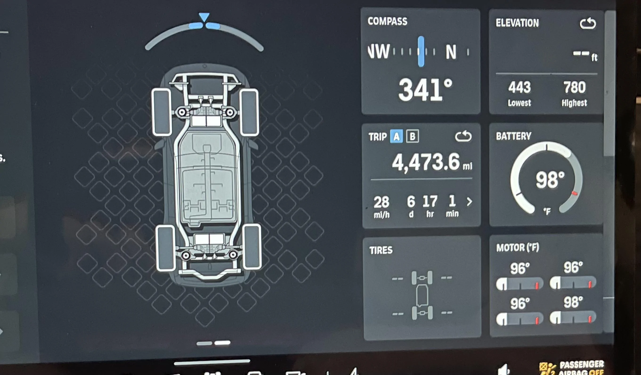

battery temps show 98 degrees.
once in a while it shows 11.6 kW and throttles back down to the 10.7 kW
Rivian R1T R1S Rivian Home Charger running at 10.5 kW instead of 11.5 kW IMG_6133

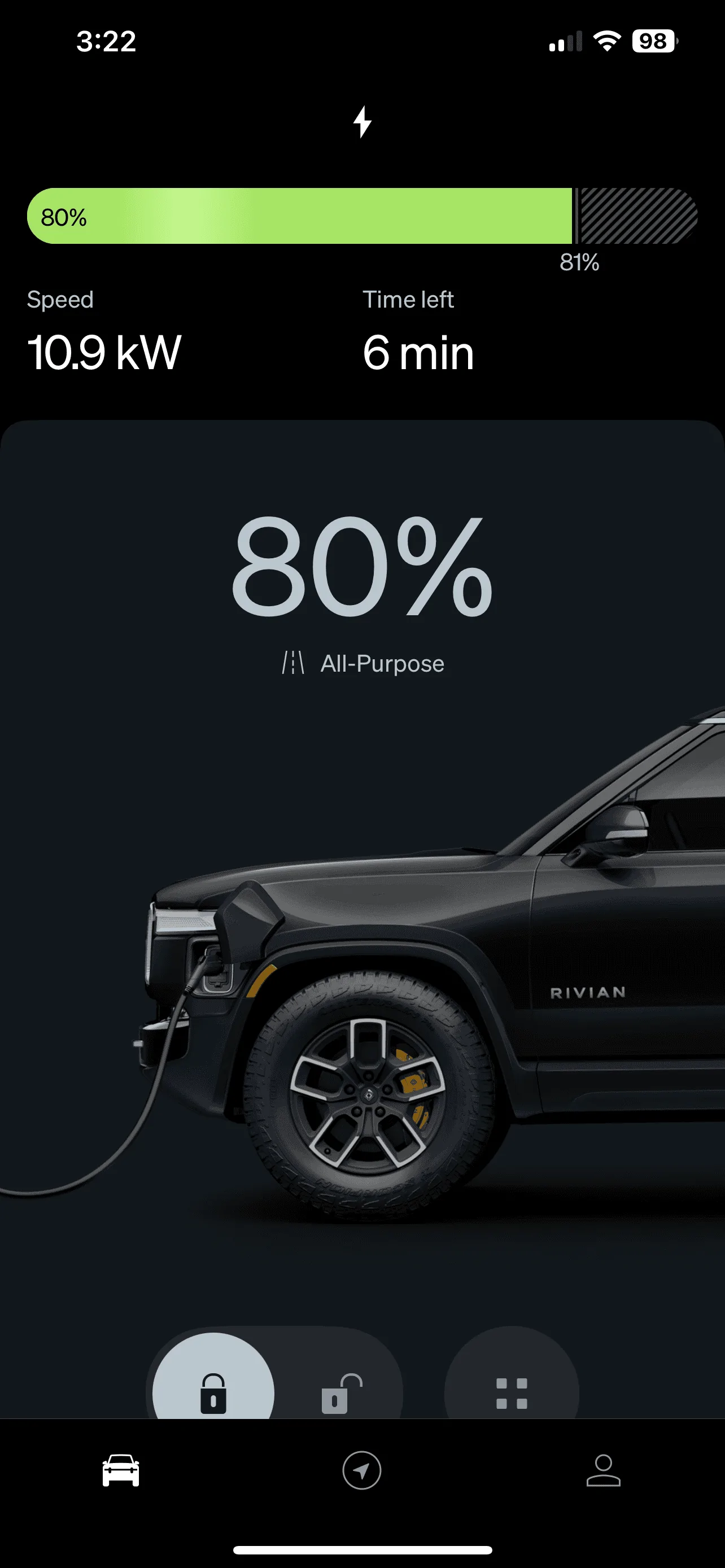

This morning I was as able to hit 10.9 kW instead of 10.5 kW or 10.8 kW. Charger still shows 11.6 kW and 48 Amps. Car is showing around 1 kW less.

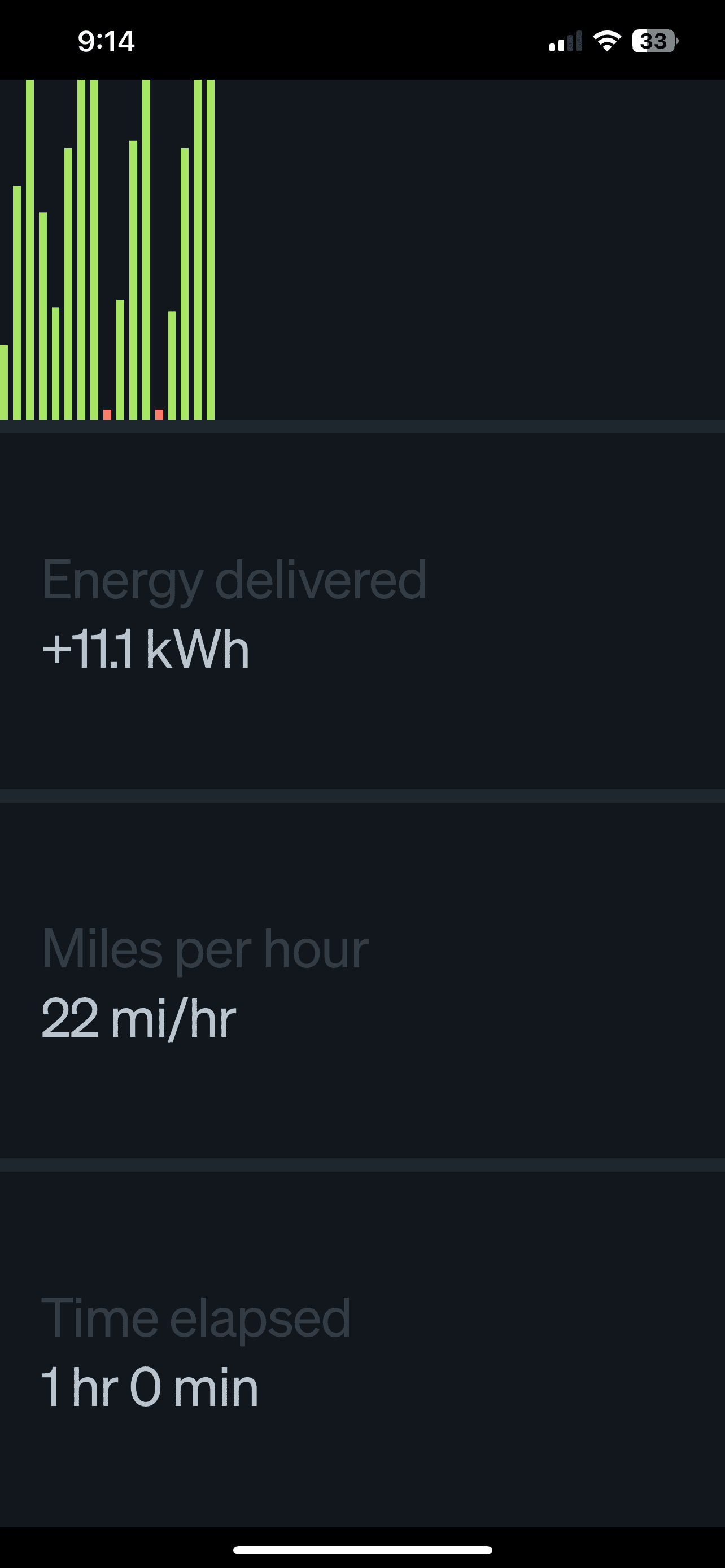

Curious are people seeing slower charging or just lower number displayed.
It is hard to tell because the history shows plugged in time not charging time but when I look at the ones where I unplugged to stop charging I’m seeing about the same rate of charging based on kW delivered even though my number when charging displays lower in the app.
My app shows 11.1 kWh delivered after one hour.
