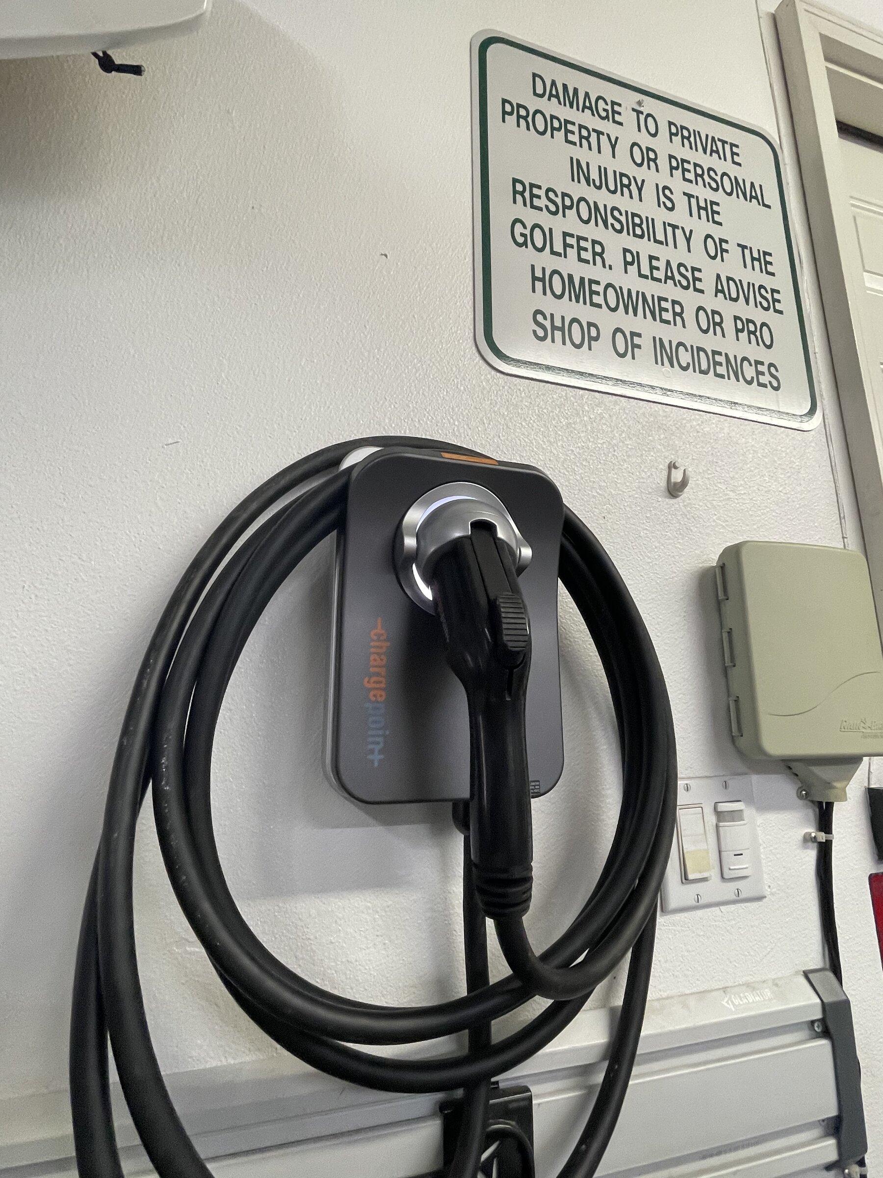

I went with the Chargepoint Homeflex for this reason. My utility company gave a $500 rebate for it. I also had it hardwired in so it is on a 60amp circuit and can deliver 48amps to the car. More expensive than plugging it in to an existing outlet, but I didn't have an existing outlet anyway. Very happy with the charger at this point, and because I have it set up to charge overnight at off peak hours, my utility company also takes $100 a year off my power bill.
Rivian R1T R1S Rivian charger vs 3rd party charger? 9D0944EA-909B-4108-A3DE-BD62B1055325
Exact same setup here. I signed up with Xcel energy for their install. No upfront cost for the charger itself. Renting it for $13 a month on my power bill. Their suggested electrician came out and they take the immediate $500 rebate off my cost. My sub panel needed upgrading as my main panel was full, so the $1300 charge to run wire capable of continuous 48amps on a 60amp circuit hardwired (slightly more miles gained per hour than 40amp/50 breaker) cost me $800 out of pocket, and I can get the federal tax credit on it for 2021. (In CO we get $50 back per year from Xcel for charging at night, but you can override this if needed). ChargePoint Flex app notifies on your phone about charging status etc, I’m not missing any Rivian specific features here with their proprietary charger. It’s a battery, you plug it in and charge-no mystery here. I charge my iPhone on a non Apple charger every night, so. Anyway, I immediately removed the Rivian charger from my configuration, and saved a bunch of money in the process.
