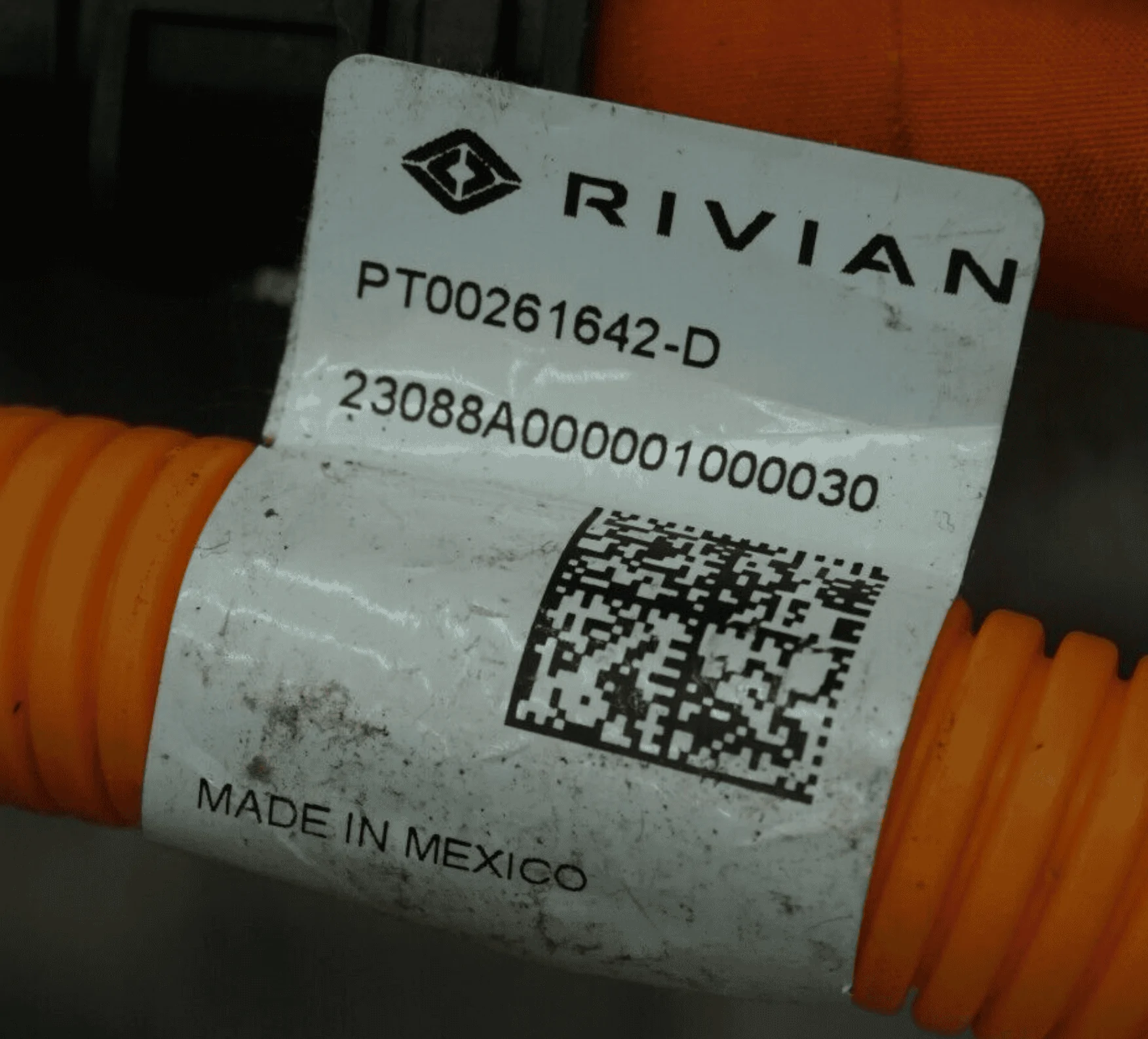

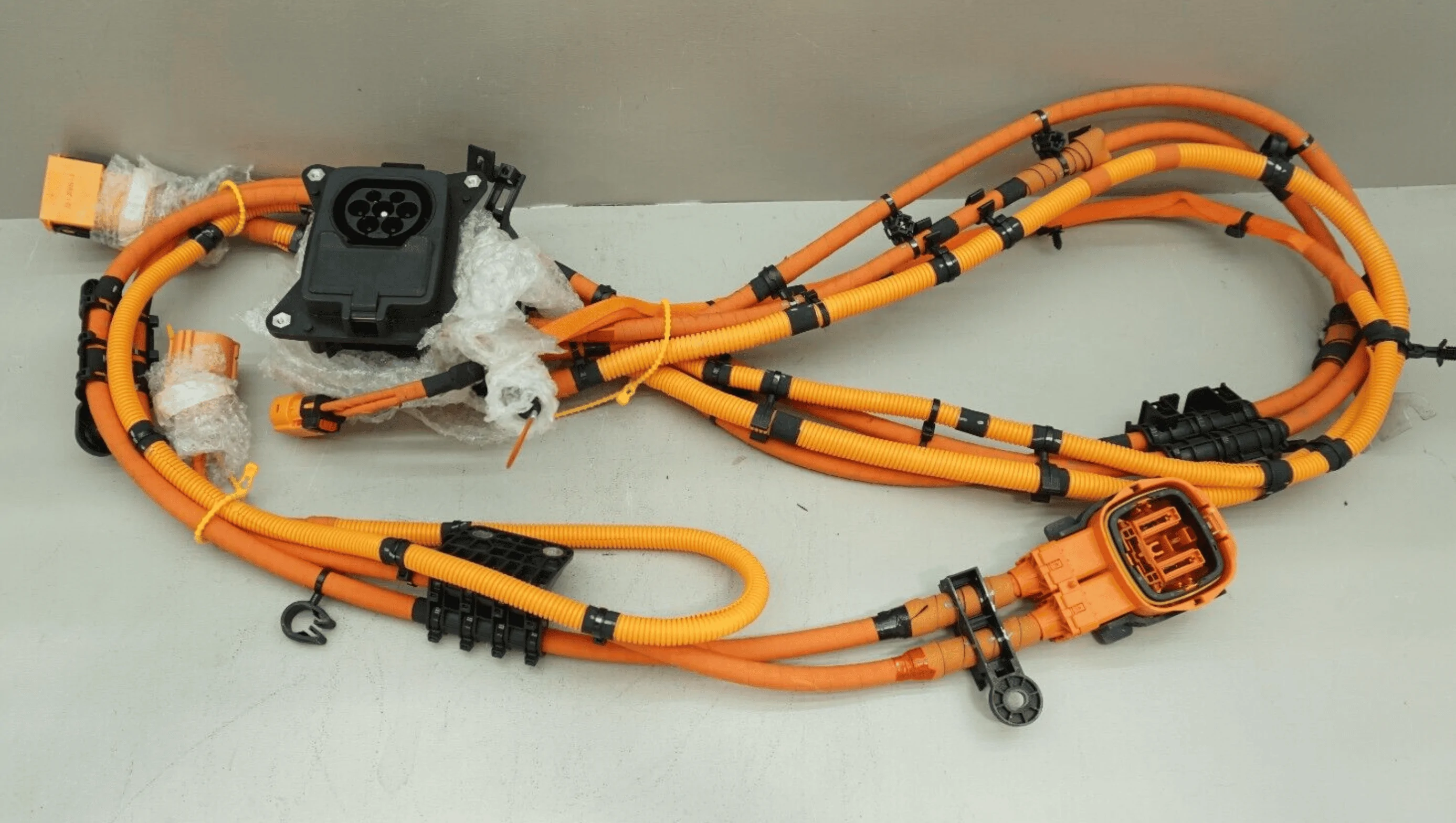

Hi I'm new here.
I just received my R1T imported from NY state.
Have searched online and found this Type2 socket with internal cable and part#, I know Rivian has done tests in the EU but shut down completely in the EU on May 23.
Have seen your other post and I am also working on finding a way to connect to 4G network :)
Rivian R1T R1S Rivian capable of 3 phase charging with minor mods? Rivian Type2 net
Rivian R1T R1S Rivian capable of 3 phase charging with minor mods? Rivian Type2 net part#

Hi I'm new here.
Hi Allan88, welcome to the Rivian Europe club! I'll be organising a get together as our group is expanding...I'm in contact with Rivian on 4G connectivity - they seem to be genuinely willing to solve it but slow to respond, as this is obviously not a prio. Do you have yours licensed for the road yet? If you have questions - let me know, happy to help!
