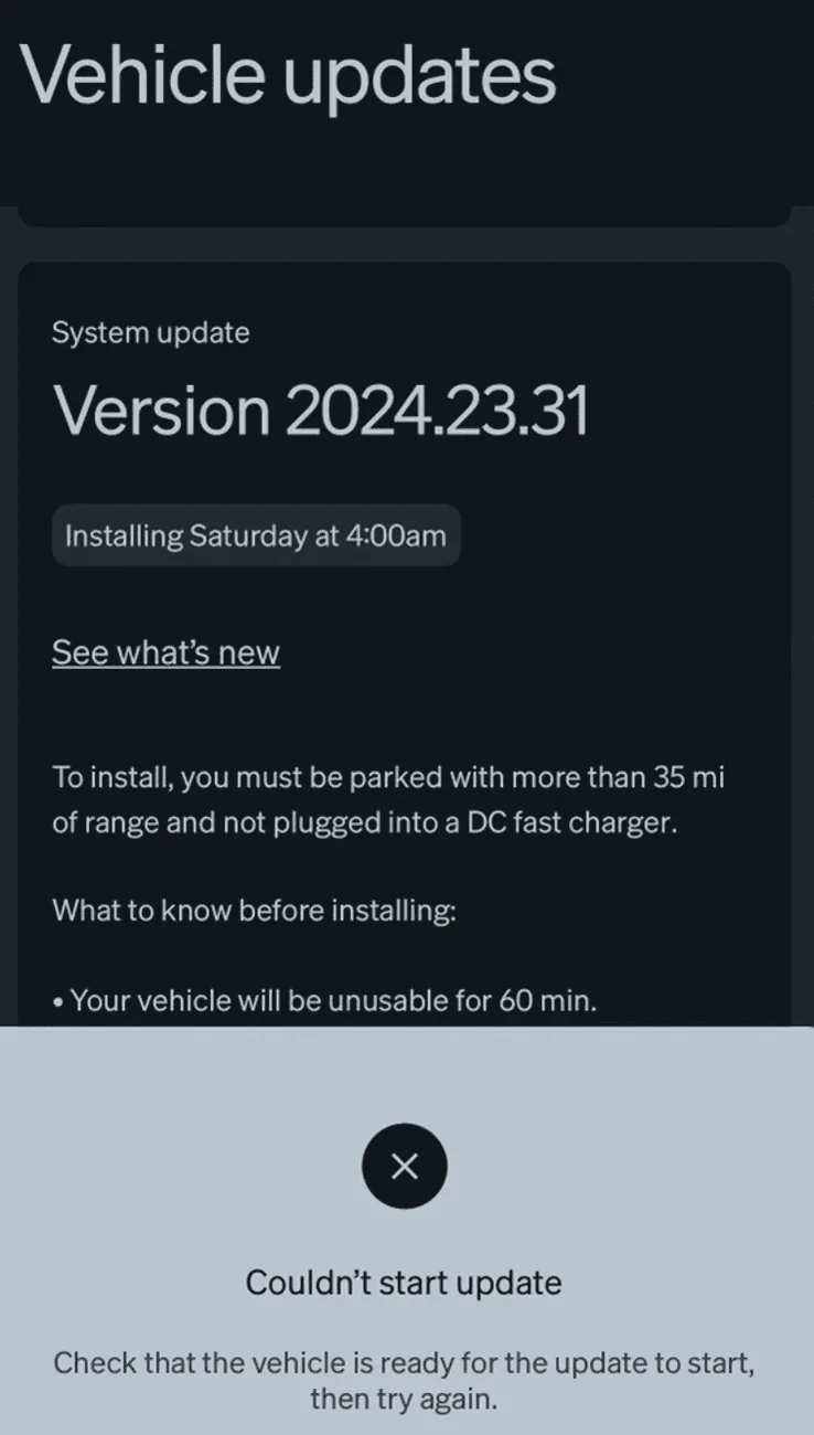

Today before I went out to my car the leave for home, I tried to turn on the climate controls to cool it off. I kept getting the message from my phone (and my wife's phone) that it "Couldn't turn on. Something went wrong. Please try again."
I received this same message when I tried to update the vehicle when it was parked (and yes, I did ensure that it was not plugged into a DC charger and had the appropriate level of charge).

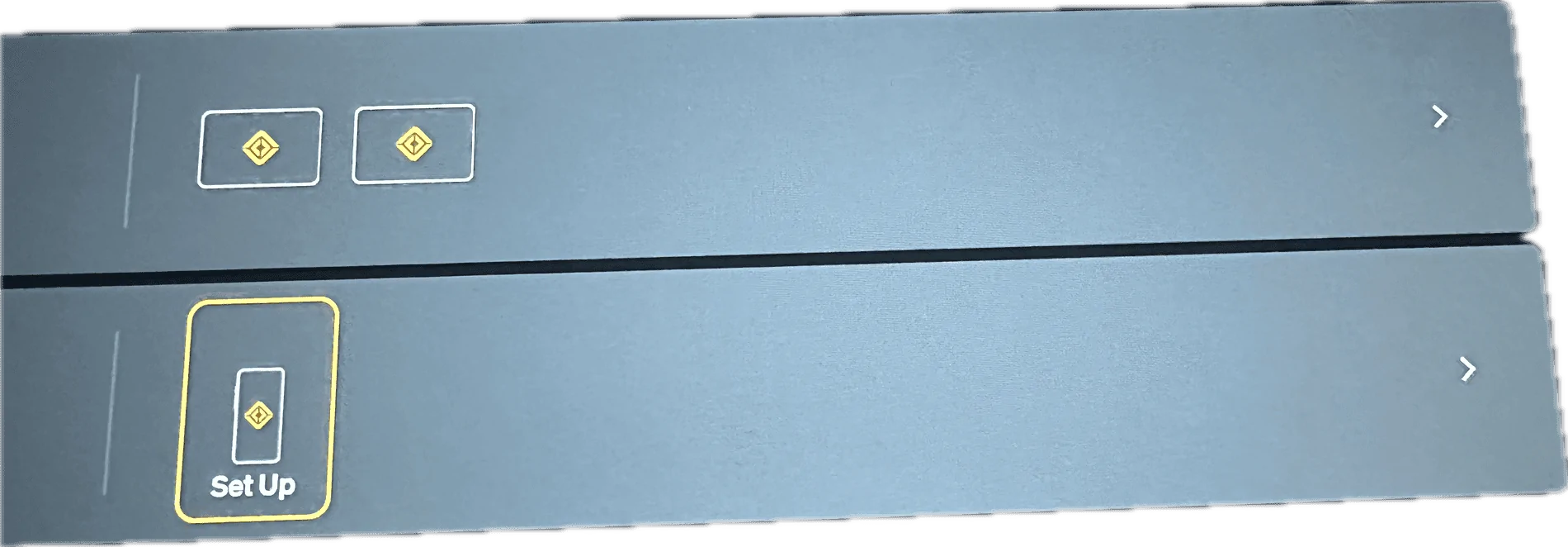

Still having the issue. Can someone please confirm if on their Keys menu their phones show there?
One of my profiles has the two keycards and the other has a phone set up option. On the iOS app, it shows ours phones. Wondering if this might be the issue.

I resolved the issue, all you have to do is delete your phone as a key from the Rivian app. And add it back again

This was my solution, too. Wish I had done it sooner. Was too concerned I was going to mess something else up. No clue why it all of the sudden stopped working, but has been ever since.

I had this issue just a few days ago... This is what I did to fix it.
In the app, I deleted my phone as a phone key.
Closed the app
Reopened the app
The app asked if I would like to add my phone as a key
Followed the on-screen procedure
Done. No further problems.
