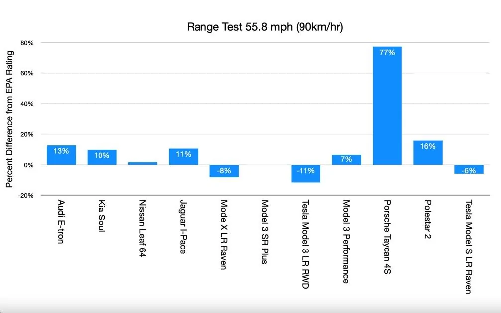

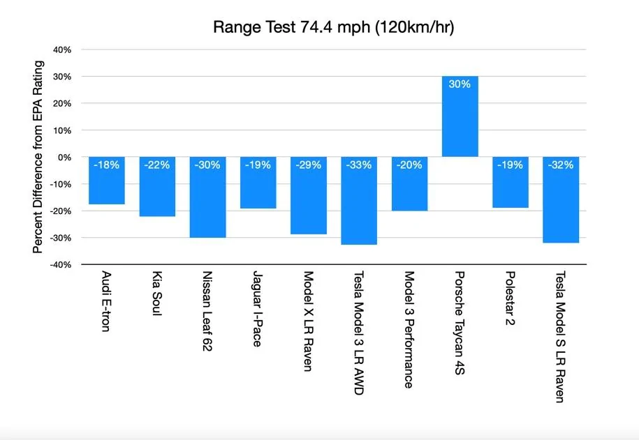

The EPA range is calculated based on drag results from a dynamometer and then some calculations to account for aerodynamics. No data from the actual road. Show me any independent test that correlates to the EPA range ratings across multiple vehicles.
A rating where I can drive my Taycan aggressively and exceed the EPA rating by 50% and then drive my Model X conservatively and fall short by 30% is not a reliable metric.
I would not trust any EPA range or efficiency rating without real world data. So whatever rating Rivian gets for the R1S won't tell you much until we get some results from Independent testers.
There are several journalists along with YouTubers conducting decent real world tests the provide much better data.
Here is an example using Bjorn's data. He does range tests at 90 km/hr and 120 km/hr. As you can see the Taycan is a clear outlier. It dramatically over-performs in the real world. Now looking at the E-tron versus the Model X, you can see a big advantage for the E-tron over the Model X at slower speeds (90 km/hr) relative to the EPA rating. This aligns with my experience between my E-tron and my Model X which have both been used for daily driving. At the time my Model X had an EPA rating of 295 miles and my E-tron was 204. In the real world a true range rating might have been 265 miles for the Model X and 230 for the E-tron in mixed driving (90km/hr average speeds).
