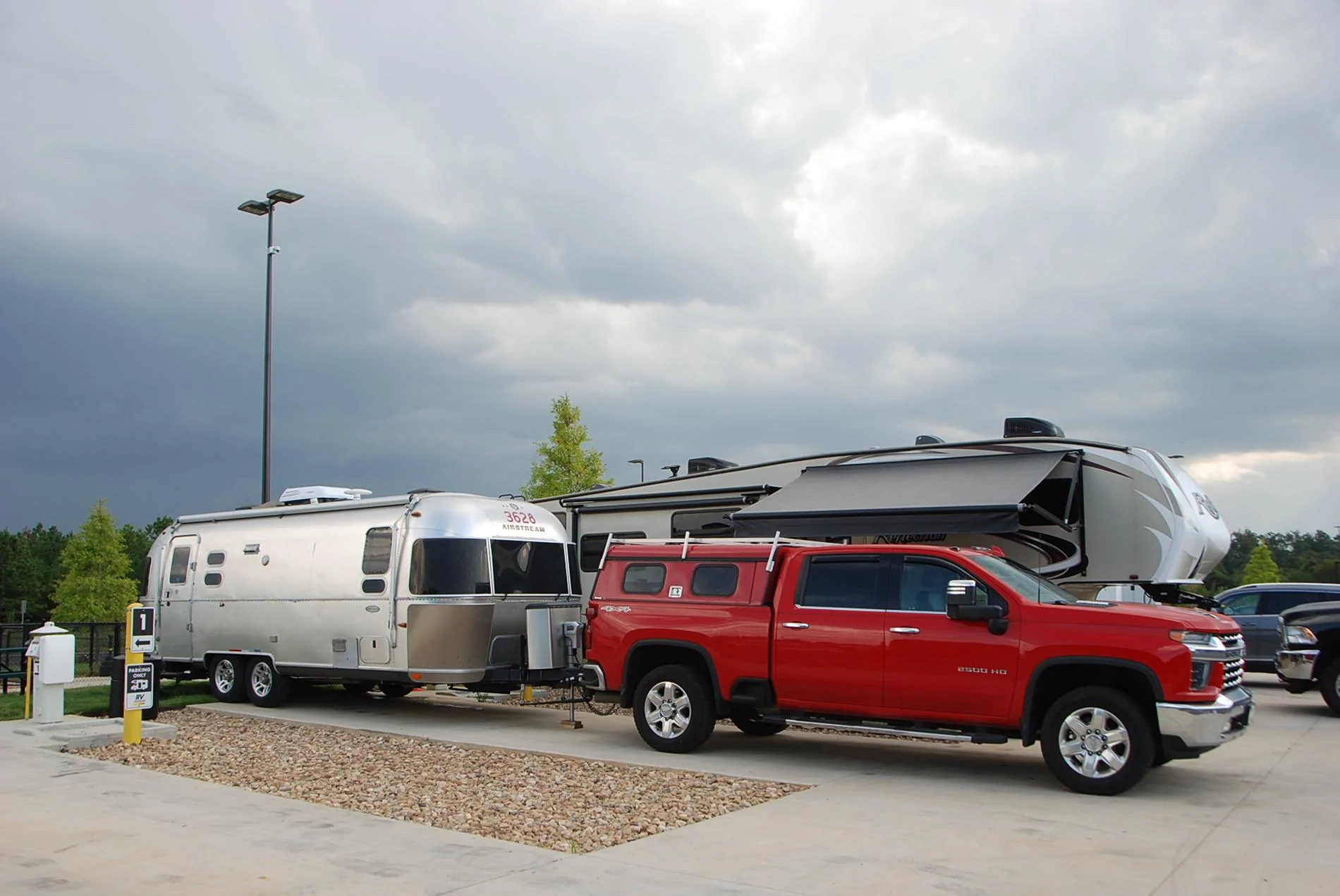

Long time Airstreamers here. We have had two 25FB's over the years. Our current Airstream is a 2015 that we have had for ten years. We have over 2,200 nights of Airstream camping, and have been to all of the lower 48, Alaska, and most of Canada. We have done most of the towing with Chevrolet Silverado Diesels. We still have a Duramax in the fleet.
We have had the R1T since April of 2023. She pulls the Airstream just fine. She does just as well as the Duramax. The issue is the range. We get about 1.2 miles per kWh. Now that we have access to the Tesla Superchargers, we may venture out further with the R1T.
