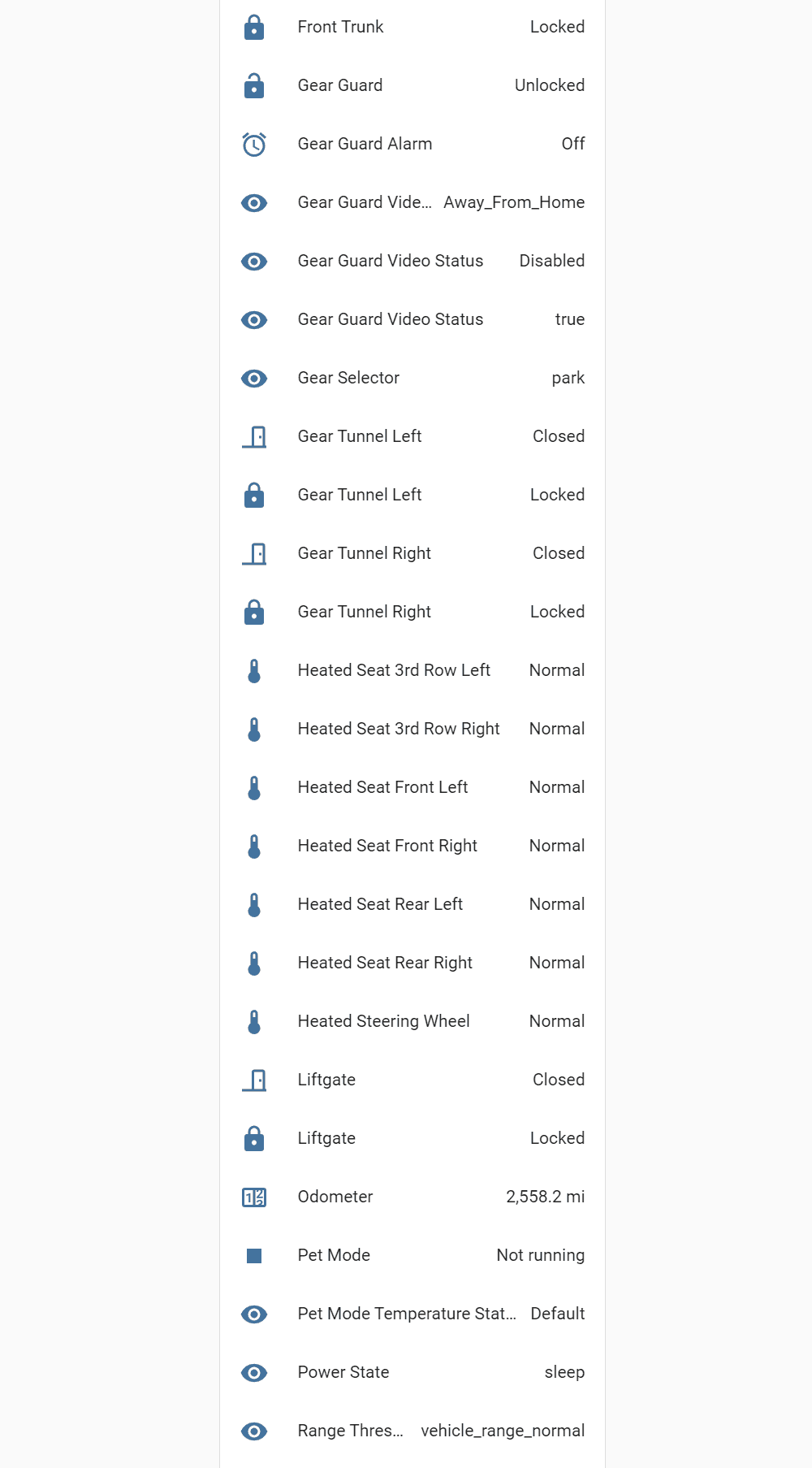

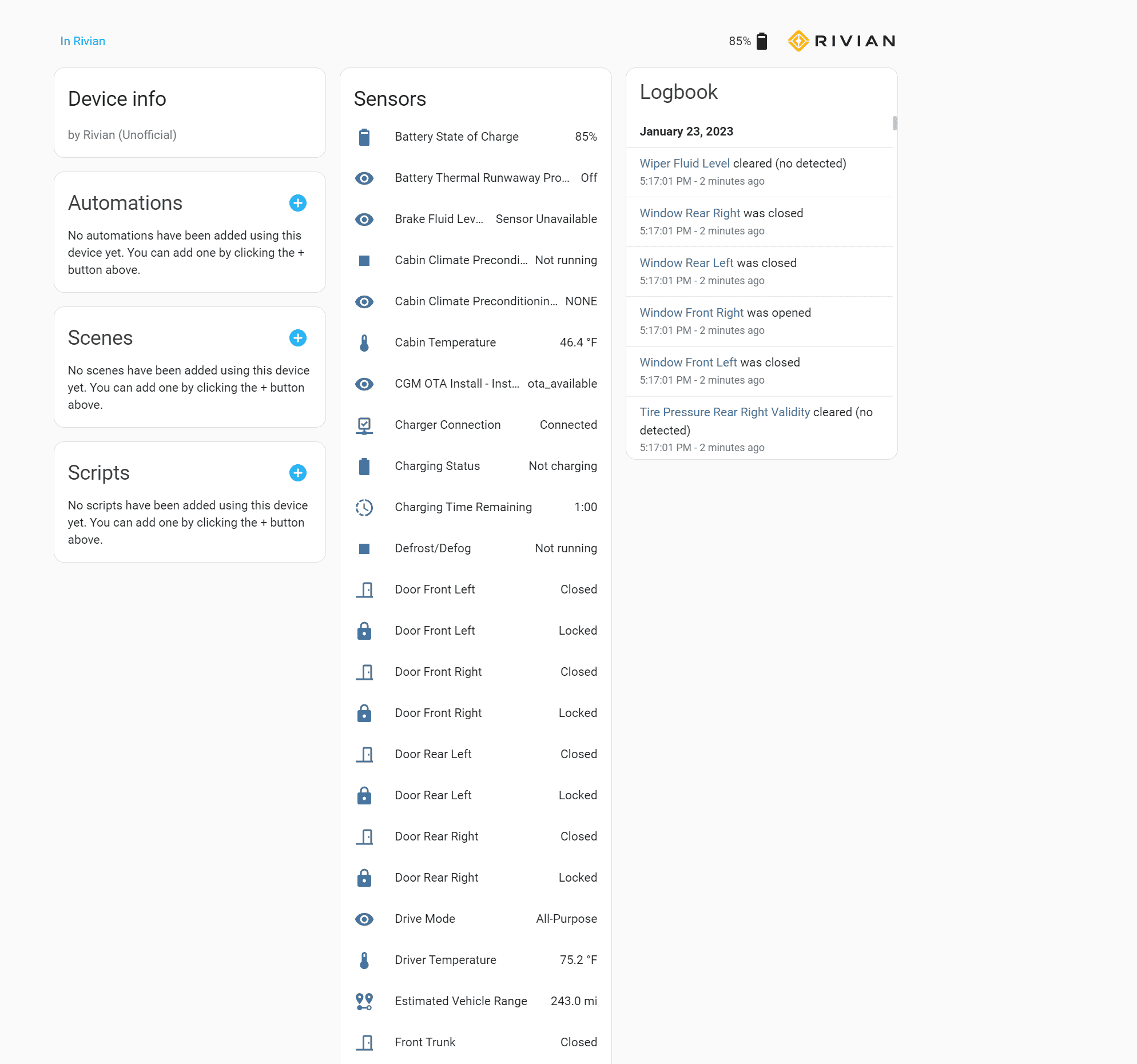

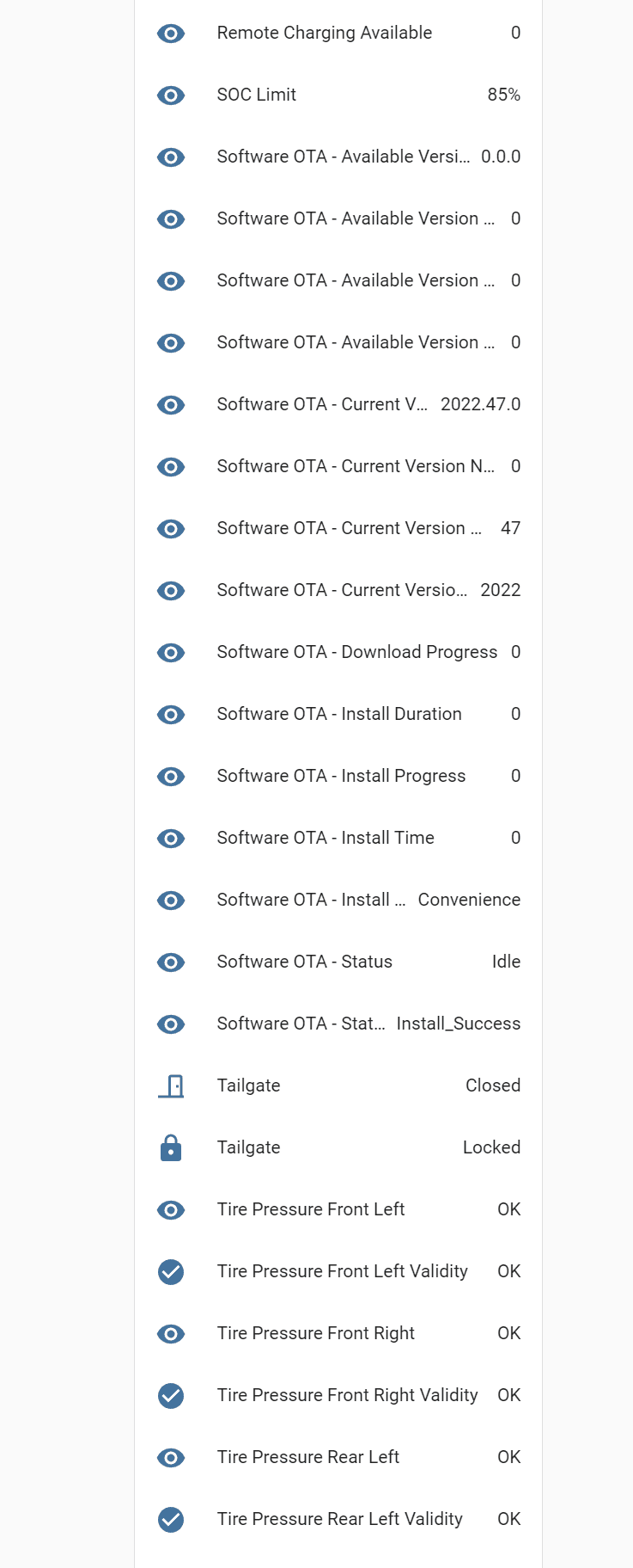

Ok this was super easy to setup! It looks like the repository was already in HAC's just had to load it and configure it and now I have 88 data points to play with!
Rivian R1T R1S Rivian ABRP integration working (if you're motivated 🙂) 1674523209314
Rivian R1T R1S Rivian ABRP integration working (if you're motivated 🙂) 1674523244140
Rivian R1T R1S Rivian ABRP integration working (if you're motivated 🙂) 1674523276363
Rivian R1T R1S Rivian ABRP integration working (if you're motivated 🙂) 1674523314468
Weird it has Tonneau data but I have not Tonneau lol... This is epic thanks!
