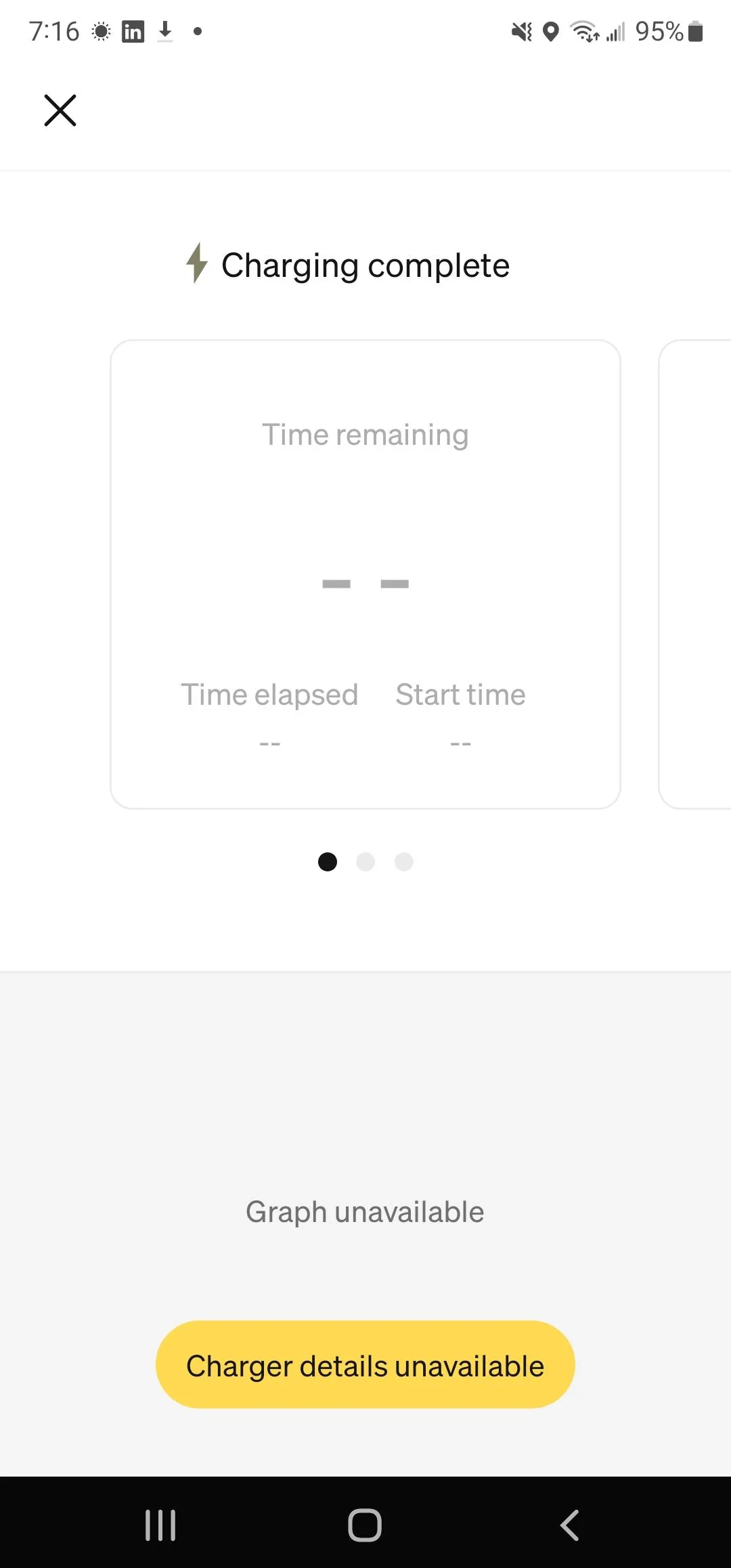

Anyone having this happen with Charge Sessions and Rivoan Wall Charger?
No data logged in the history (maybe it only logs public chargers?), and Rivian Wall Charger does not recognize a Rivian vehicle apparently?
I sent a note to CS but crickets....

I've had this happen a few times, but no wall charger; just using the mobile charger. The vehicle is still clearly charging, I had to restart the app for it to give me info again. 🤷‍♂️ Your situation may differ.

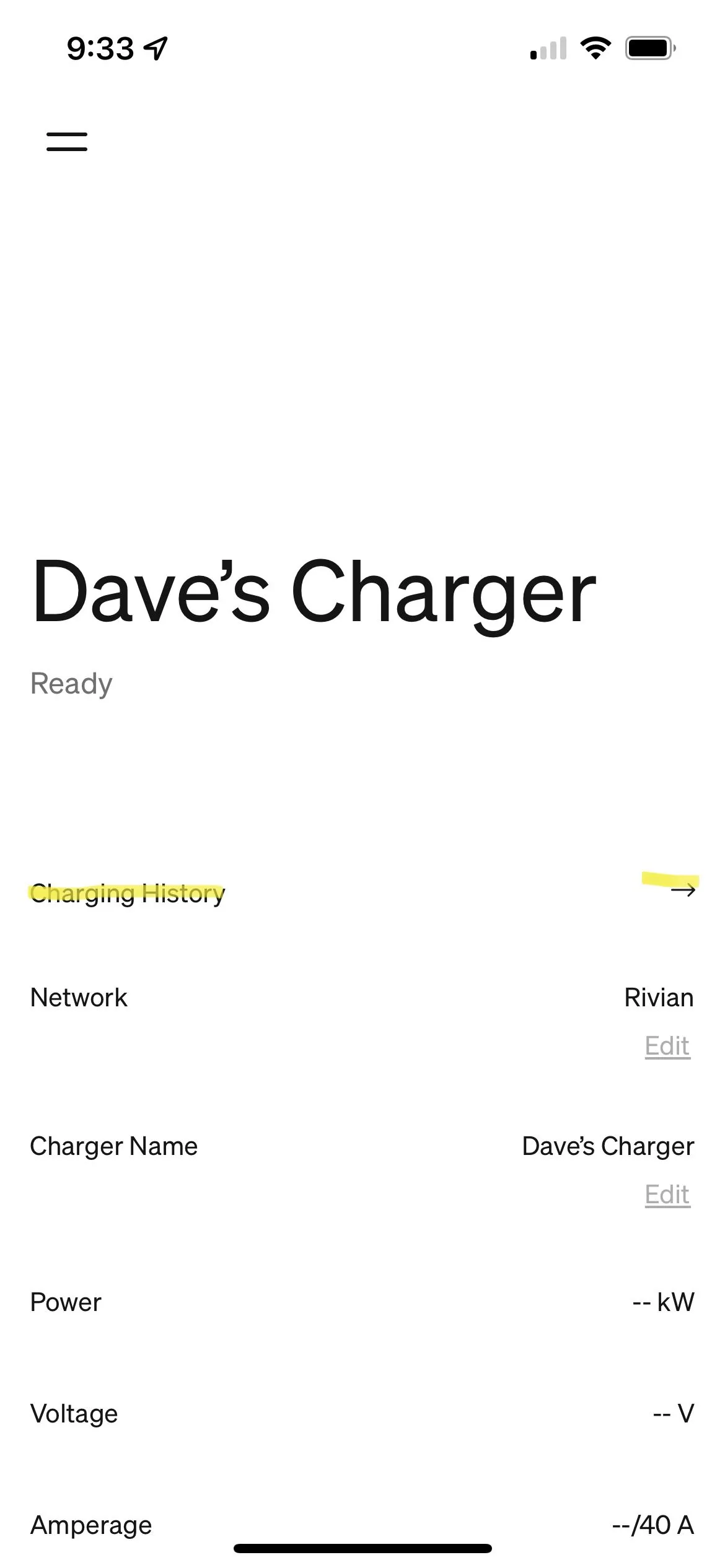

No disagreement that the charger software needs work. But you can get charging history. Push the charging history arrow and it takes you to that page. Can’t believe a Rivian charger can’t recognize a Rivian truck.

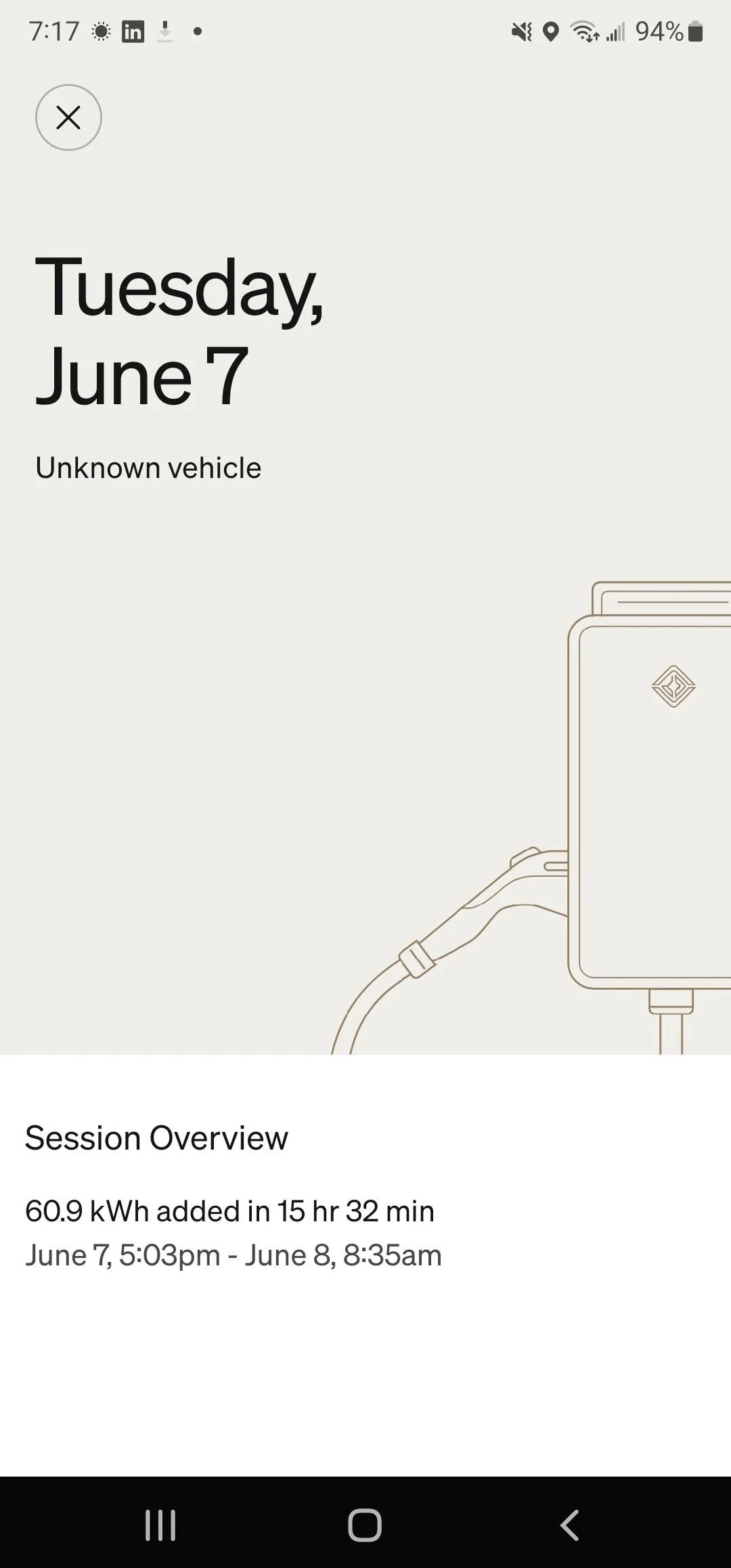

It does this for me too, but you can access the wall charger from the app directly, and the history there seems to have the session data.
Still doesn't recognize the vehicle though.

I have the same issue. Unknown vehicle when plugged into my R1T.

The charging history is not very useful. The starting time is when you plug it in not when it started charging. Same with the end time. Its when you unplug it. So if you schedule your charging to lower you electric cost you really do not know how fast the charger is working. I have opened a ticket on this. If the vehicle is really controlling the charge session the the vehicle needs to store and display the charge history.
