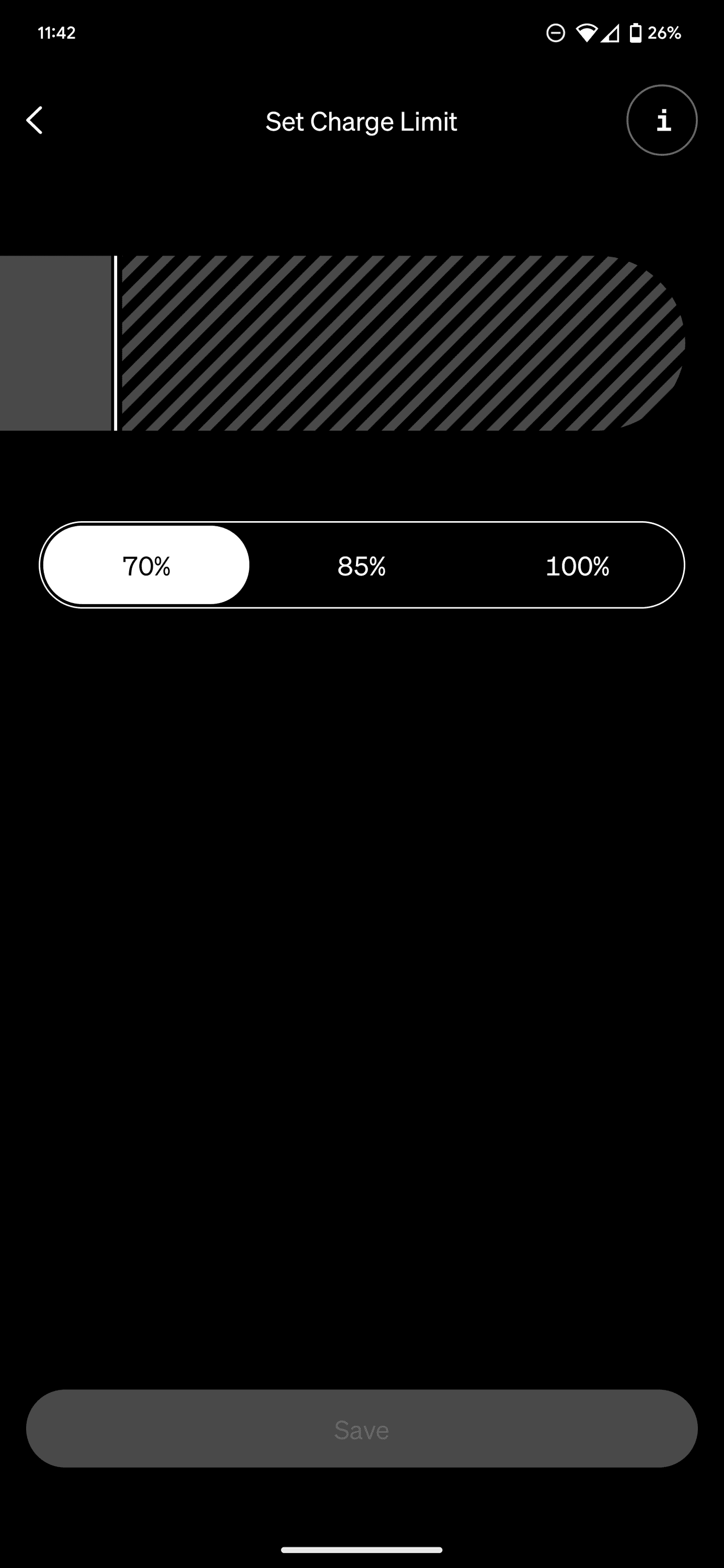

The Rivian app allows you to change the charge percentage (70/85/100) while it's plugged in. Just tap on "View charge session" from the home screen and then the pencil icon under the charge percentage bar.

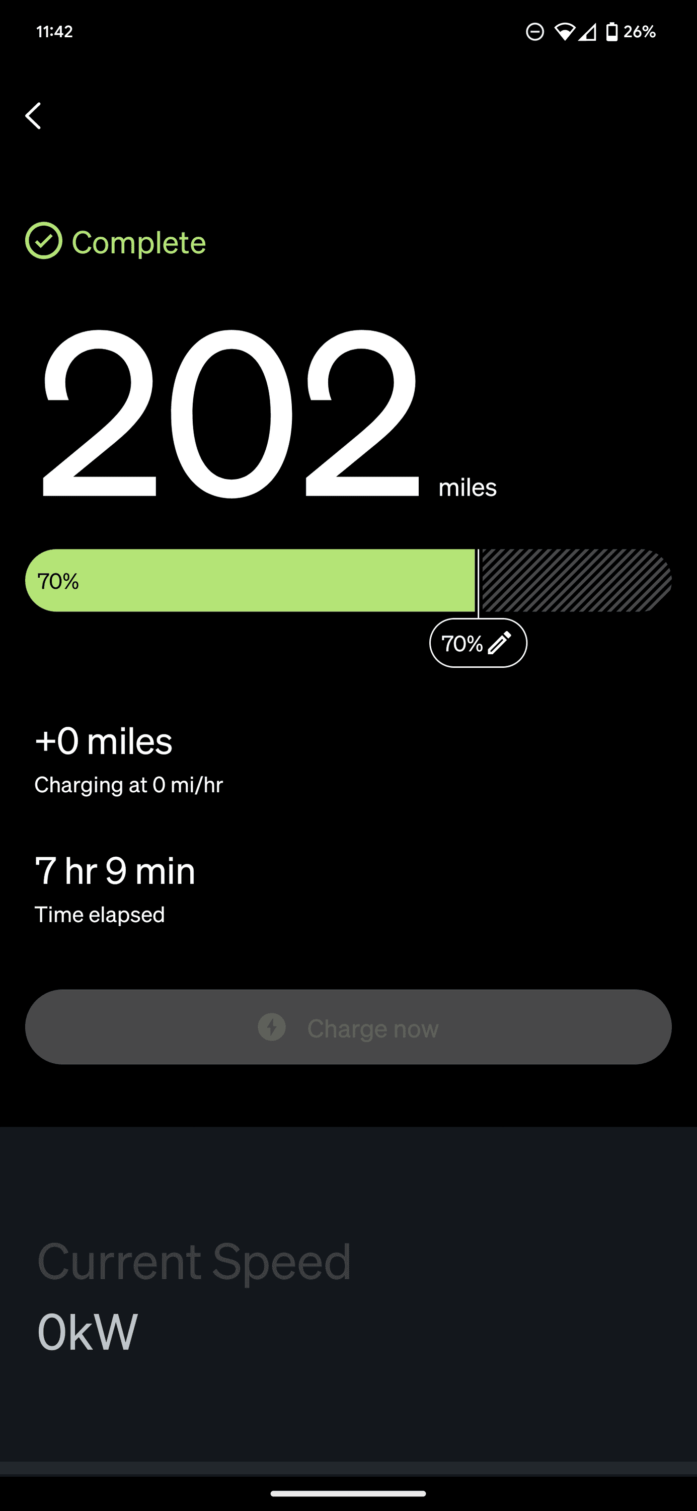

I never heard back from ChargePoint support, and their phone lines have been down for days. Decided to experiment a little when I arrived at the airport this morning. Good news, charging does resume without issues. I set the limit to 70% for the week and will bump it to 100% the night before I get back.
