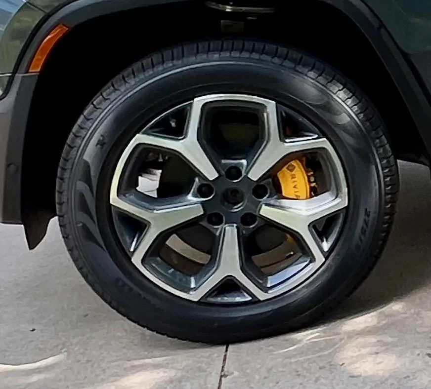

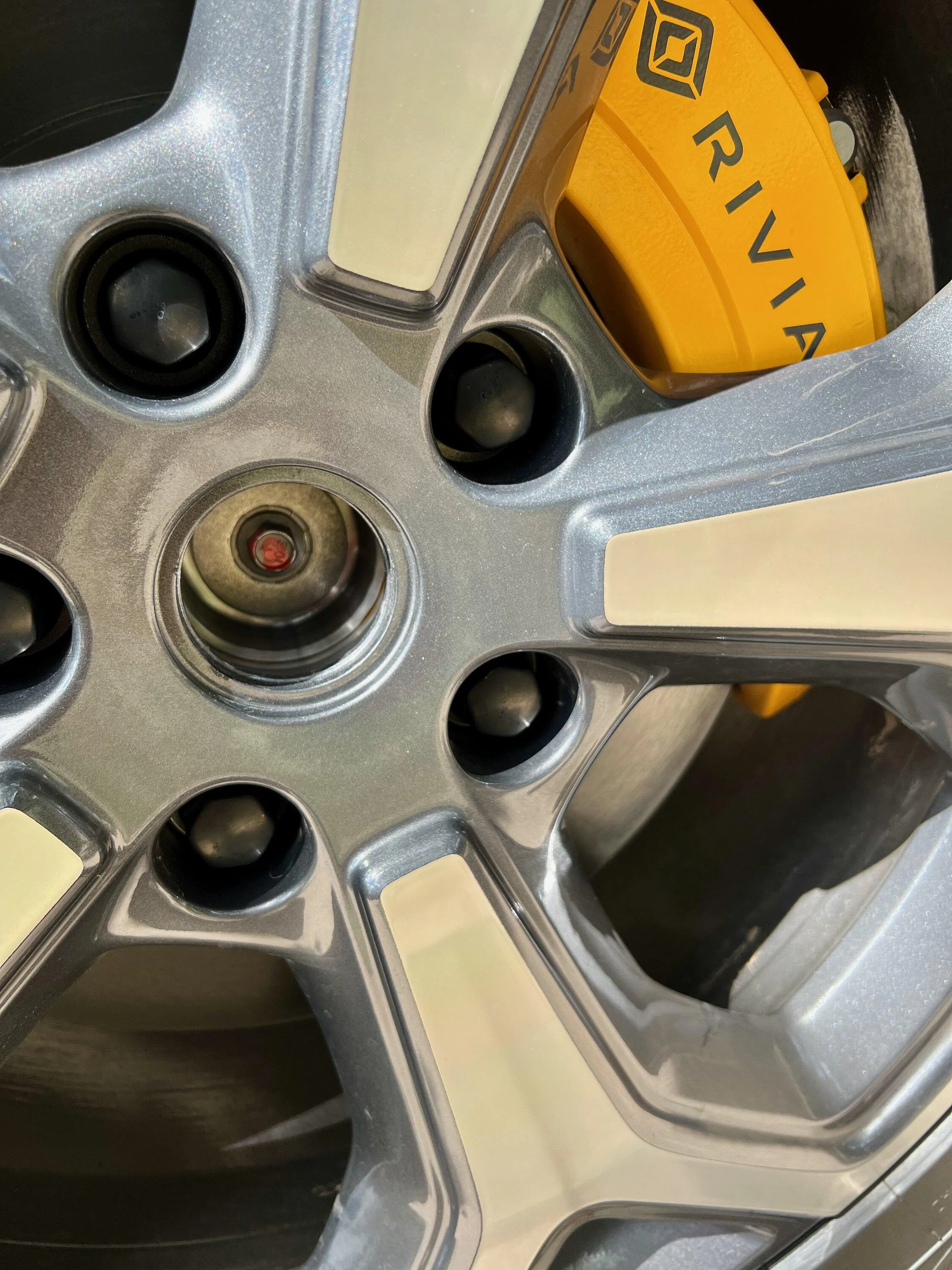

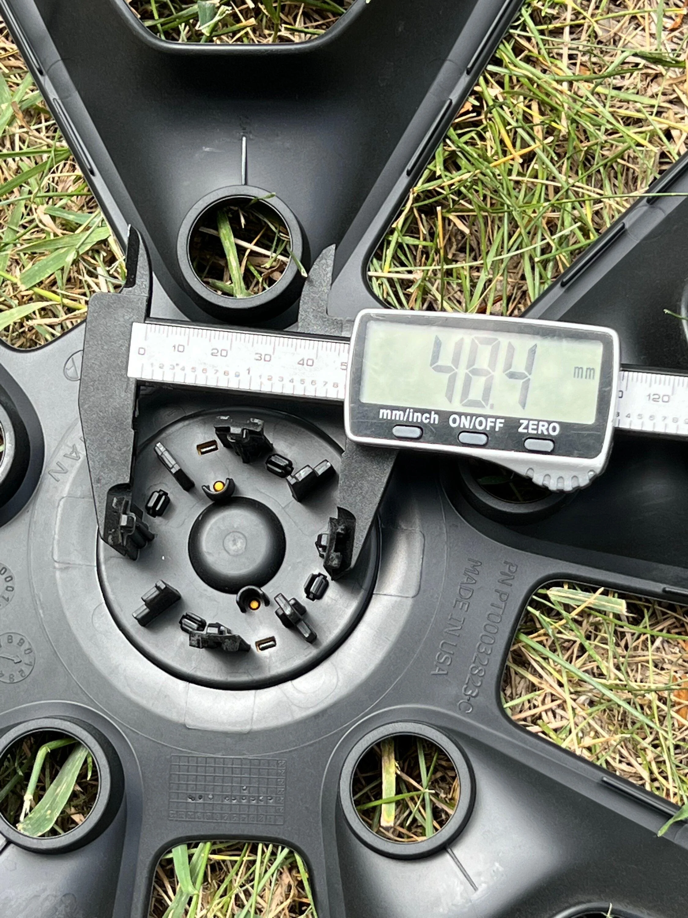

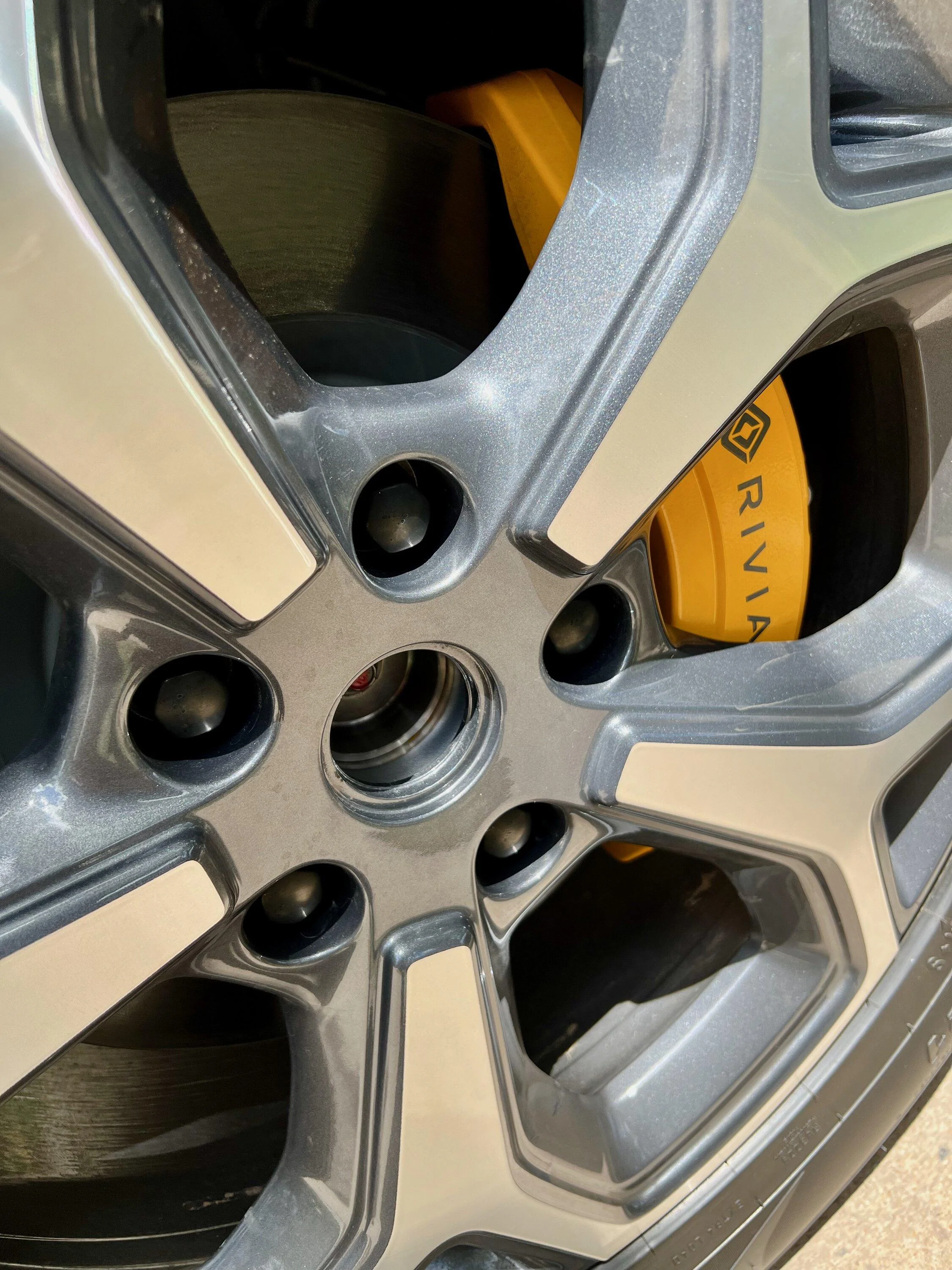

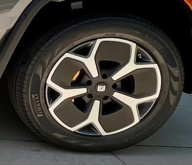

A few pictures of the 21" wheels with and without the aero cover.
The hole that remains without the cover has a few 'steps' in it, so it's hard to say exactly what size cap might fit best, but it is around 48.4mm (1.9").
Note that this is MUCH smaller than most other vehicle center caps, at least all the ones I'm familiar with. Most I've seen are in the 56-76mm range.
Note that the center portion on the aero cover is definitely *not* removable. There is a groove around it that makes it look like it might be, but when you look at the back you can see it is directly molded in. The little Rivian logo/badge itself looks like it might be removable, but is definitely not the correct size or shape to fill the hole left behind when removing the cover.
While I'm hopeful someone can identify a readily available plug or existing center cap that would fit perfectly, not optimistic... I think unfortunately it will have to be a custom injection molded or 3D printed solution.

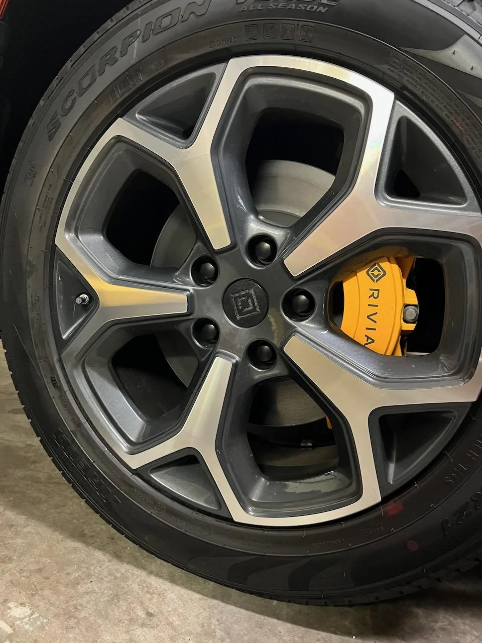

Got my R1T today and had these 3D Printed center caps ready to go. Looks much better without the covers.

You can see the calipers now! Great job...
