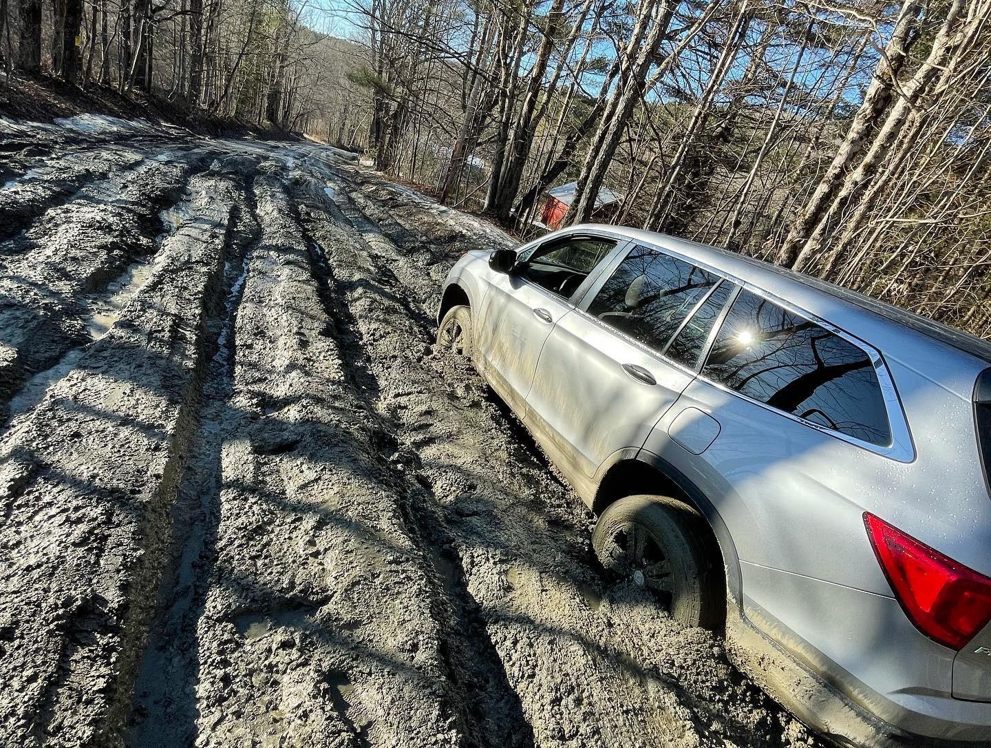

This year has been a particularly bad mud season and I was thinking it's past due I grabbed a recovery/tow strap to keep with me just in case. Ideally I would like to get one strong enough for the R1T so I could keep it when I swap my subaru for an R1T.
Anyone got any advice on what to get here? Do I need something custom for either the subaru (crosstrek) or rivian?
Any advice is appreciated. I am pretty new to towing things, (I usually just abandon cars whenever the wheels slip and buy a new one).
For reference, here's a pic of our mud season this year:

Beyond that, the picture above is exactly why I run mud tires. All-terrain tires just don't cut it in the deep stuff.
