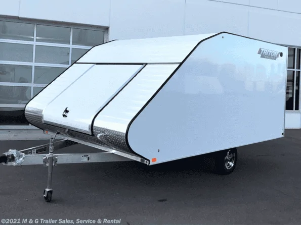

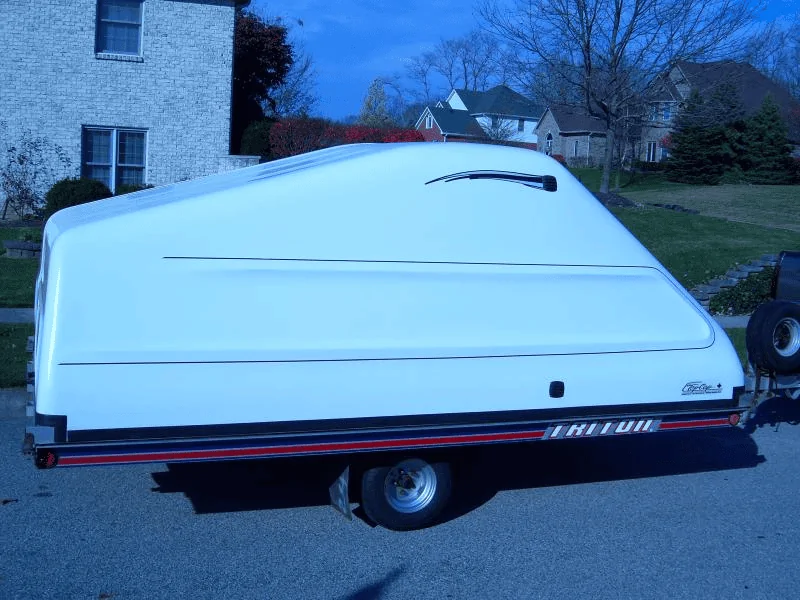

I think you can handle it a couple of ways. I like an aero enclosed snowmobile trailer (which I've used behind a Model X since 2016) and that works fine … wide tires, low profile, aero, single axle, all aluminum, light.) But I think Triton stopped making the trailer I was using years ago (it's basically this trailer with a fiberglass cap that hinges front and rear on gas struts.)
https://www.tritontrailers.com/snowmobile/open/
Rivian R1T R1S Recommendations for towing a snowmobile? 1640904425678
This trailer without the cap is also very light (you can push it with two snowmobiles by hand.)
I think this trailer is also an efficient option, but I don't know if it's still in production.
Rivian R1T R1S Recommendations for towing a snowmobile? 1640904785646
But the good news ends there. Even with a light trailer, towing in the snow will cost 30% to 50% of range. The X would cover 200 miles in the snow, or 100 miles towing. EVs are efficient. ICE vehicles are inefficient. So the small percentage increase in work for towing is a small percentage increase for an ICE, but a huge percentage increase for an EV. Plus, it's cold, you're in hilly terrain, pushing through snow … so range plummets. I was always within 30-50 miles of even the more adventurous trailheads, so a 100 mile round trip and a Supercharger nearby made it ok. I'm now driving an F-150 Hybrid which really makes light work of it. Hopefully my R1T shows up in Jan or Feb and I'll hook up the big snowmobile trailer (enclosed v-nose) and I'm sure it will handle the towing duties for short range from the cabin to the steeps.

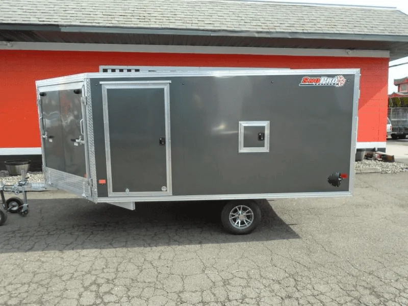

btw. the trailer I use now behind the F-150 Prius looks a bit like this snopro. Very light. Move it by hand even full of sleds and gear. But tall and you can feel the windage.

I have the second trailer listed. Its extremely light, WIDE at 8'6", so likely would need tow mirrors. I Needed them on my Avalanche and Escalade, so I know I would need them on the R1T. Its light enough that it doesnt even have trailer brakes, and they are not needed.
The downside of most of these trailers is the suspension, using a twist rubber spring. Which do wear out faster than springs. But the twist rubber is MUCH lighter.
