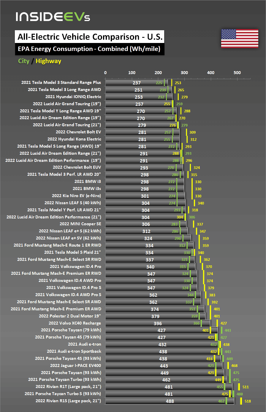

This is from September. I am not sure it was posted here before. I didn’t expect Rivian City efficiency to be that much worse from efficient EVs in the pack with regen and all. I wonder how much accelerating slowly will help.
Don't take this the wrong way, because I'm geniunely curious about this since it doesn't surprise me at all. Why wouldn't you expect the rated EPA efficiency to be significantly lower than the other EVs listed here? It's a much larger vehicle than everything else on the list.
If you are genuinely curious, let me repeat what I said: “ I didn’t expect Rivian City efficiency to be that much worse from efficient EVs in the pack”.
English is my second language but my understanding is that what I said does NOT mean “rated EPA efficiency to be significantly lower than the other EVs listed here”. It does however mean that I did expect the city efficiency to be worse but not as bad as highway difference. The reason I expect the gap to be smaller in city than in highway is that in highway loss is mostly due to aerodynamic and less so due to rolling resistance. None of which can be recovered. In City there is a lot of stop and go. M3 spend less energy accelerating and get back less decelerating. R1T spend more energy accelerating due to weight but recovers more decelerating. So if R1T spend twice as much energy on highway, I expected to spend may be 1/3 more in the city. This chart shows it is almost as bad in city. If it is accurate, it means either Regen losses are much more significant than I thought or there is something else about the physics or mechanics of what is going on that I am missing. I am genuinely interested to know what that is.
English is my second language but my understanding is that what I said does NOT mean “rated EPA efficiency to be significantly lower than the other EVs listed here”. It does however mean that I did expect the city efficiency to be worse but not as bad as highway difference. The reason I expect the gap to be smaller in city than in highway is that in highway loss is mostly due to aerodynamic and less so due to rolling resistance. None of which can be recovered. In City there is a lot of stop and go. M3 spend less energy accelerating and get back less decelerating. R1T spend more energy accelerating due to weight but recovers more decelerating. So if R1T spend twice as much energy on highway, I expected to spend may be 1/3 more in the city. This chart shows it is almost as bad in city. If it is accurate, it means either Regen losses are much more significant than I thought or there is something else about the physics of mechanics of what is going on that I am missing. I am genuinely interested to know what that is.
Ah. Yeah, my understanding is that regen is say... 2/3 efficient. City driving is energy usage is going to be driven by inertia (accel/deccel). With the Rivian being significantly larger in weight, the energy to speed up will be higher, and then more is also lost in regen. Plus bigger tires. And four motors.
I think having the independent motors reduces efficiency more than people think. Given that the F150 is (apparently) lighter than the Rivian, but apparently gets about the same rated range with roughly the same battery size, I'm really curious to see if the F150 has much better city efficiency and much worse highway range. Particularly when cruising at speed with the RIvian in conserve mode..
edit: I also didn't see you say the "city" efficiency originally. Which is a big part of the reason I was confused.
