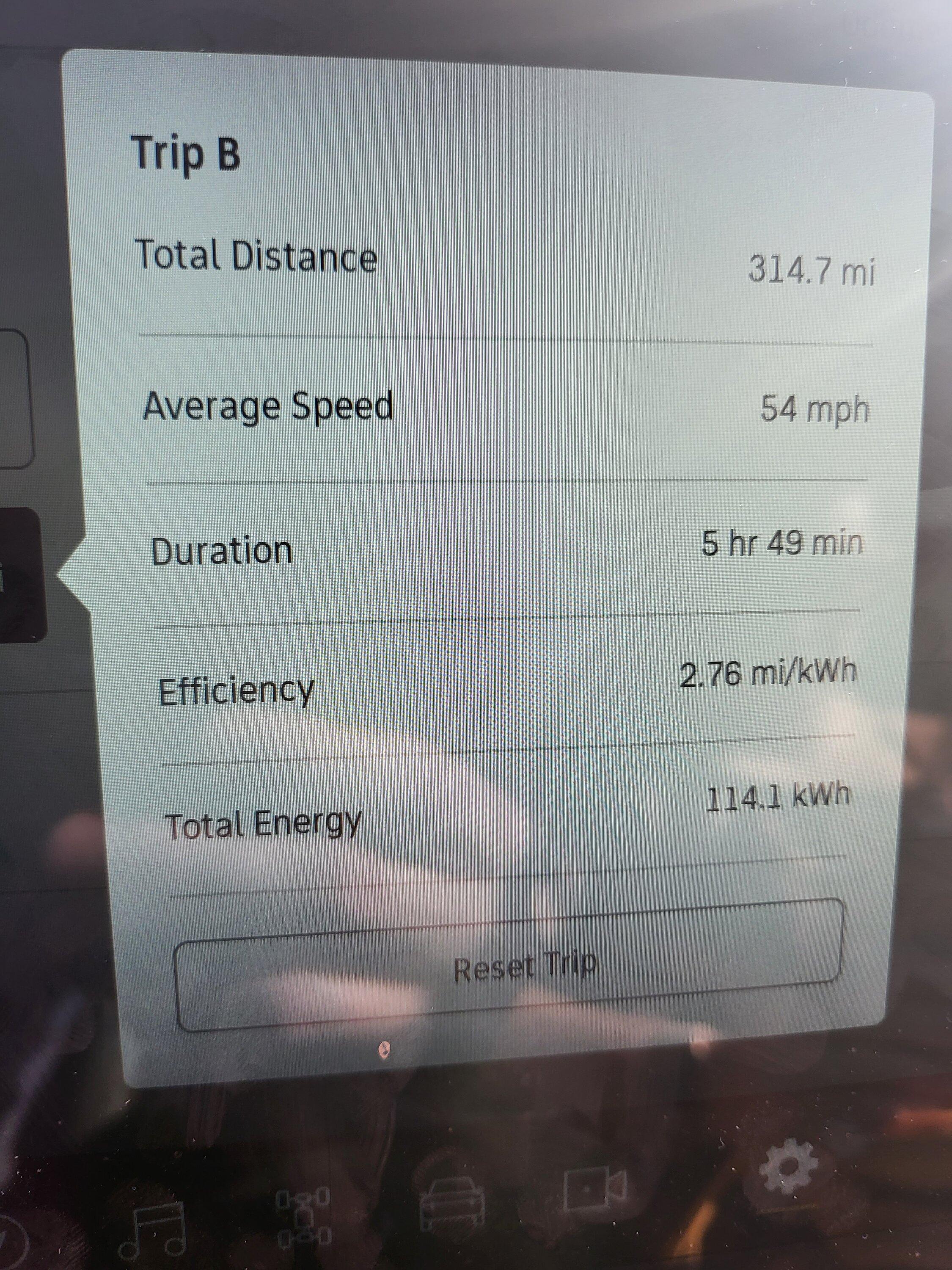

So they are guessing my efficiency at 2.27. Which is worse than i was getting on that trip because i had all seasons on.
I just drove up from Houston, Texas to western NY and i averaged 1.91 the standard A/T's.

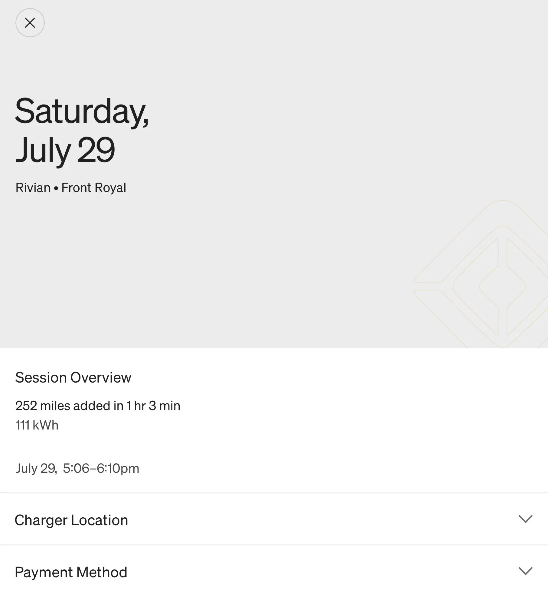

The first picture is my trip meter when i arrived at the RAN on 7/29
Thanks for the input!
