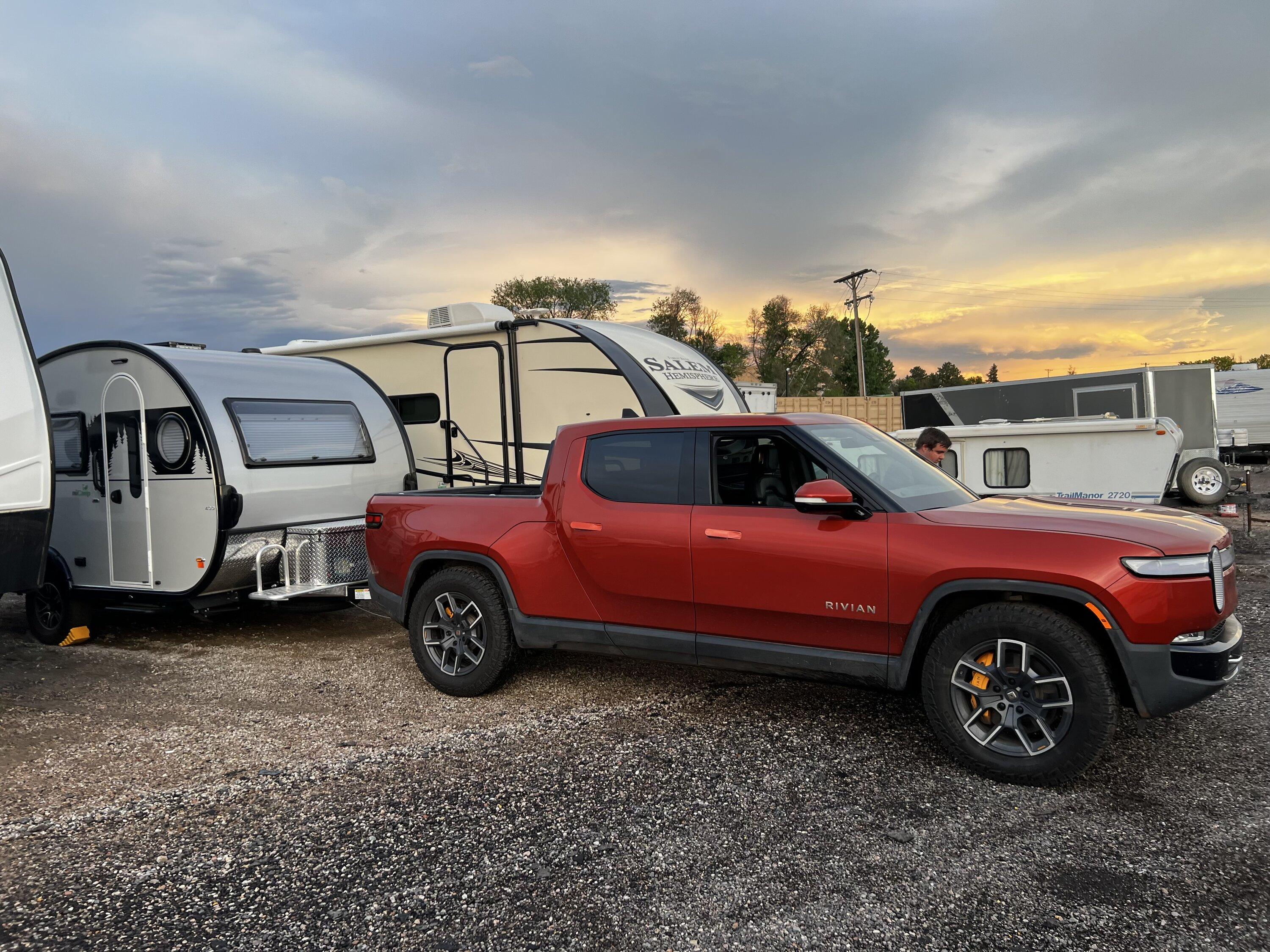

We did a range test tonight towing a Tab400 from nuCamp. I’ll put the video together and get results calculated over the next few days… Any guesses?
Of course posting might be difficult since we’ll be on a 3 day overlanding trip in Southern and central Colorado 🙂

My guess is 40% range reduction. Good luck and have fun!

Can't wait for the results to this! I very seriously considered a Tab 400 but ended up going with a slightly larger trailer (4200lbs, 19'). So your results should help inform what I should expect.
It's going to depend a lot on how fast you're going. If it's 55 or 60.. looks like you're on ATs so I'm going to guess you get about 58% or 167mi total. (100 miles even between charges if you're going 20-80%).

Just got done. The range test video will post tomorrow morning on this channel. It's a new channel so would really appreciate your feedback and a sub if you are interested. Both help me to get the word out and get better at this...

Spoiler alert: .96 to 1.02 mi/kWh.
