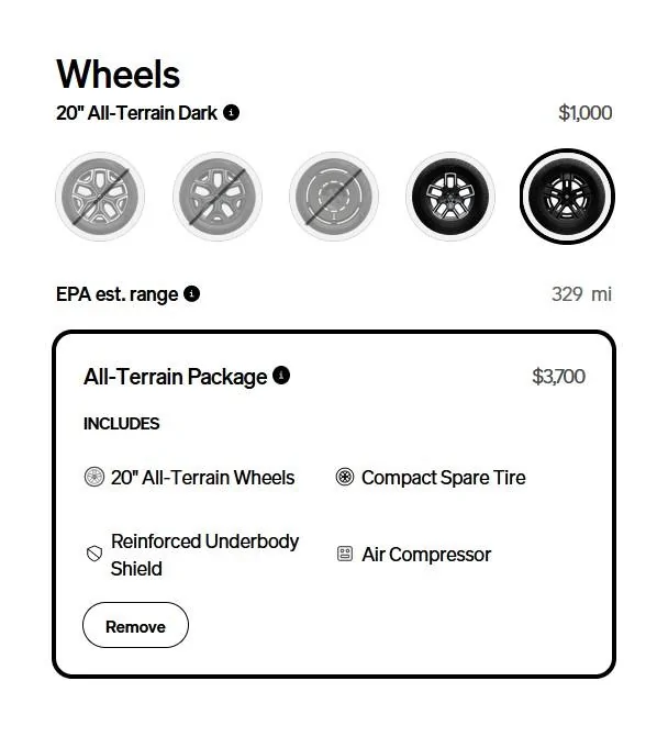

Since developing the OP I have been trying to definitively pin down the actual sizes of OEM Rivian all-terrain tires on 20-inch wheels in Gen 1 and 2 vehicles. I'm pretty sure that Gen 1 vehicles came with 34-inch (275/65R20) AT tires (e.g., as indicated here). That size was convenient for owners because of an adequate selection of aftermarket replacement (AT, AS, touring) tire models in that size that met Rivian Load Index requirements.
For Gen 2 Rivian has eliminated the 21-inch wheel option and has seemed to switch to 33-inch (275/60R20) AT tires, making all available OEM tires the same diameter (for both the remaining 20" and 22" wheels). This should be convenient because it seems to eliminate tThe need to reprogram speedometer software when switching among 33" and 34" OEM wheels/tires is still necessary. (Hint, hint Rivian: How about an onboard software option to switch among OEM wheel/tire sizes?) But it may prove less convenient if there are actually fewer aftermarket replacement tire brand-models with a safe Load Index of at least 116.
However and perhaps not surprisingly, there remains possible contradictory o
Online evidence:
  • Rivian's 20 in All-Terrain Wheel and Tire Set "Gear-Shop" webpage continues to indicate that the all-terrain tire is:
    • Pirelli Scorpion AT Plus,
    • 275/65R20, and
    • 34" in diameter.
      It may be that the Rivian website is simply out-of-date, or that the 34-inch wheel-tire set is intended as a replacement for Gen 1 vehicles or an optional accessory for Gen 2 vehicles.
  • Websites like Tire Rack and Simple Tire and Pirelli itself that indicate:
    • Pirelli tires in the 275/60R20 size appear to have a Load Index of just 115, which is supposedly slightly too low for Rivian Light Truck vehicles.
      I am unsure exactly which tire brand-model is intended for the Tri Max vehicles. The Goodyear Wrangler Territory AT 33-inch tires offered on the Dual Standard vehicles have a (just satisfactory) Load Index of 116. If 33-inch Pirelli Scorpion AT Plus tires are to be used, perhaps there is a special OEM version that meets the Rivian Load Index requirement?
But I spoke by phone to a representative at a Rivian service center (West Sacramento, California). They investigated and verbally reported that: Tri Max vehicles with the optional All-Terrain Package will come with 33-inch (275/60R20) all-terrain tires.
  • Dual Max vehicles with the AT Package will continue to be outfitted with 34-inch (275/65R20) AT tires. (If true, this is both pleasing and surprising to me.)
  • Why the difference? According to the service rep, possibly due to weight or power differences between the two versions (Dual & Tri)?
  • The Rivian SC would probably be amenable to swapping, say, 33s to 34s (e.g., after purchase). (And, I assume, reprogram the software accordingly.)
I remain cautious about this information. Based on my experience with Tesla, troops at the front lines may not be privy to the latest corporate-headquarters thinking. And as is true for most manufacturers, specifications and policies can change at any time and may even vary from SC to SC.
When it comes time for me to order a specific Rivian vehicle, I plan to work closely with Rivian representatives and to try and pin down (on paper if necessary) exactly what wheels and tires my truck can and will come with (or be switched to). I am hoping that for ~$100,000(!) there will be some reasonable wiggle room as to the choice of wheels and tires. I have learned (with the Tesla I have) that it is best (most convenient and least expensive) to try and get exactly the wheels and tires you want on a new vehicle right from the start.
