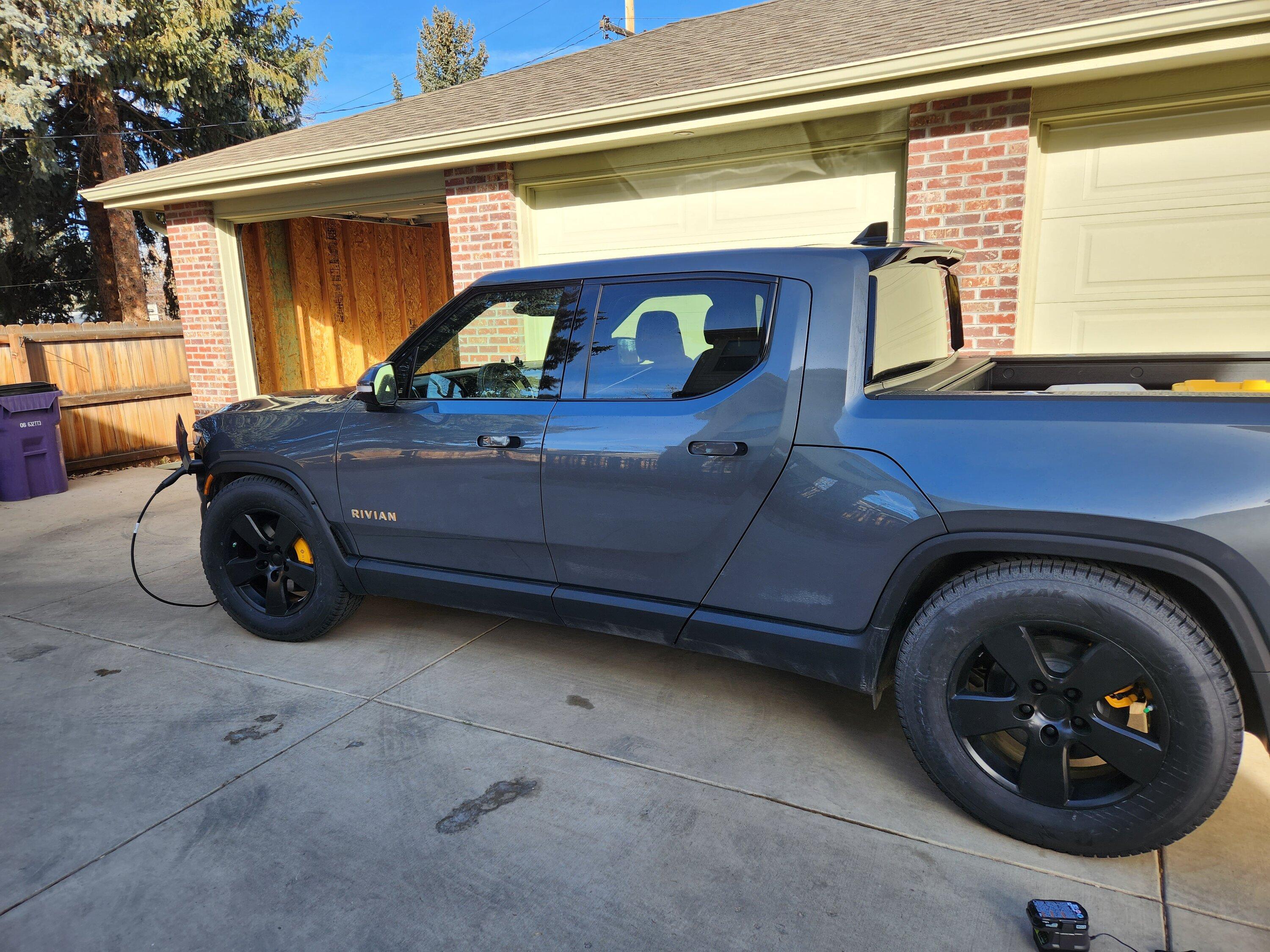

Pic of the ram wheels mounted to the car. A little bit of poke going on, but I like it.
What I didn't like is the impact to range. At least 10% impact vs the 21" I had (based on a 160 mile trip today). Totally expected of course
Any side view of these? Like to see how they look. Thanks!
