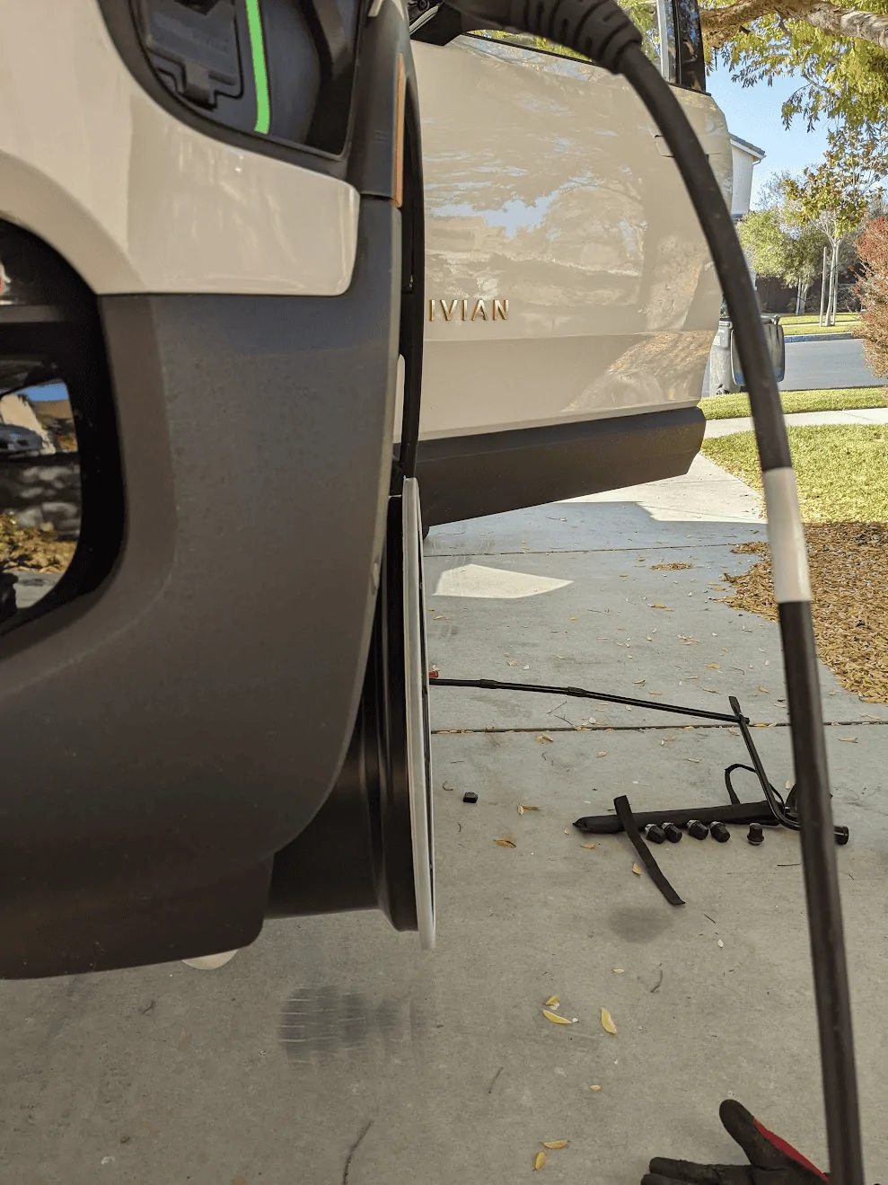

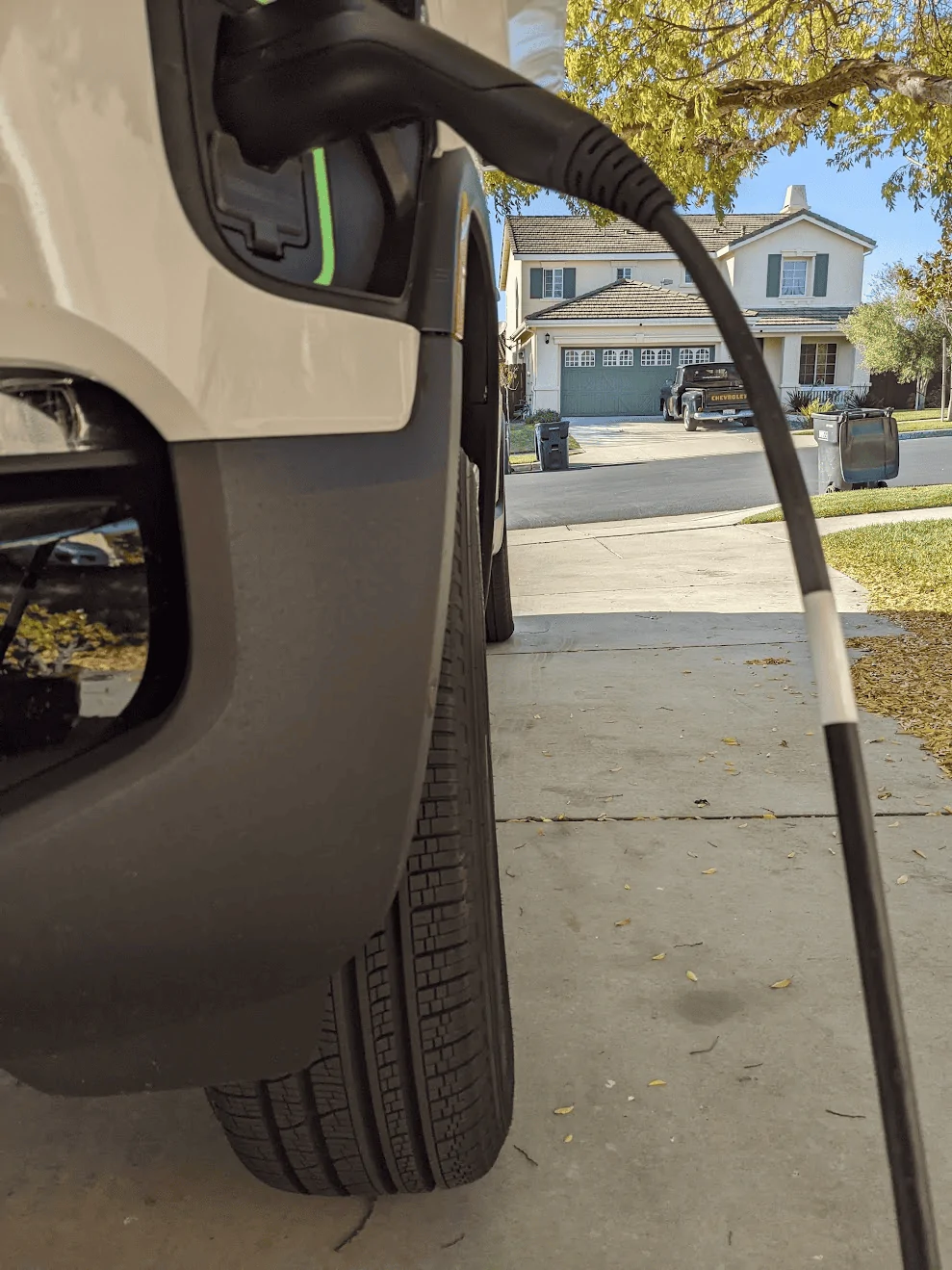

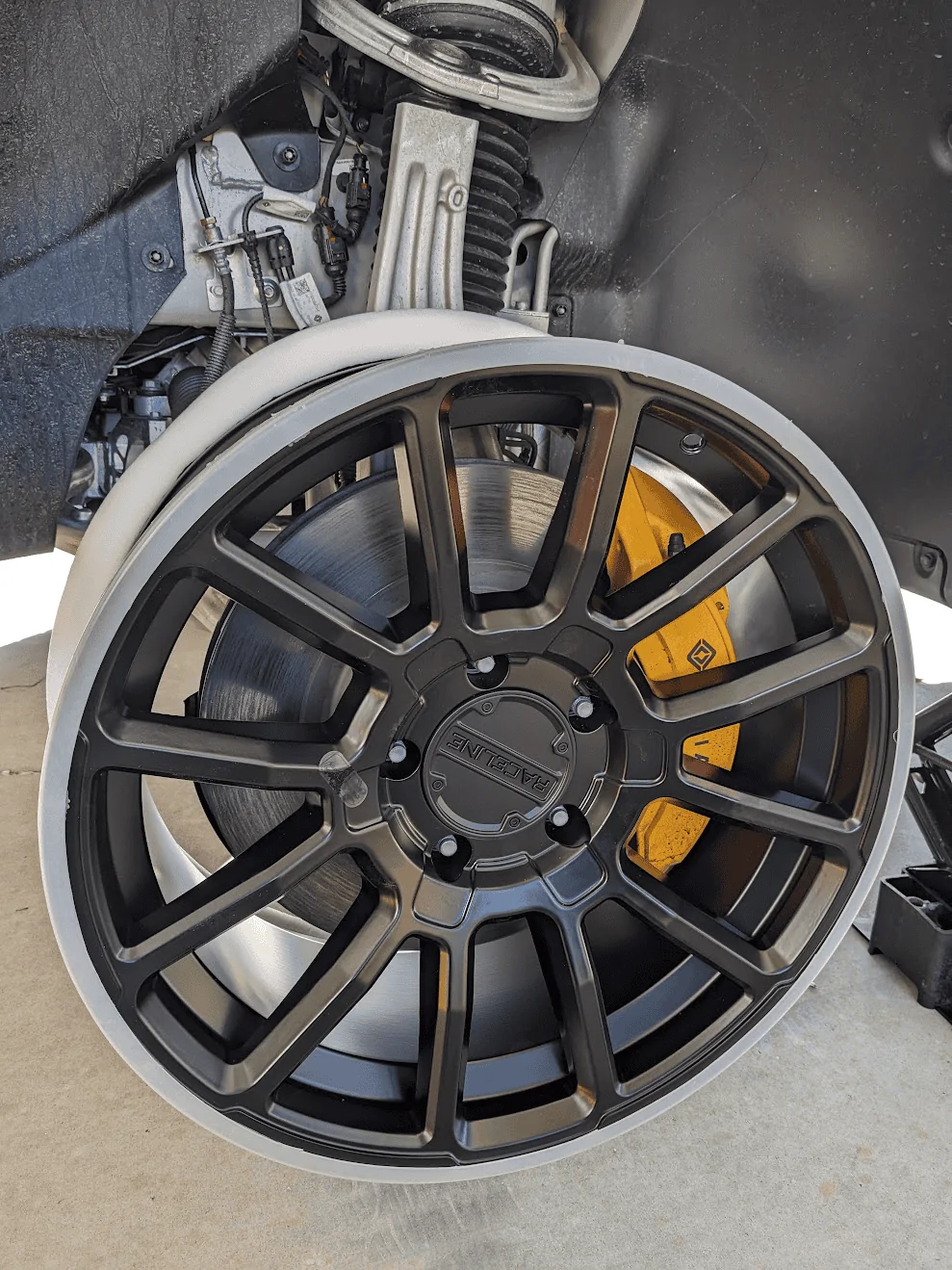

@iKnowKenMeadows So I just fit up a set of these today: 950B Gauge – Raceline Wheels PN 950B-29055+18 and can 100% confirm they fit with plenty of caliper clearance, and at $330/ea they're not a terrible price. I'm looking at oversize tires so can't comment on any tire fitment issues in the specific sizes you're looking at, but it's a start.
Rivian R1T R1S Random 20 Inch rims (cheap) for snow tires 1669767546897
OEM head on
Rivian R1T R1S Random 20 Inch rims (cheap) for snow tires 1669767731333
Racelines head on (~1/2 in farther outboard)
Rivian R1T R1S Random 20 Inch rims (cheap) for snow tires 1669767762559
Hope this helps, I'll update when some tires get thrown on there.

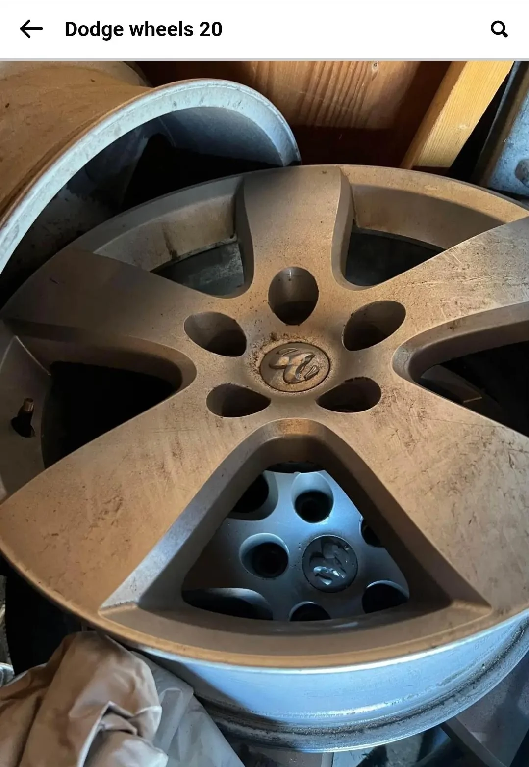

There are used/old ram 1500 wheels that fit. Offset +18. I was able to find a few through Facebook for <300 for 4. Will post pics when I get them.
You'll need hub centric rings as well. Just be very careful on getting the right wheels. Some are deceptively similar but won't work. Take note at shape of the spoke at the edge of the wheels. The pic belos shows how they're pretty square. There are near identical wheels that won't fit that are curves and roundish.
