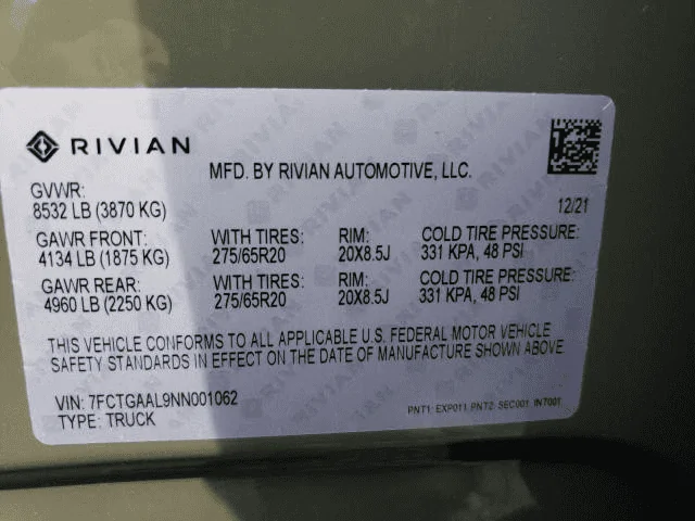

Unfortunately I don't think these will work either, seems their load capacity is 2200 pounds/wheel, which at first glance seems to check out. But then I read that a good rule of thumb is to take 50% of the heaviest axle rating of the vehicle, and _that_ should be the load capacity/wheel. So, the Rivian R1T has a GAWR rear axle capacity of 4960 pounds, so 4960/2 = 2480 pounds. The Raceline Scouts are rated for 2500 pounds / wheel so they should be good. However, the Black Rhinos are a bit under that at 2200 pounds / wheel, so I'm just not comfortable going that low.
sources: https://www.performanceplustire.com...d is determined,requirement would be 1500 lbs.
and: https://www.tsw.com/explore-tsw-custom-wheels/wheel-load-rating.php

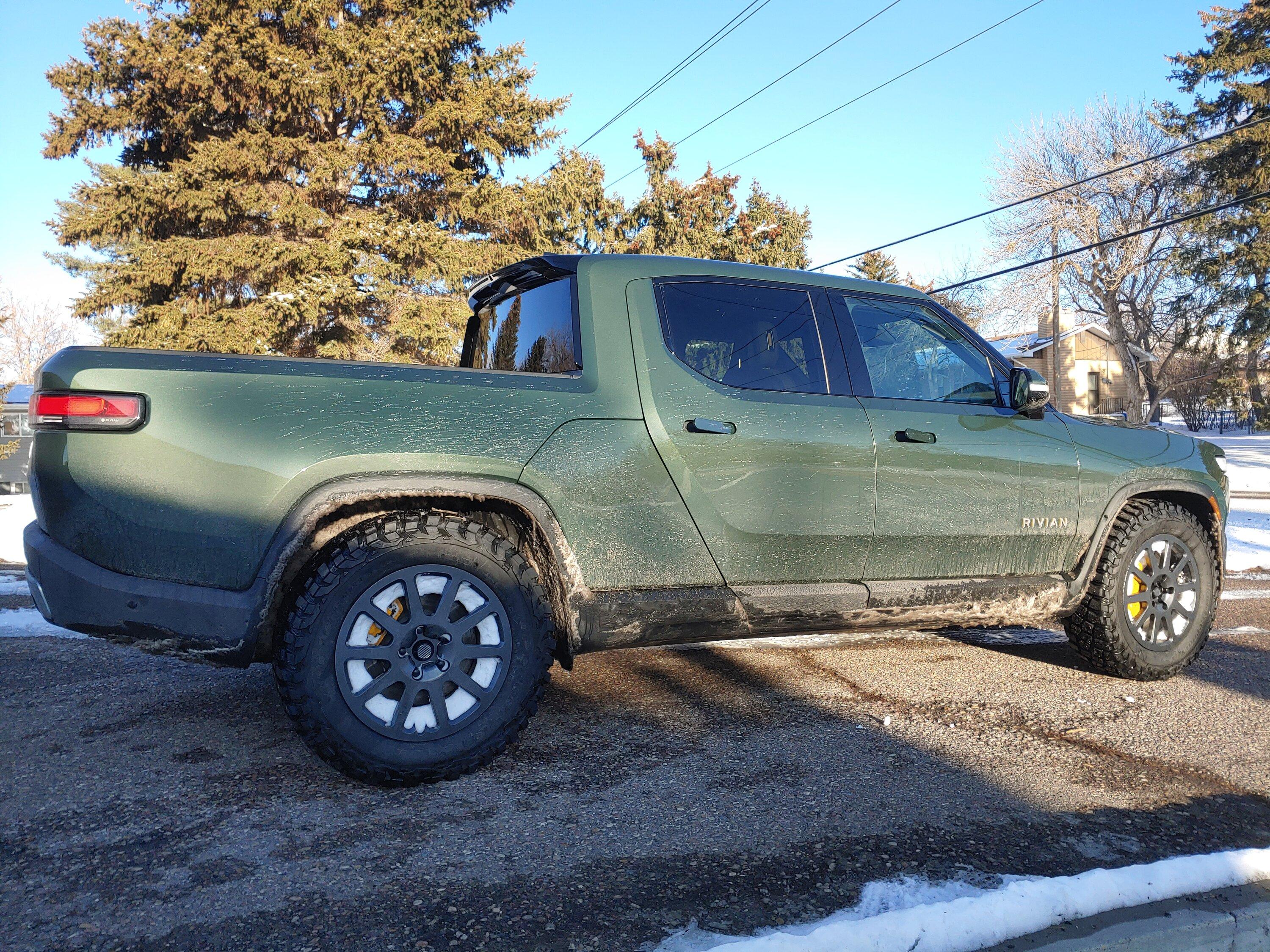

I got the Thuren Fab 20's!
