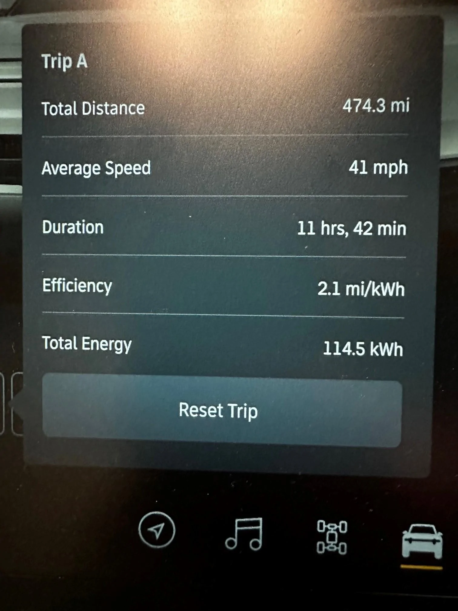

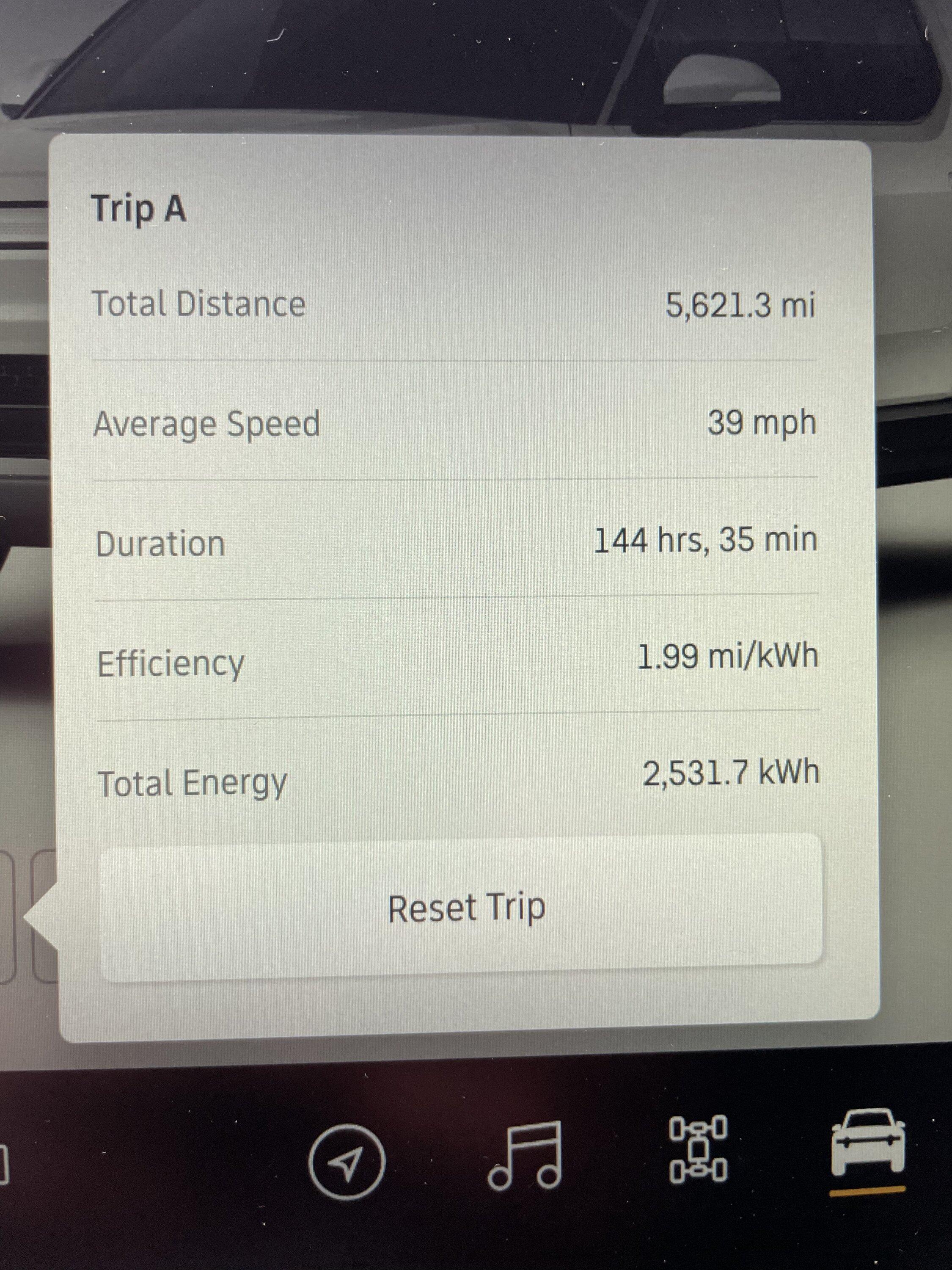

Any efficiency numbers you can share with that many miles on the setup?
Depending on the weather, I’m seeing very similar numbers to the trucks that are factory equipped with the Perelli scorpion tires. I was averaging around 2.3 mi./kW but now that winter has set in it has averaged down to 2.0 mi./kW This picture is my total average across 5600 miles with this set up.

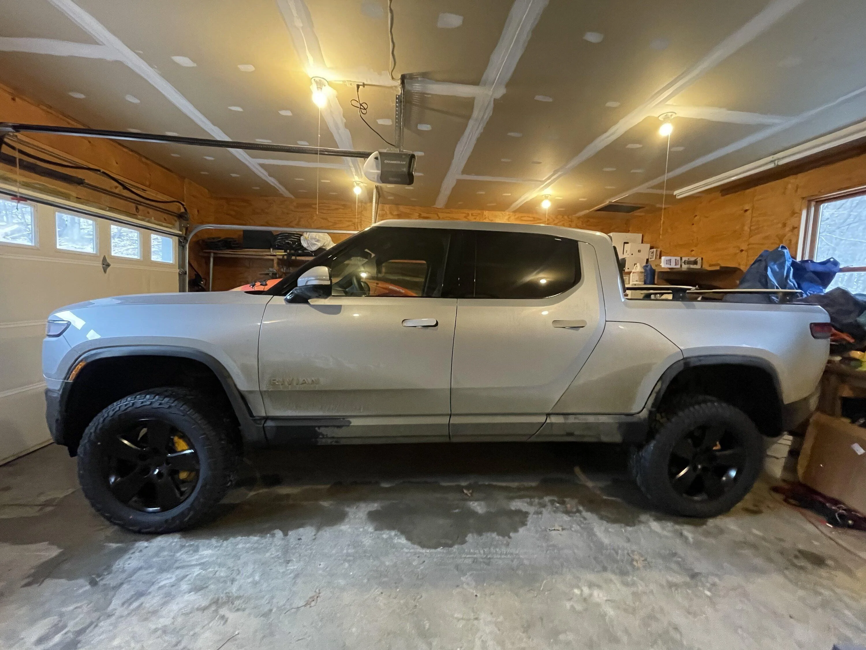

My dodge rims with Falken wildpeak A/TW3 tires were just delivered today. Excited to actually have some snow tires on this rig.
just got these on today and they look great. Very happy with this set up.

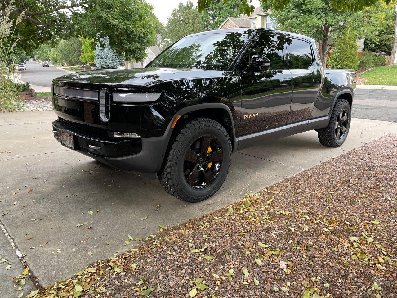

20" Dodge factory wheel with General AT studded tires and it goes in the SNOW and ICE like no other!
