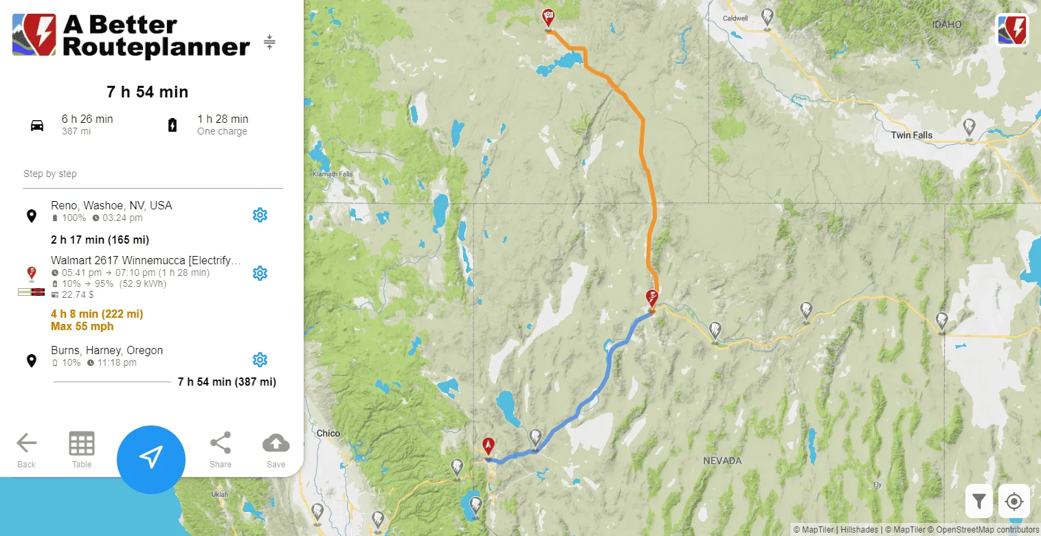

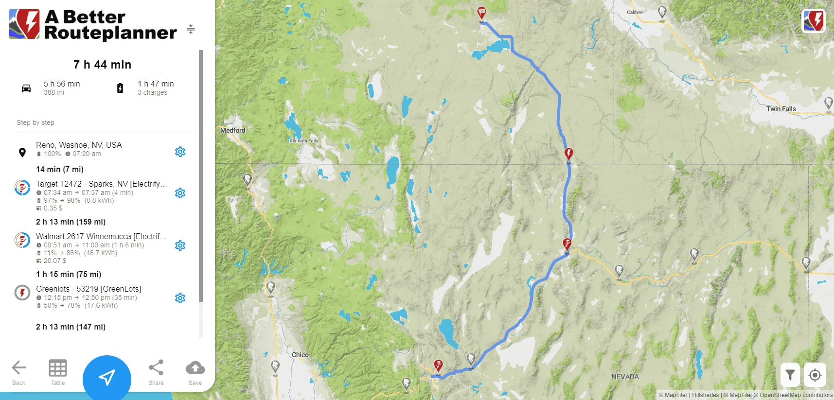

So I loaded this route into ABRP but used Rivian parameters rather than Bolt. The Bolt model is probably better than the Rivian model because there are real cars out there. ABRPs model represents guesses. It tells me that I will drive 2:18 to arrive at Winemucca with 39%, charge there for 13 minutes to 65%m drive another 3:24 to the destination arriving with 10% left in my battery. Some assumptions went into this:
a)400 Wh/mi consumption at 65 mph
b)Leave with 85% SoC on the battery
c)Drive at the speed limit
d)No wind.
e)I want to get there as quickly as possible under these constraints.
Now it is true that if someone in Reno says "Hey, I want you to take the R1T up to Burns tomorrow" and I say "How far is that" and he says about 400 miles I know immediately that I'm going to use about .4*400 =160 kWh and that with a 170 kWh battery I am going to need to charge once on the way. But when I put the trip into ABRP I know that I will be using a bit more than 400 Wh/mi because of terrain and or speeds above 65 mph and that, given the speed limits, it will take me about 5:44 of driving and 13 min of charging and that Winemucca is a good place to charge because it has big chargers. I also see right away that I have a choice of Roberto's only 801 ft. from the chargers, Dos Amigos 1127 feet away and 4 other choices. I also see right away that if I am feeling lucky and have a couple of hours to kill I can run up to the Say When Bar and Casino for a bit while I charge at the 40 kW station there.
I now know lots more about the road from Reno to Burns than I did 10 minutes ago. And I am guessing that all this information is accurate.
Now as for learning something about my vehicle and the trip let's play some games. If I have to charge 13 minutes leaving it with 85% on board could I not save some time if I left with 95%? Indeed I could. If I enter that into ABRP then I'd only have to charge 11 minutes. Suppose I decide to take advantage of that by driving faster say 110% of the speed limit then I'll use more energy (471 Wh/mi) and I'll have to charge 15 minutes but I'll be 5:15 on the road for a total of 5:30 for the trip as opposed to 5:51 at the slower speed and departure at 95%.
I've now got a pretty good picture of what the morrow will bring. Will I arrive at Winemucca after 2:18 with 39% on the battery? Very probably not. A head or tail wind will probably get me there earlier or later and the consumption will be more or less than 400 Wh/mi. But the number is going to be close to 39%. Will I leave with 65%? No, probably not. I'll dawdle over my MicyD's and/or decide to put in 70 or 75% for some margin at the destination. Will I arrive at the destination with 10% SoC? No, it will be more than that. Has ABRP been a big help to me in planning this trip? Yes. Could someone using ABRP learn something from an exercise like this one? We hope so.

So over to you. What's wrong with the picture below?
As for what's specifically wrong with that picture, I'd say pretty much everything. If I were "planning" that route for myself, first, I'd complain because nobody has chargers in Susanville or Alturas (Highway 395 is my preferred route as I'd typically be coming from west of Reno). Then I'd open PlugShare. Based on what I saw, I'd plan a trip in a 2020 Chevrolet Bolt EV accordingly:
  1. Leave Reno with a full battery.
  2. Arrive at Winnemucca Electrify America with 20% to 30% battery (possibly having to adjust along the way for conditions). That's what can be expected at baseline, freeway efficiency in average conditions.
  3. I'd charge up as long as the stop made sense. There's not much to do at that location (nor are there places I'd like to eat), so other than walking over to LUCID Cannabis and being disappointed it wasn't an EV showroom, I probably wouldn't want to spend more than 30 minutes charging.
  4. As a result, I'd expect to leave with between 60% and 70% battery, which is not enough to make the remaining 222 miles at posted speeds.
  5. I refuse to drive less than the posted speed unless it's an emergency or weather dictates, so I'd jam it up Highway 95 at 70+ mph, leaving me 70 miles short of making it to Burns.
  6. After about an hour, I'd stop a Quinn River Market in McDermitt, NV (with what I'd estimate to be about 30% battery) and charge up on one of the two Greenlots 50 kW BTC Power Slim units that ABRP never even presented to me as an option when attempting to use it to plan the route.
  7. I'd probably charge just a little bit extra in case, and after 30 to 40 minutes, I'd expect to leave with close to 80%.
  8. I'd drive the speed limit to Burns and arrive with 10% to 15% battery.
Mind you, my cheeky response took about five times longer to type out than this "plan" took to formulate. It's entirely possible that, while I was driving, I might decide to stop for a quick top up at Orovada along the way (another Greenlots charging site that ABRP didn't even bother mention as an option). Of course, it's also entirely possible that I really liked the LUCID store and decided to charge to near full while hanging out in Winnemucca, at which point, because I checked the route ahead of time, I'd still drive with the flow of traffic and stop at McDermitt (though I'd spend substantially less time charging).
So again, bringing it back to Rivian... The only thing that would change with this route plan is that I'd have an additional option for charging at a RAN station in Winnemucca. I don't know what amenities would be nearby, so I don't know how long I'd want to charge there. I also haven't seen data on how long the 180 kWh R1T takes to charge to full, but 80% still might not be enough for me to comfortably drive 220 miles at 70+ mph. Because RAN doesn't appear to have plans for Highway 95 north of Winnemucca, I'd hope that (unlike ABRP) Rivian includes those Greenlots chargers on their navigation and route planning.
And again, I can now illustrate my other issue with ABRP. I'd be new to the R1T (not experienced like I am with the Bolt EV), so I'd be relying on ABRP's baseline numbers to be somewhat accurate. A 15% margin of error could easily leave me stranded in the desert, and caveat emptor or "you should have slowed down" on one of the fastest driven highways in the country won't cut it.

Sure, maybe I stated that I wanted to arrive at ~10%, but how (exactly) do I leave Reno with 100% and somehow magically use exactly 90% to arrive at the specific charger I need when the next nearest charger is 50 miles away?
You don't. You told the program you want to arrive at chargers with a minimum of 10%. It will adjust the trip parameters to get you there with about 10%.
Did I just magically plug in a route where the first leg required exactly 90%? Something's wrong with ABRP's calculation.
No. That's just about how much energy it takes to cover that terrain at the speed limit given the estimated consumption of the car.

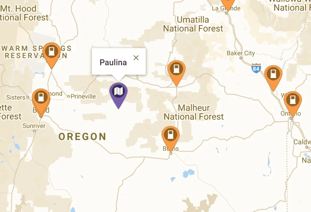

No, there's still a lot wrong with that picture, and I actually have no previous experience with that route at all. I only mentioned it because someone mentioned Burns, OR earlier in the thread, and Rivian appears to have no RAN support for Highway 95 north of Winnemucca. I've only taken the Highway 395 route to Burns years ago, which is still impassable in any EV without lengthy L2 AC stops. I do, however, have a lot of experience with the Bolt EV and the disconnect with ABRP's models, which is what I was demonstrating.
I do have to apologize to ABRP, though, because I apparently did have a filter in place (I haven't opened ABRP in over a year). As I recall, I set Electrify America preferred exclusively to illustrate how ABRP had been natively (no filters or preferences set) prioritizing 40 kW chargers over Electrify America chargers along the same route. That being said you also might have a filter set on PlugShare that you don't realize because both the McDermitt and Orovada charging sites appear on my PlugShare.
I unfiltered the charging providers, and ABRP kicked back this gem. Apparently, now, it requires 3% battery to drive 7 miles across town in order to charge from 97% to 98%. :rolleyes: Then, despite leaving with 2% additional battery capacity than I had under the previous plan, I still arrive in Winnemucca with 11% battery instead of the 10% from before. So ABRP's results aren't even consistent from route plan to route plan. :facepalm:
Yes, I had the minimum power slider too high. They now both appear in PlugShare and ABRP.

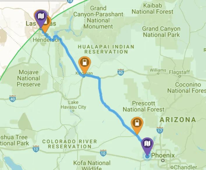

Living out west where chargers are few and far between, I like to use SRP, Simple Route Planner. Look at my route, in this example Phoenix to Las Vegas, and see what chargers are on the route (Plugshare works for that):
Rivian R1T R1S RAN Rivian Charging Stations Locations Map via Google Maps 1625254497071
Kingman is 168 miles, then 111 more to Vegas, so I will stop in Kingman and charge until I have 111 miles plus margin. Simple Route Planner using my gray matter.

ABRP is generating about 4080 plans per hour as I write this. How would you know what any of them are being used for or by whom?
...even small, aerodynamic EVs will see a 20% increase in consumption at freeway speeds. Large EVs see closer to 30%.
And we wonder where you got this idea from. I drive an X. It's a pretty hefty chunk of metal. Consumption goes up by less than 10% to 310 Wh/mi at 65 mph. ABRP in its conservatism defaults this car at 332, another 7%, which comes to 118% of the rated consumption. ABRP defaults the R1T max to 516 which is 121% of the presumed rated consumption. That's clearly a much more realistic estimate than
EV trucks are likely to be even worse, but the R1T is a relatively small truck, so 30% is probably a good initial estimate. As a result, I'd anticipate ~1.6 mi/kWh or 600 Wh/mi as a baseline freeway consumption for the R1T.
But you'd probably be way off. 516 is more realistic than 600 for sure. And it better be. 600 implies something like 700 at 75 (assuming drag is half the load at 65) which in turn implies a working range of a little under 200 miles at 75 mph cruise. There's going to be a lot of screaming from the west if it turns out to be that bad.
As a result, ABRP might very well be off in the wrong direction.
As an, I hope, decent analyst I recognize that the probability that it will be off in the optimistic direction but the evidence points the other way.
I seriously question its value here as a predictive tool for the R1T when data inputs are being chosen arbitrarily.
Well that's why we don't chose the constraints and consumption values or optimality criteria arbitrarily.
I can say with certainty based on years of experience with both EVs and trucks that the Highway 95 route north of Winnemucca should be worrisome for R1T owners, even with the 400+ mile range option.
A good analyst would know better than to say "with certainty" but it's pretty easy to debunk this statement without any trip planners.
1)R1T rated consumption is going to come in close to 445 Wh/mi. At that rate it would take 99 kWh to cover the 222 miles. The elevation difference isn't much so with conservative driving - and that's well below the posted speed limits on this road, one would use 58.1% of the battery leaving 41.9% margin.
2)Take off 20% for the end keep out zones and you still have 21.9% margin
3)Drive conservatively (i.e. at the speed limit) and charge conservatively (i.e. not above 80%) and you will arrive with 10% margin
4)Drive conservatively but take on extra charge and you will arrive with extra margin (above 10%).
5)Live dangerously. Drive at 110% of the speed limit. You'll have to charge to 88% (which isn't bad to do occasionally) and you will still get there with 10% margin.
6)Charge to say 85% and hit the road monitoring the consumption graph (I assume there will be one) watching the predicted arrival SoC. Modulate your driving speed to keep the arrival SoC where you want it to be. You are now doing ABRPs job - adjusting one of the independent variables to minimize time en route while not violating the restrictions.

This "town" is in the RAN hole in Oregon coverage as discussed above. John Day and Burns could both use inclusion in the RAN. There are relatively new ChargePoint 62.5 kW stations in both with mixed reliability ratings.
DucRider,
I love your travel story. Having more than a single DCFC station in both John Day and Burns would allow much more Adventure away from US 26 and US 20, rather than simply allowing us to drive through these areas. Per ChargePoint, ChargeHub, and ABRP, each city reportedly has one Level 3 CCS DCFC unit available, of either 50 or 62.5 kW. The John Day area, with its namesake Fossil Beds (Google that, folks) would be a nice way to show those old dinosaurs some respect that ICE-mobiles just can't offer. After all, those gas-powered beasts running up and down US 395 are burning up Dino's family and friends.
To complete the patchwork of multiple bay chargers necessary to traverse and really explore Eastern Oregon, Western Idaho, and Northwest Nevada, also putting stations in Jordan Valley and/or Rome, Oregon, would be a huge help. Both are on what's called the "ION Highway", the central stretch of US 95. "ION" stands for Idaho, Oregon, Nevada, although US 95 goes all the way from Mexico to Canada.
