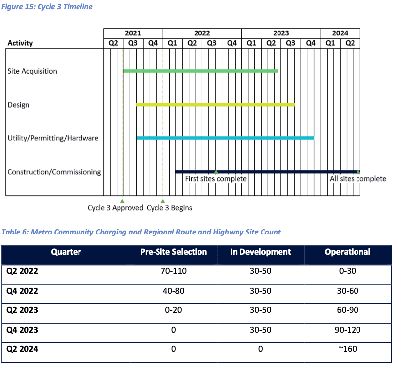

"Site selection" also requires finding a specific parking lot that makes sense for location and nearby amenities, evaluating the electrical service to the site, and getting a lease agreement or other type of contract with the owner, among other things. That can be a months-long process even when the site is planned for a smaller town with only a few viable properties to evaluate. And then once there's a contract in place with the owner, they still have to get through the permitting process and get the electrical service upgraded plus actually install the charging stations. Each one of those steps can take months.
For some perspective on all of this, Electrify America is currently developing its "Cycle 3" investment push. They're waiting for final approval of the plan from California and the US governments, which is required as part of the VW settlement that created EA. Cycle 3 will include $228 million in investment for the US outside of California -- they have separate Cycle 3 plans for California and not-California. Cycle 3 will get them to approximately 1,000 total locations nationwide. That's about 200 more than their plans at the end of Cycle 2. (600 total through Cycle 1, 800 total through Cycle 2, 1,000 total through Cycle 3)
Here's their timeline for Cycle 3. Note the lags between the start of each activity. They're figuring a minimum of 2 months for "site acquisition" before they can even start on design and permitting. And another 6 months minimum before they start construction. So 8 months minimum to acquire a site and move the first bit of dirt. On the outside, they're saying they will complete the last site acquisitions before Q3 of 2023 but won't finish the final construction tasks for another year afterward.

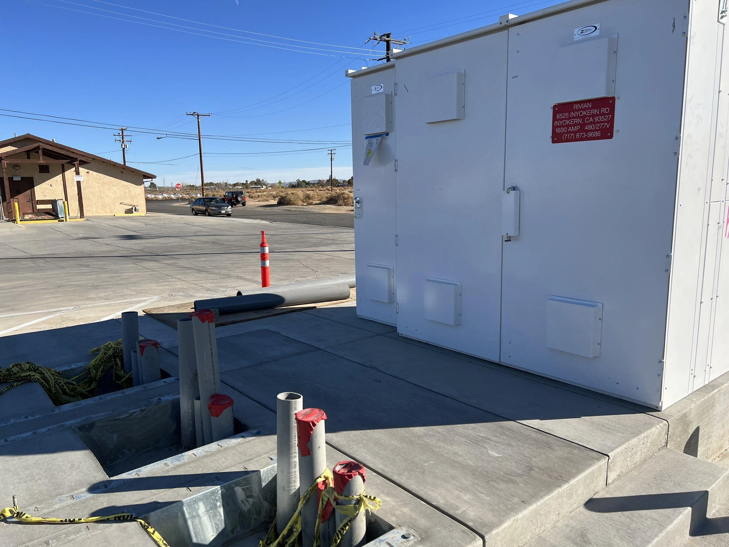

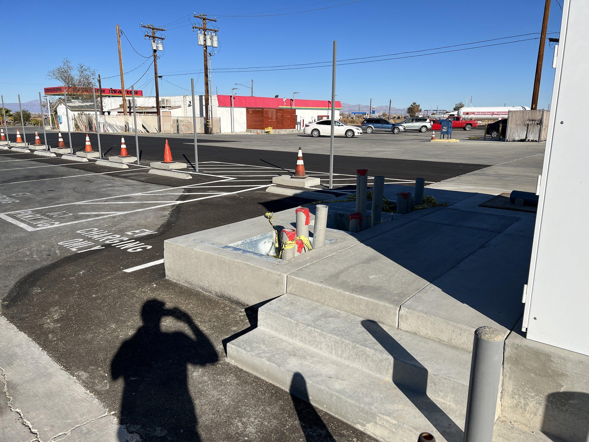

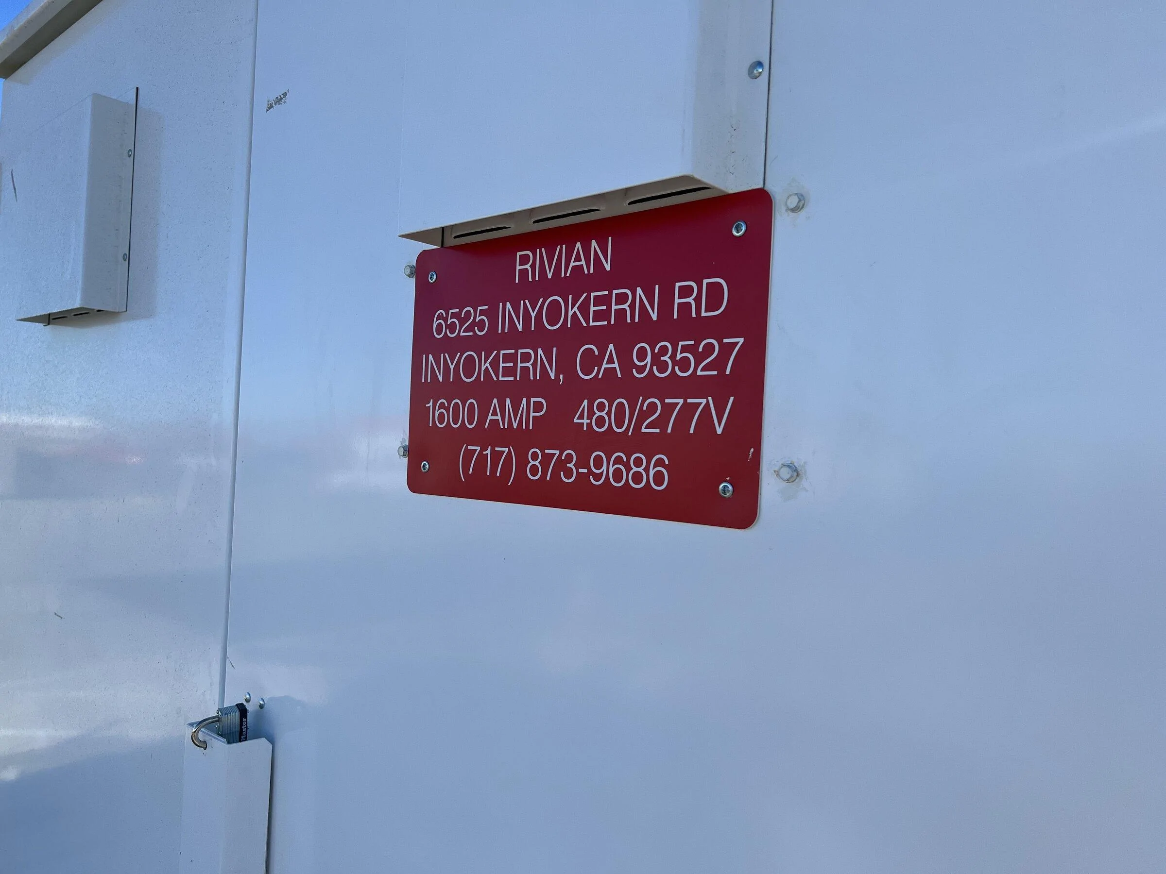

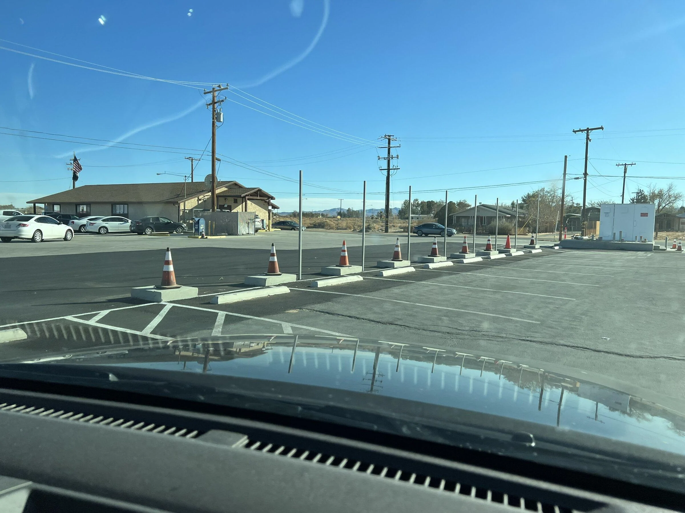

Not much happening at Inyokern charger on Friday.
Looks like all the hard work is out of the way though, should be easy enough to drop the chargers in and you're done.
Also nice that it looks like it will be set up well for towing, you could pull up horizontally on the backside and use one of the chargers without blocking any of the perpendicular spaces on the other side.
