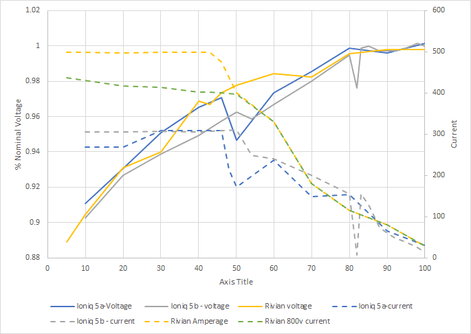

Great question. I'm going to caveat this statement that this is based on consumer level digging into charging strategies for similar batteries. tl;dr they can't do a lot without risking damage to the batteries.
The charging curve Rivian has enabled is broken into two phases, a constant current phase (governed by the 500A CCS limit), followed by a constant voltage phase. They're following the constant current phase up until the point where the battery pack voltage is close to the nominal voltage, or seemingly commonly around 50% SOC. The idea here is to prevent accidentally overcharging (and inducing overvoltage) the batteries.
So they're switching from a constant current to a constant voltage framework at about 50% to protect the battery. I don't think there's a ton they can do without exposing the batteries to risk other than potentially smoothing out the ramp for current.
I've plotted the charging data from three real charging sessions with amperage and voltage tracked. Two of them are Ioniq 5 curves, one is the 500A 450v curve, and another is sort of a theoretical 800v Rivian curve to see the potential impacts/differences.
I've included two ioniq5 curves because they have a couple of charging pauses slowdowns, which I think is handy to show that as you crank a lot of amperage into the pack, that amperage spikes the voltage as well. So if you look at Ioniq 5a plot at 50% you see the current drop, which caused the voltage to drop from 97% nominal to 95% nominal (728 down to 710v). You can see a similar drop at about 82% for the other Ioniq 5 curve. I provided that to show why they have the constant voltage phase and how increasing/reducing current impacts the voltage, and how reducing current helps maintain a constant voltage during the constant voltage phase of charging.
The left y-axis is % of the nominal voltage of the packs at 100%, the right y-axis is the current from the tests. You can see that the voltage increase as a percentage is fairly similar between packs, but you can also see how the Rivian seems to have more current induced voltage in the 45-70% range than the Ioniq pack.
For shits and giggles I also pretended that I know what an 800v Rivian pack may behave like with a 350kw limit. With that I plotted up what the current would look like, and then assumed above 50% it would follow closely to the current CV phase.
Rivian R1T R1S RAN charging curve? 1664567889920
That theoretical charging curve would look like this:
Rivian R1T R1S RAN charging curve? 1664568363669
The 800v curve is obviously just educated guessing, and heat in the battery pack would still be a big issue and probably control a lot of the real world behavior. Practically speaking the nice thing (in my mind) is that the 800v system would allow you to pull 280kw with an amperage that most of the existing fast chargers seem to be able to reliably maintain.

Many thanks for this. The Ioniq has much
More area under the curve between 50 and 80%, would be good if Rivian can close that gap a little.

The Ioniq has much
I think you're referring to area under the curve on the last plot I made. I *think* the only reason they have that is because of the voltage difference basically. I could be wrong, but I don't think Rivian has much room to increase charging in that range with the current voltage of the pack. If they can, I suspect it will be very dependent on collecting a large amount of data.

For the area under the curve from 60-80% other companies like Ford seem to have higher charging across that range and they are 400V architecture. So that is what led me to think Rivian may be conservative as they collect data. The new BMW iX seems to have a high rate of charge up until 95%.
Overall they're very similar. Where Rivian can probably improve is smoothing the curve out. They basically make bigger drops than I'd like starting at 70% and then end up following a very similar backbone curve. That being said, I'll take that any day over Ford's curve. I plotted them up for you for comparison. The 500A and 450A curves are Kyle's two test curves he published. You'll likely notice, the slope of the curve is similar.
