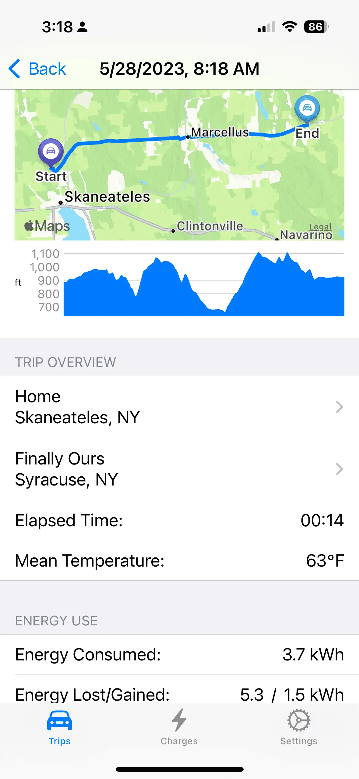

Sadly, a royal PITA. I ran video of the center screen and extracted data points where they were of interest...15s interval where interesting and 1 min otherwise. With the CANServer device becoming available, it might be possible to automatically grab these data in the near future. But you'd still aggregate those data in Excel, Open/Libre Office Calc, or Google Sheets anyway.
I have iPhone software written for my Mach-E to record trips and charges if there comes a way to pull it from my R1S. On the Mach-E I use a Bluetooth scan tool to grab all sorts of good driving and charging data that Ford exposes and would love to add Rivian support now that I have both vehicles.
Sample of a recorded trip from the Mach-E (more trip and battery data if you were to scroll up):
