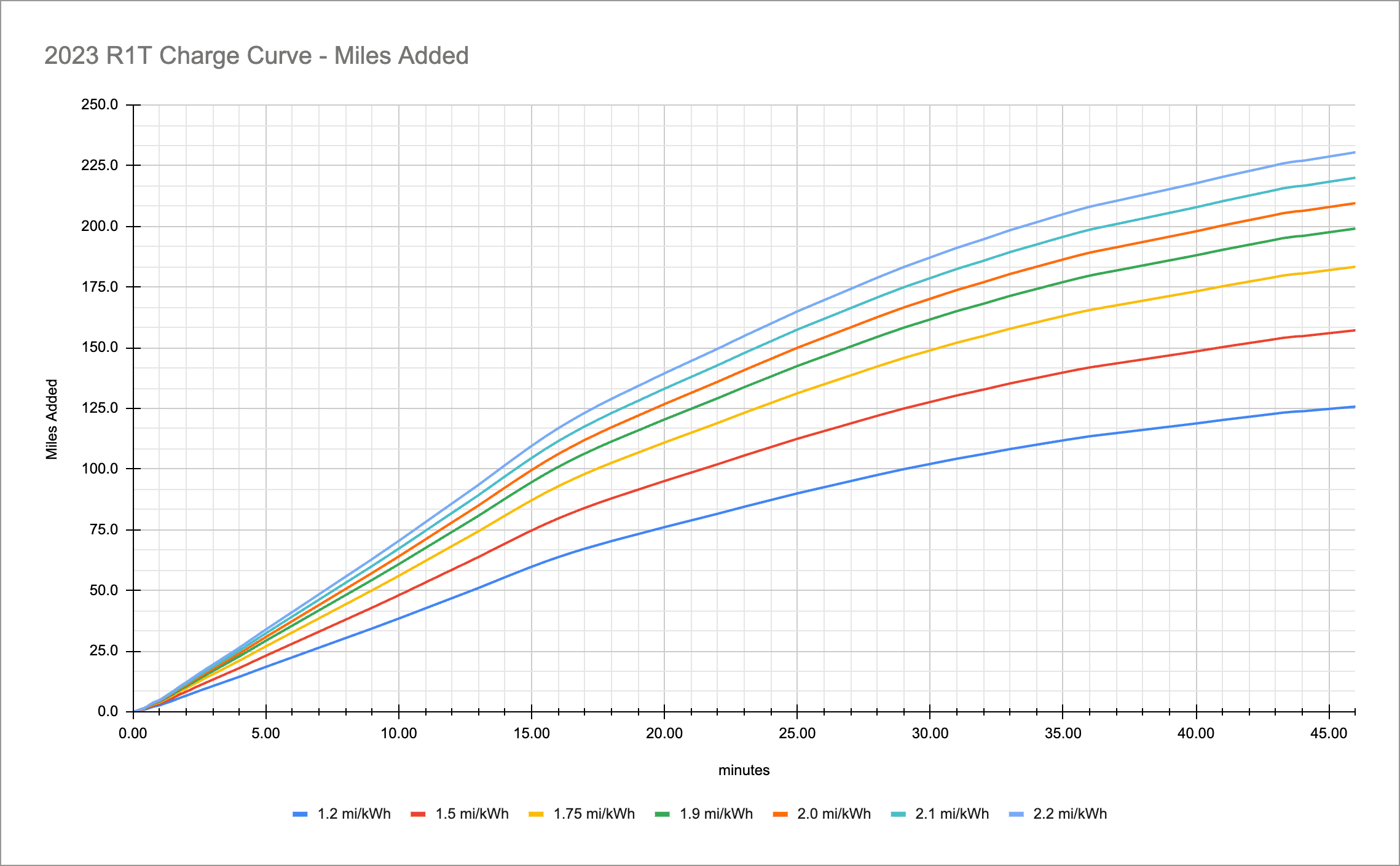

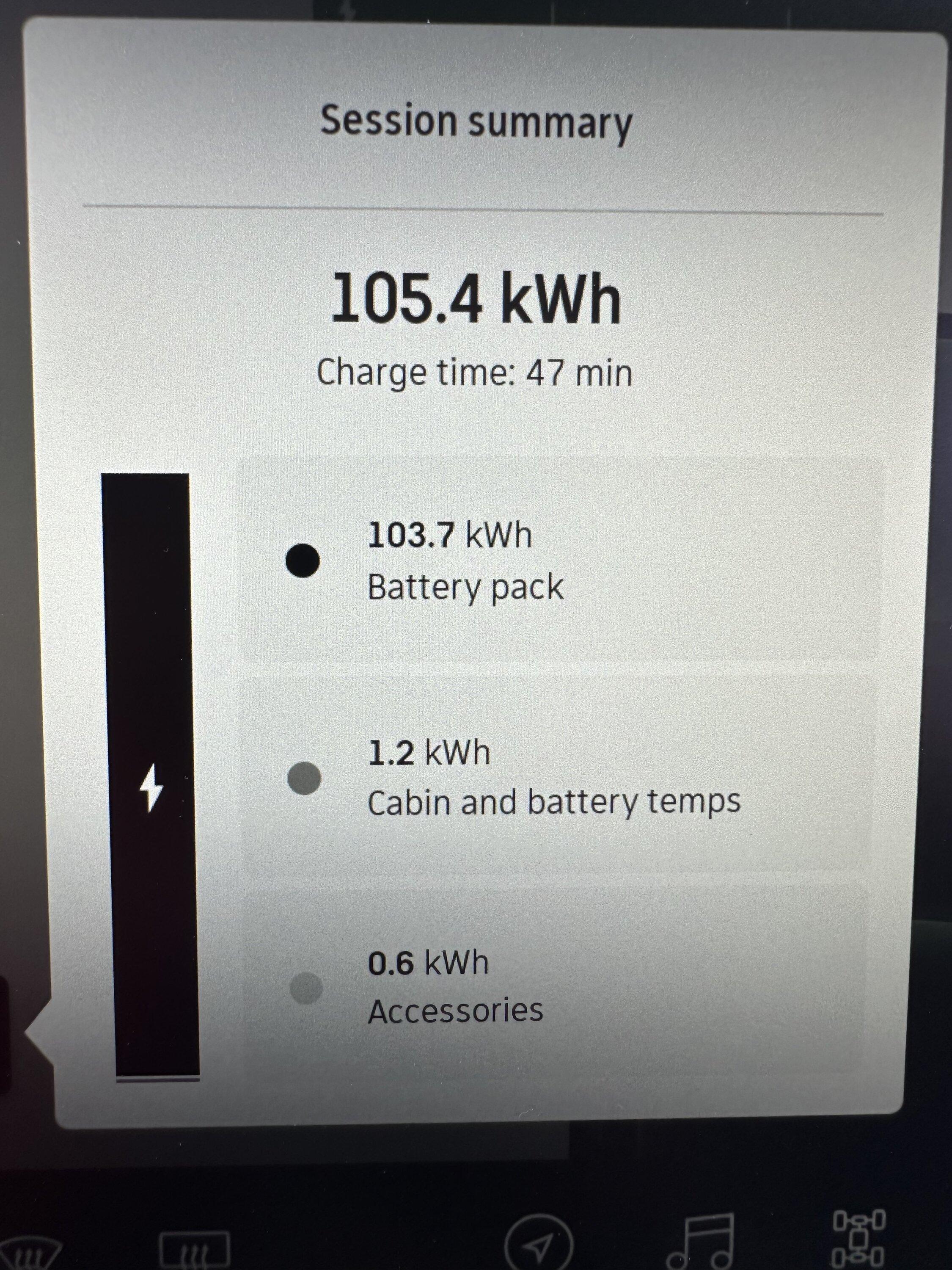

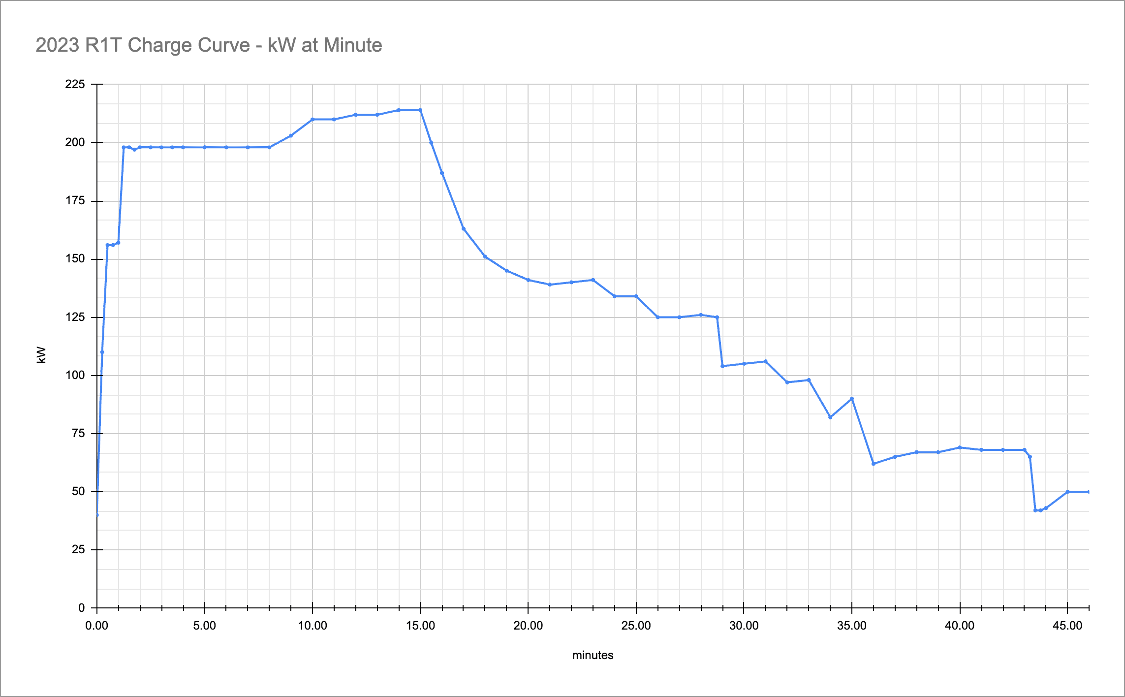

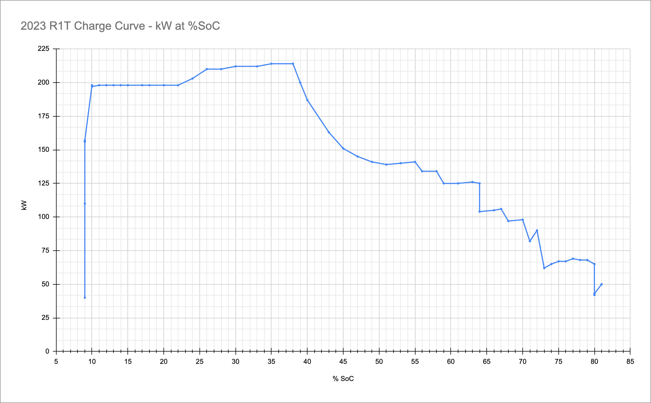

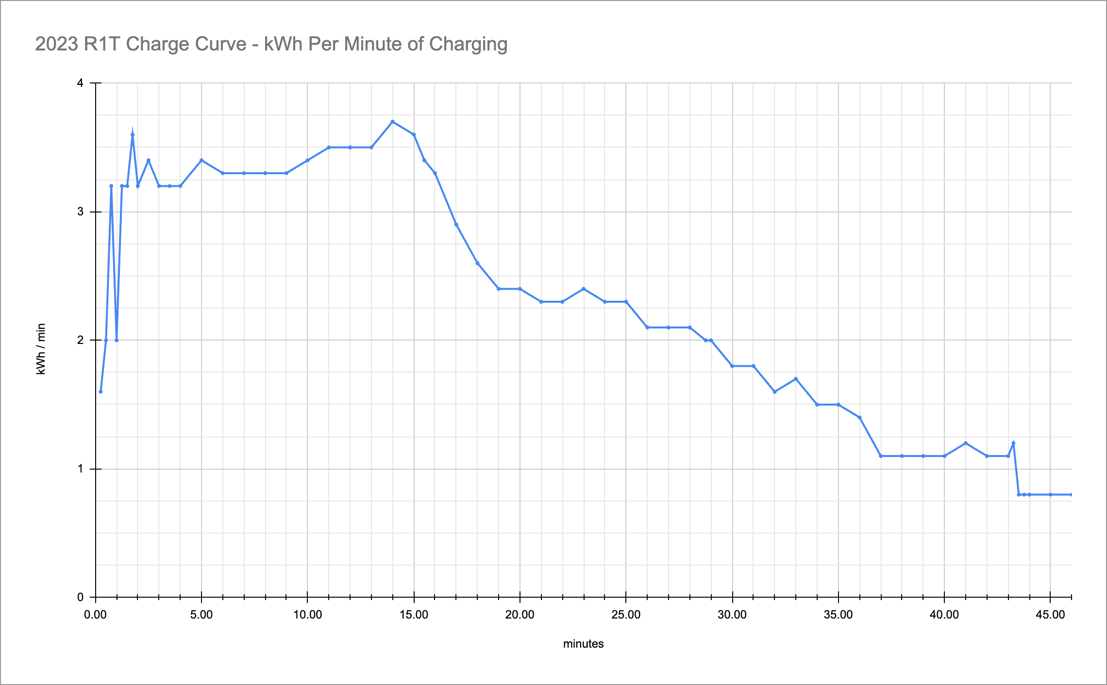

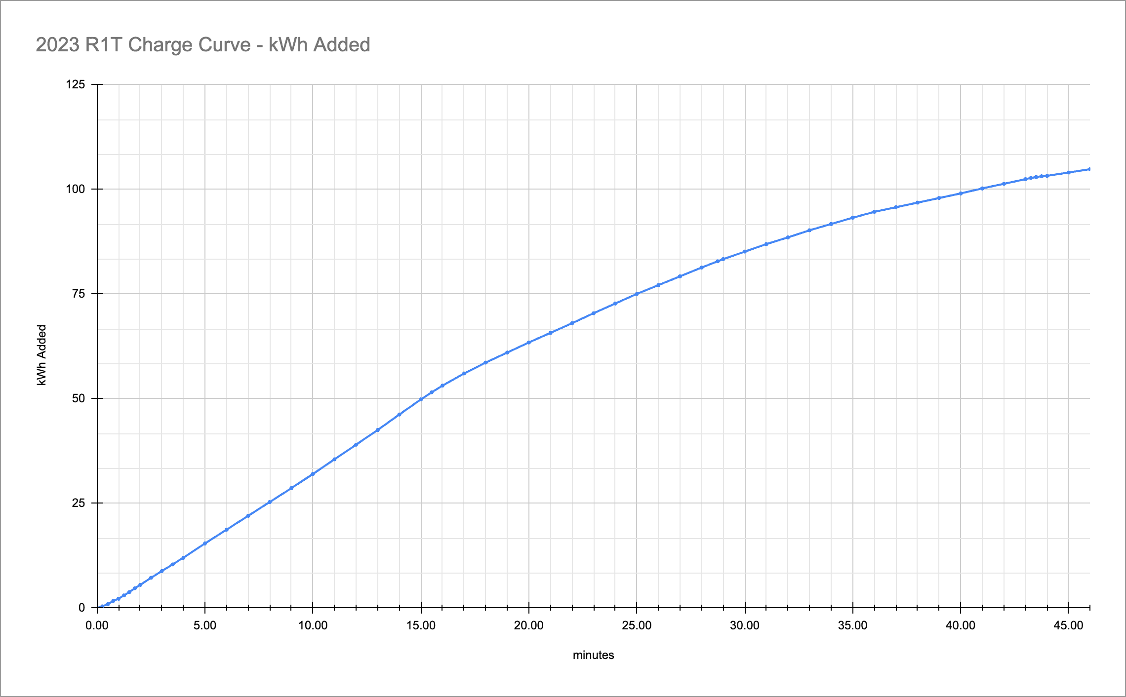

Finally had the opportunity to try out a RAN site with the opening of the Broomfield, CO location. I spent most of the week running the truck down to 9% by the time I reached the station. Truck preconditioned the battery for about 20 min while enroute, so the battery may have still been a little cool from sitting overnight. I'm on the latest, 2023.14.0 as well.
TL;DR, color me impressed. I saw 50 kWh added in the first 15 minutes and holding nearly 200 kW that whole time.
The linked spreadsheet includes a ton of information at high temporal resolution as well as a bunch of charts in the tabs. I've included the charts here as well, but the last one may interest folks as it shows (for this session) how many miles you could expect to add for various efficiencies from 1.2 mi/kWh to 2.2 mi/kWh. Another chart of note is kWh added per minute rather than kW, with the max around 3.5 kWh per minute.

That's better than my second experience with a RAN (Benton Harbor Michigan) - I was all over the place between 120kw and 215kw. For the first 25 minutes. I think I rolled in "too low" (3%) and the battery got overheated in the first 10 or so minutes. Or it wasn't well balanced because the truck turned off preconditioning at such a low SoC? Anyway, most of my experience with big charging rates has been arrival around 10-18%, in which case it will ride 200+kw for at least 12 minutes or until ~45%
Also, big thanks for providing all the different X axis options. I find that by time is a far more useful metric.
