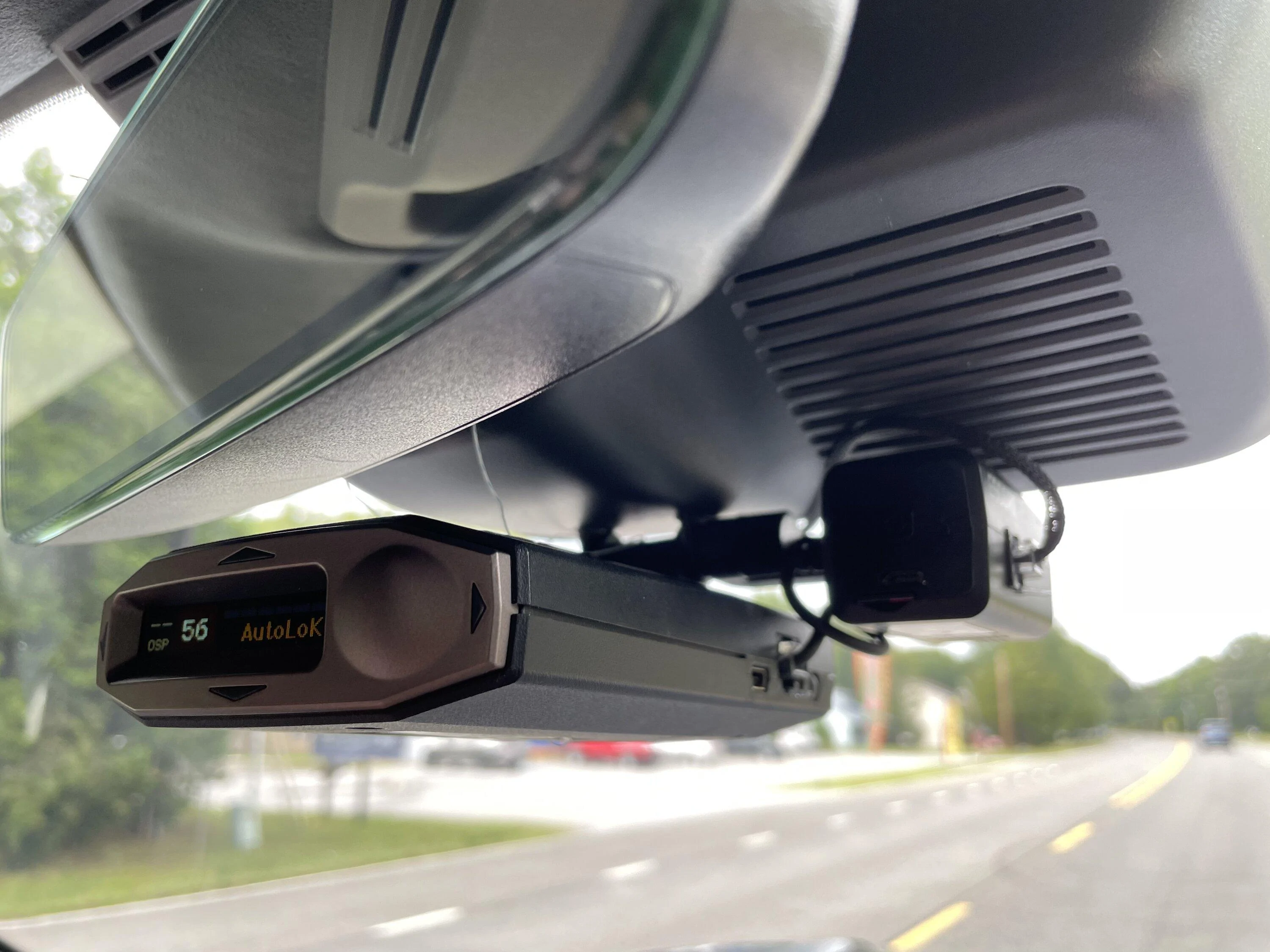

Mine works but I haven’t checked to see if it actually powers down that circuit. I have my detector set to power down if not in motion. I’ll check to see if the M1 DashCam shuts down next time I get a chance.
I also ditched the suction cup mount after it failed(first time that has happened to me with this style). I took a dremel to the mount. I cut a couple of slots in the plastic shroud and was able to pass the mount through the slots. The end result looks great. My only issue that I need to fix is that I now have a rattle coming from inside the shroud.
What mount did you use for this? Any more photos of the install, this is exactly what I'm looking for

Unfortunately I don't have pics. After my suction cup mount failed several times I took a dremel to it. I basically cut the mount down to as small as possible. I then cut two small slots in the plastic cover and passed the mount through the cover.

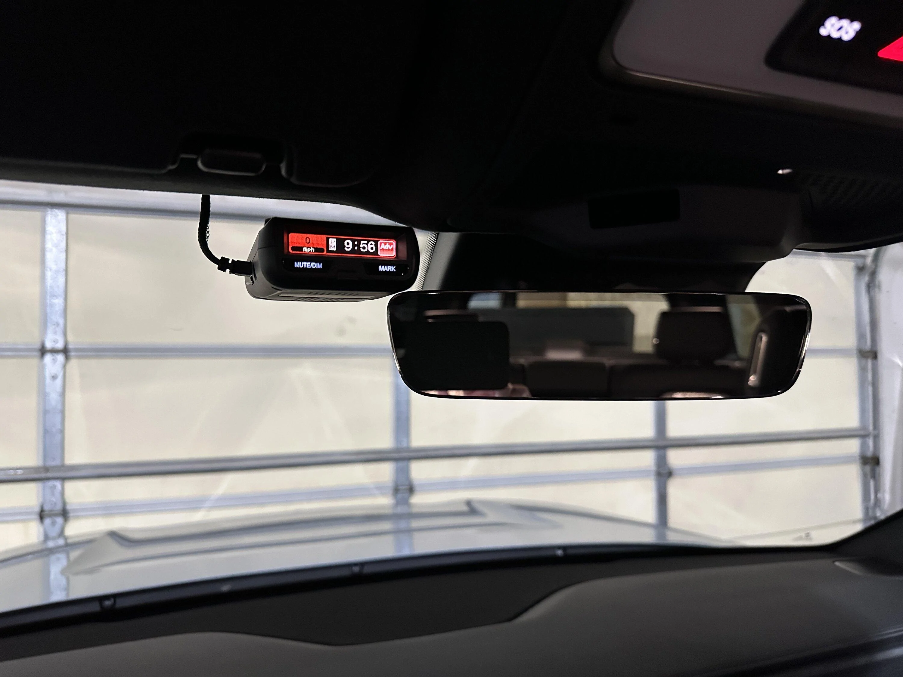

Just finished my install using the wire tap and the mount that uses 3M tape. Worked in my S6 so it should work here.

Mine is not powering off. I waited 20 minutes and approached without my phone or key. Gear guard is on but only records when away from home. I’ll try toggling it off and then on and see what happens.

This morning it was finally off. I'll have to check it at work tomorrow, unplugged and with gear guard on. I'll report back.

Tested it again tonight and it finally turned off after over 2 hours. Possibly it has to go into sleep mode before the 12v accessory power turns off?
is it easy to open up the cover on the R1s?
It took just a little more force than what I was comfortable with.
