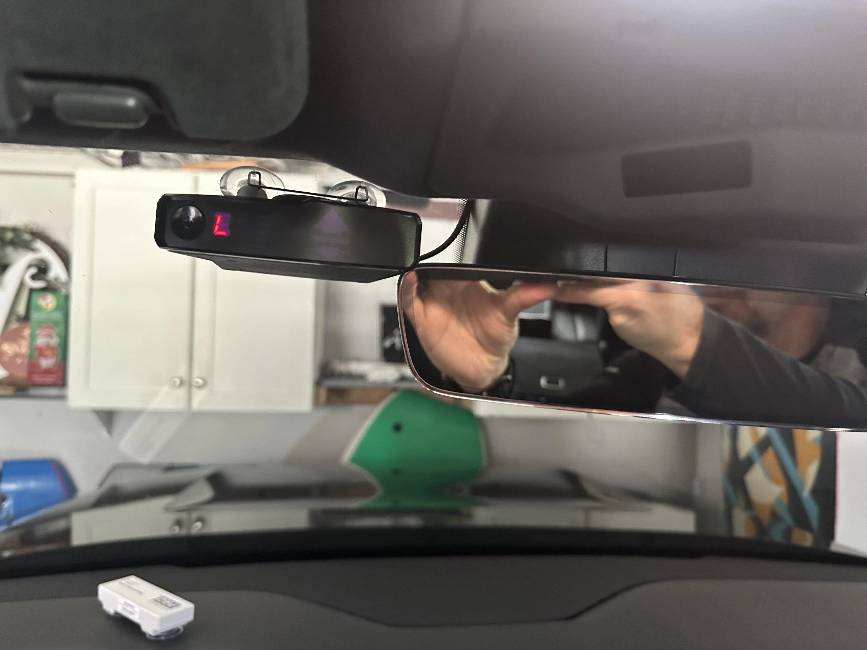

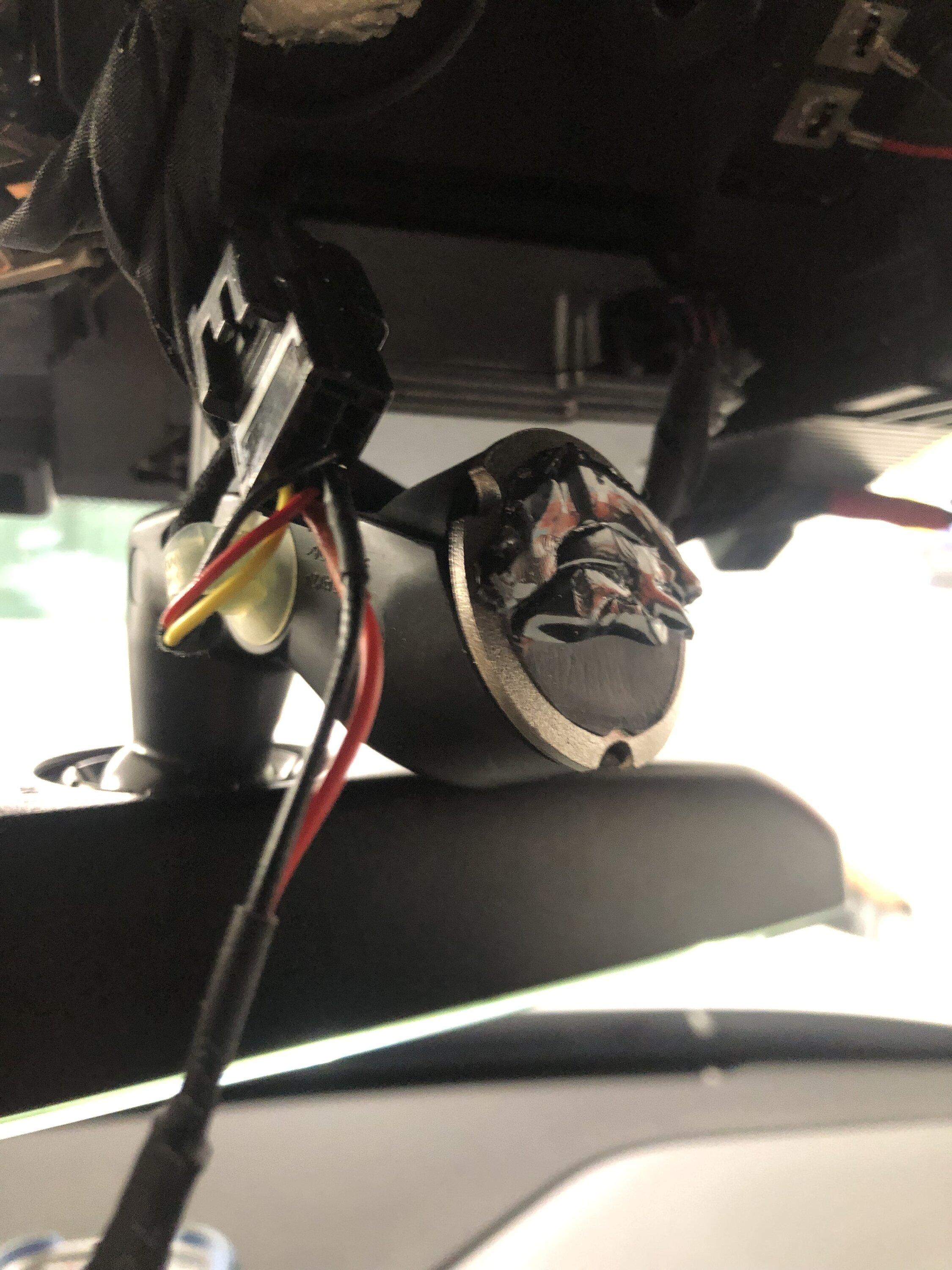

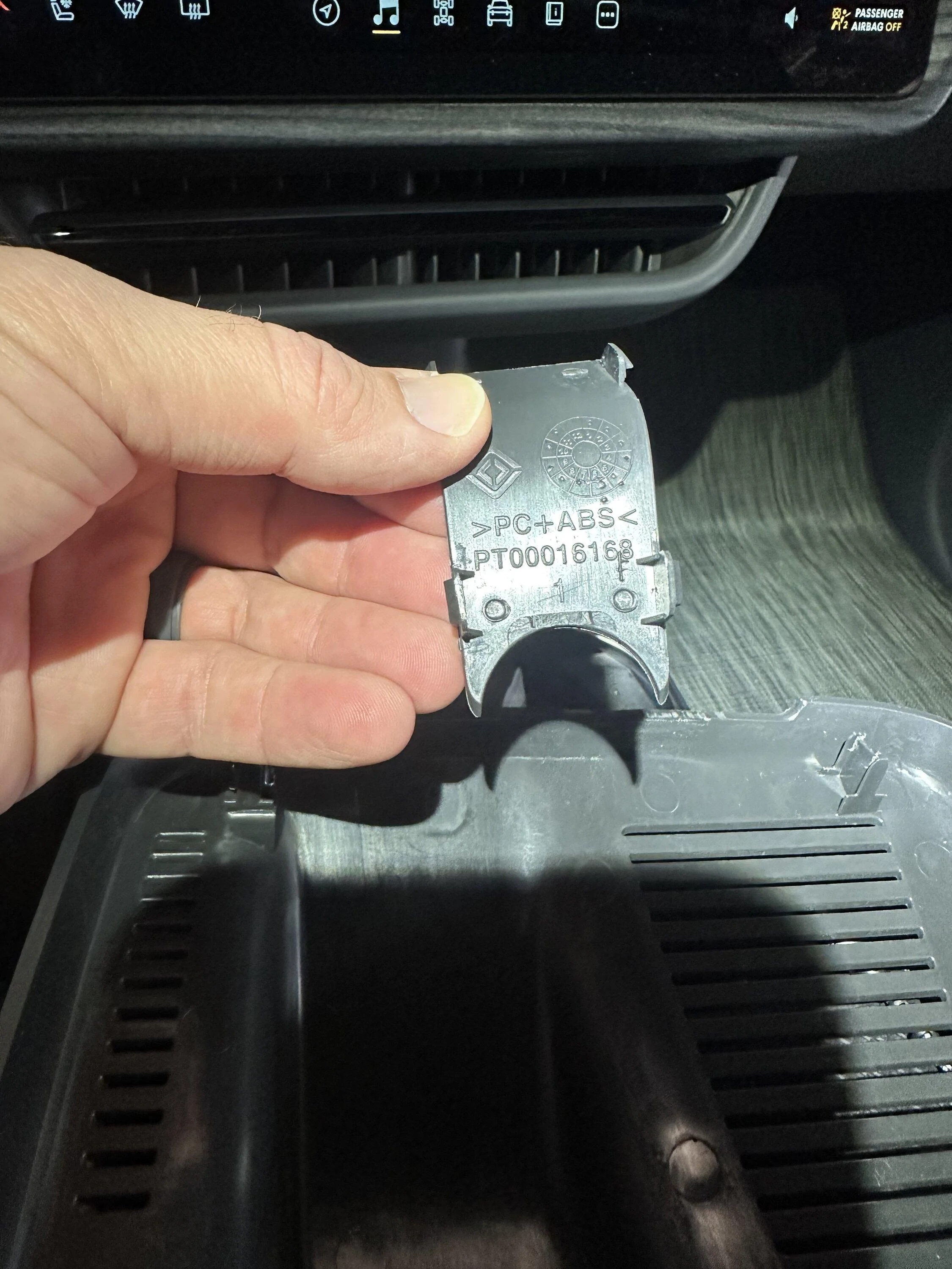

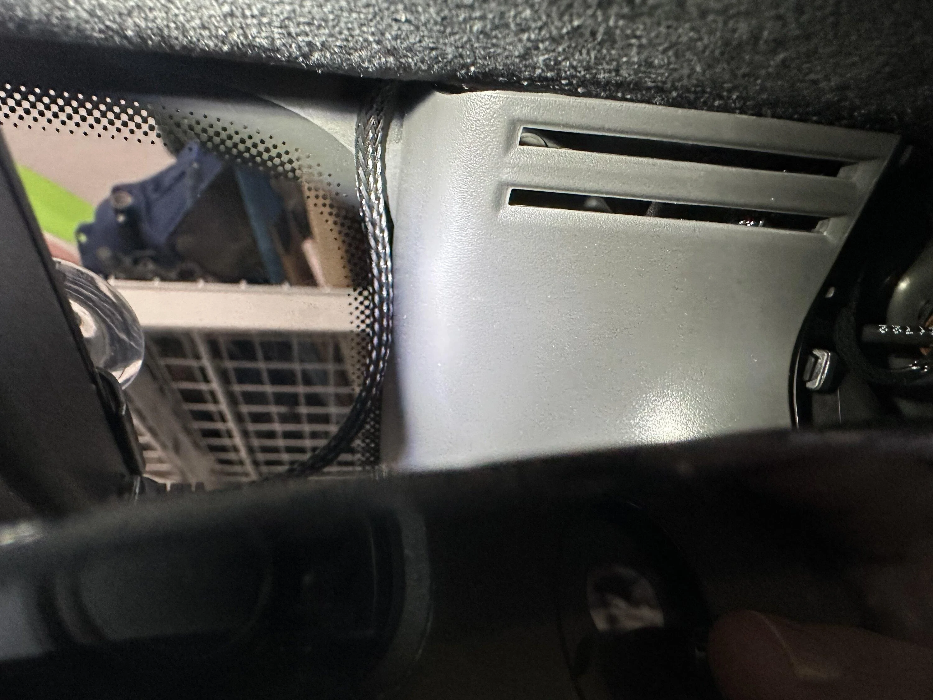

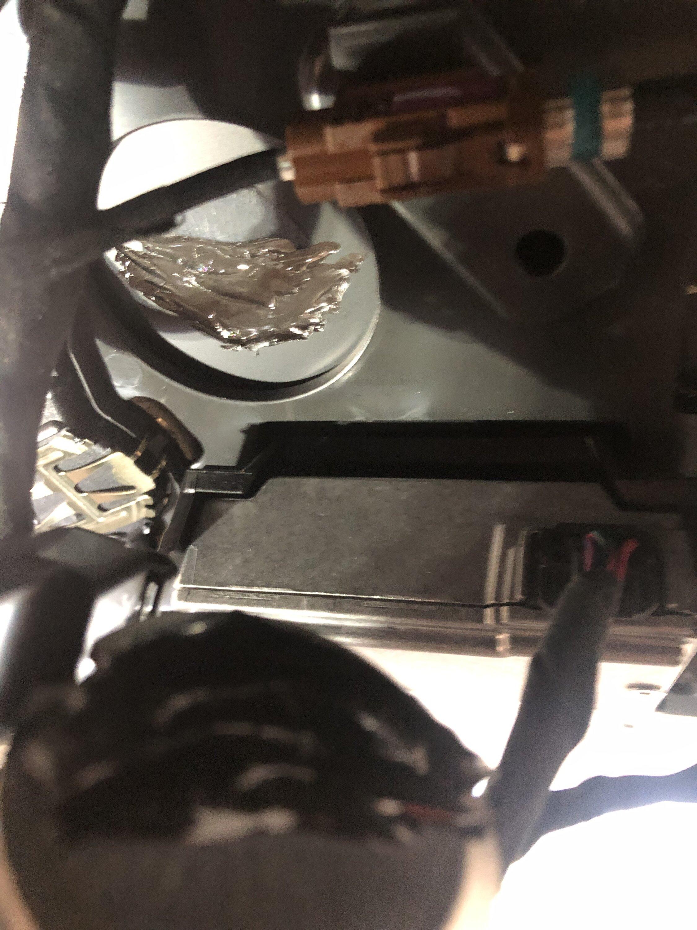

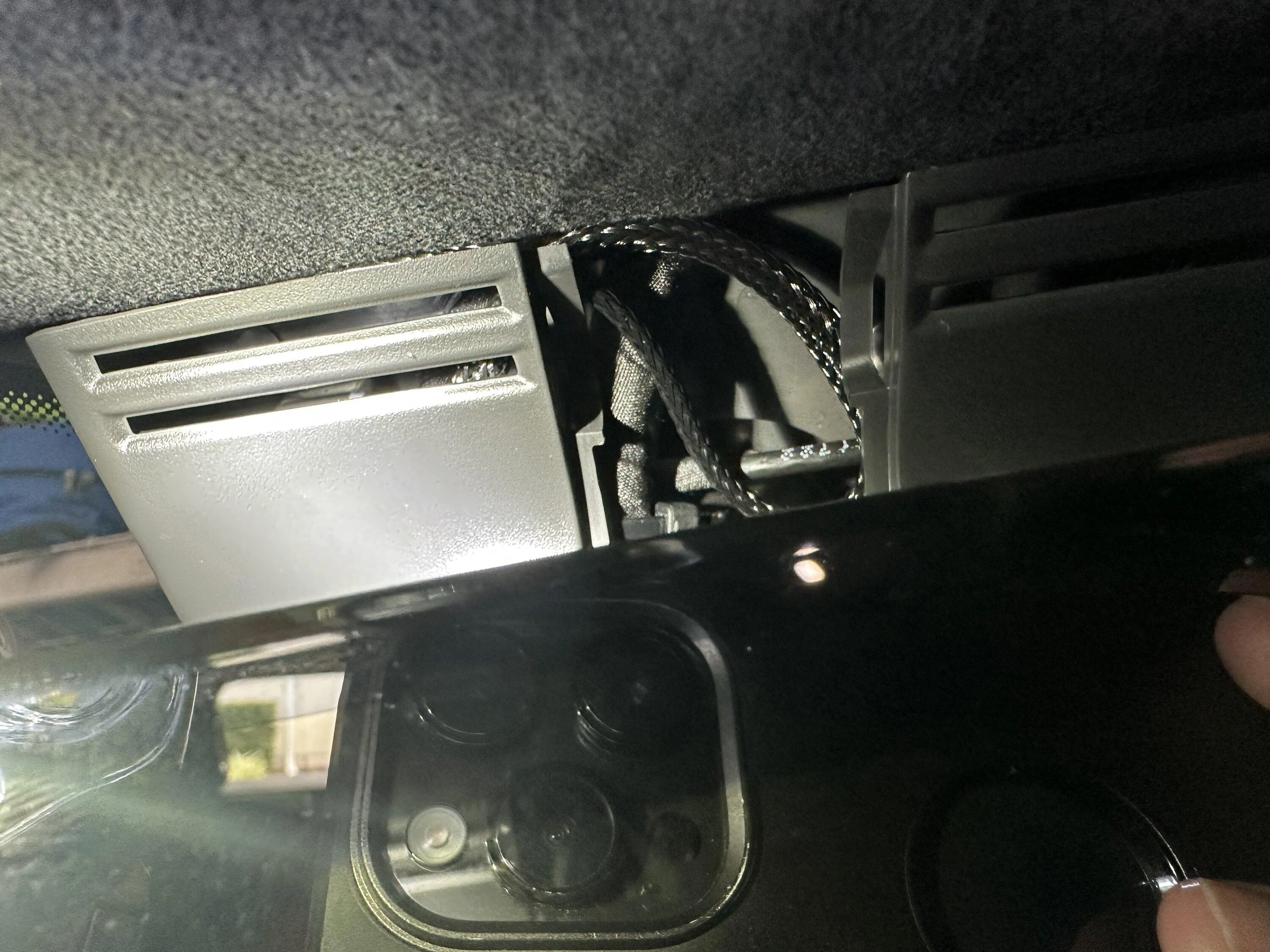

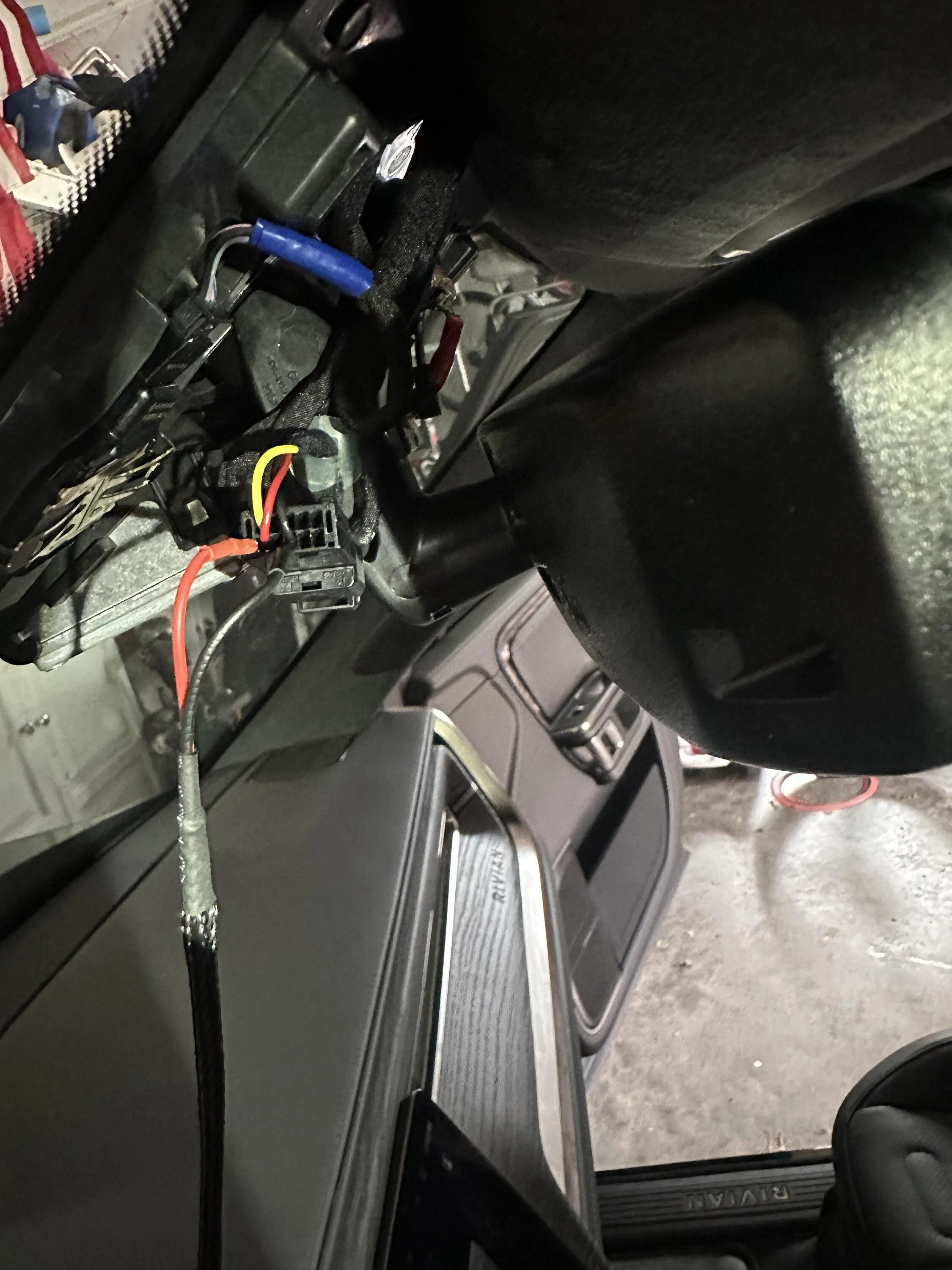

Thanks to OP and all for the help on this thread. I just installed the tap and hooked up my Valentine 1 with no issues, the full process took about 15 minutes, following advice and photos posted in this thread.
Rivian R1T R1S Radar Detector hard wire, who has done it? IMG_8217
Rivian R1T R1S Radar Detector hard wire, who has done it? IMG_8222
Rivian R1T R1S Radar Detector hard wire, who has done it? IMG_8225
Rivian R1T R1S Radar Detector hard wire, who has done it? IMG_8229
Rivian R1T R1S Radar Detector hard wire, who has done it? IMG_8231
Rivian R1T R1S Radar Detector hard wire, who has done it? IMG_8233
Notes and feedback - I just pulled on the bottom (windshield) side of the plastic piece with gentle force until it popped out on the bottom, then slowly worked out the top two clips. Two of the metal clips stayed on, two came off. I pulled the two remaining metal clips out of the holes and replaced on the plastic piece. I didn't bother with a dry fit, this thing can only really go on one way. I pulled off the trim piece that goes along the mirror stem and reinstalled that piece after reinstalling the larger piece. I used the recommended tap wire kit off amazon, with the smallest of the three prong sizes. After installing the prongs by hand I used one of the zip ties to secure the plug and the new wires to some of the existing wrapped wires in this area. I like the suction mount of the Valentine 1, I just routed the wire over to the side along the top of the trim piece. This routing was easy to do after installing the main plastic cover and before reinstalling the piece above the mirror stem. I don't know yet if this will power off when the car sleeps or stay on. I tend to put the detector away when I'm parked for long periods (airports, etc.) so that doesn't concern me. I'll try to monitor the detector for power use and I'll post any updates. Anyone with a Valentine knows that unique startup sound, I imagine I'll be able to hear it if the device comes off and on with Gear Guard or otherwise...

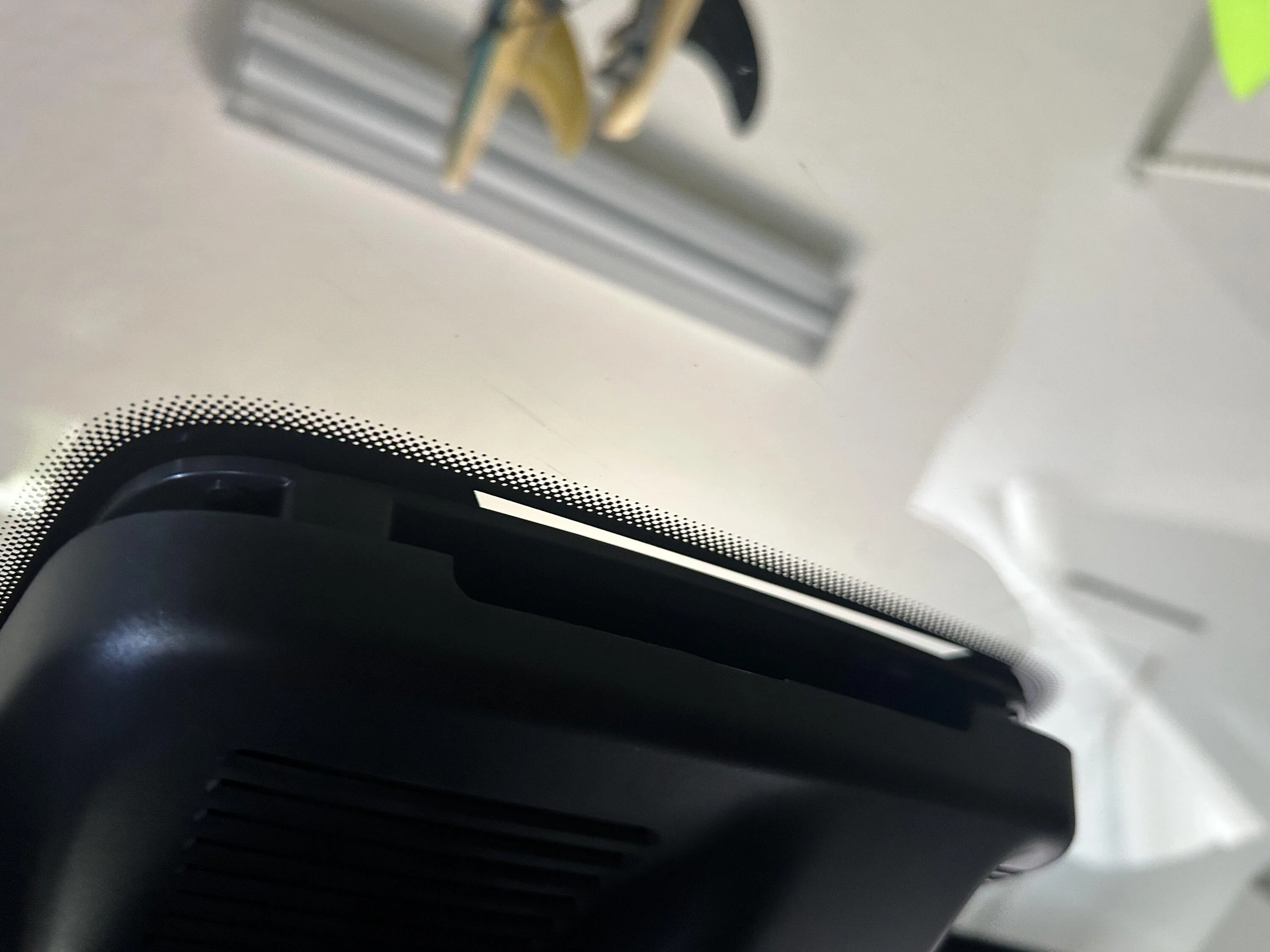

Be very careful!!!
I just tried the same install, using the pin kit from Amazon recommended. The large panel was pretty difficult to get off. I was also using plastic trim removal tools. I had the two bottom clips lose and the upper right one, but the upper left was very difficult. Ultimately, it let go but unfortunately the mirror came off with it. It seems that it was only held on with some type of black glue. Does anyone know what that is?

Be very careful!!!
Bad News:
That is a chunk of the windshield glass that came off with the mirror.
Good News:
I disassembled the mirror and glued the round silver metal piece with the broken glass chunk bonded to it back in place with a Permatex Mirror bonding kit. It clicked right into place. I’m going to let the bond set overnight before I hang the mirror on it.
Fingers crossed 🤞
