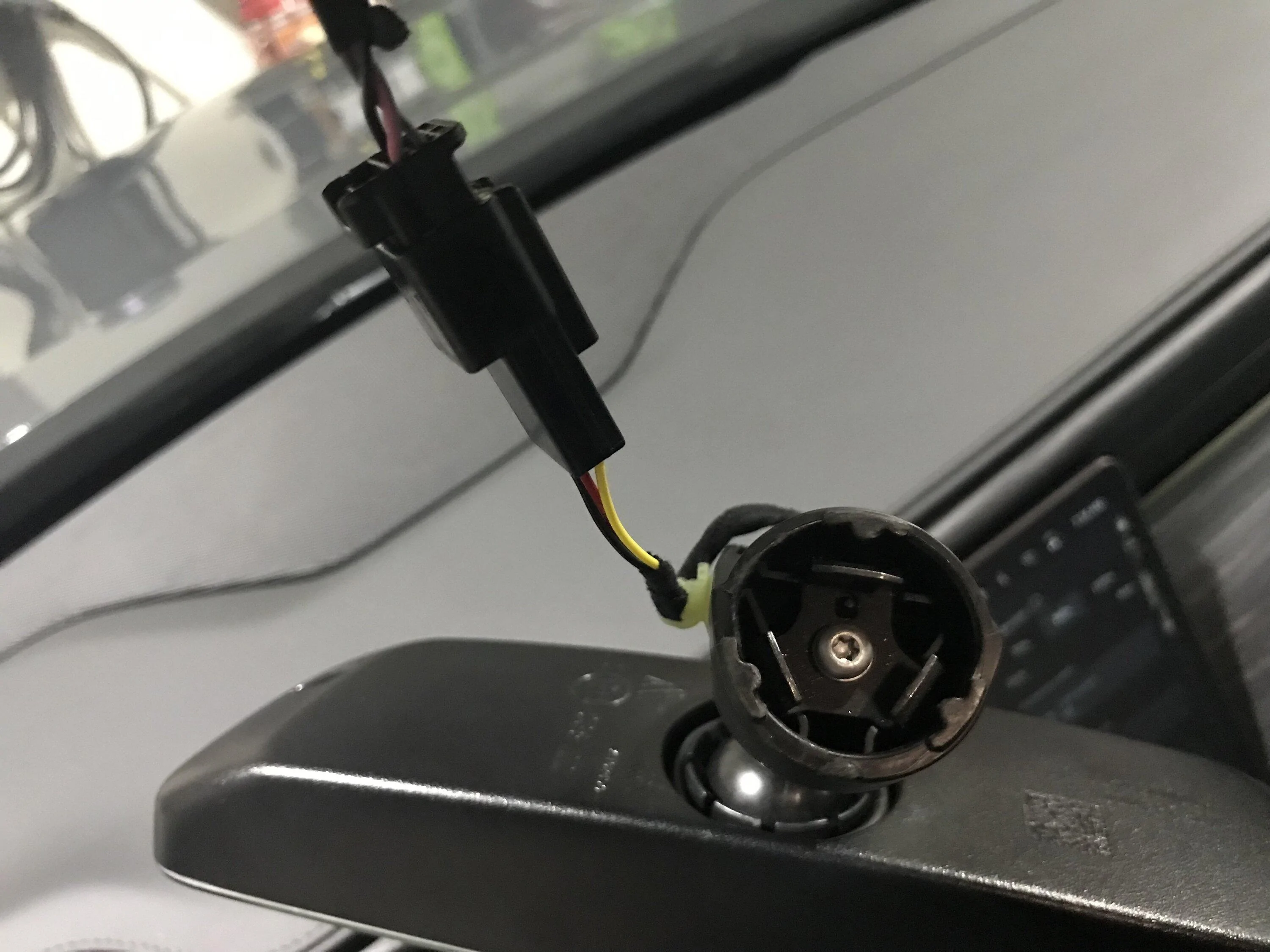

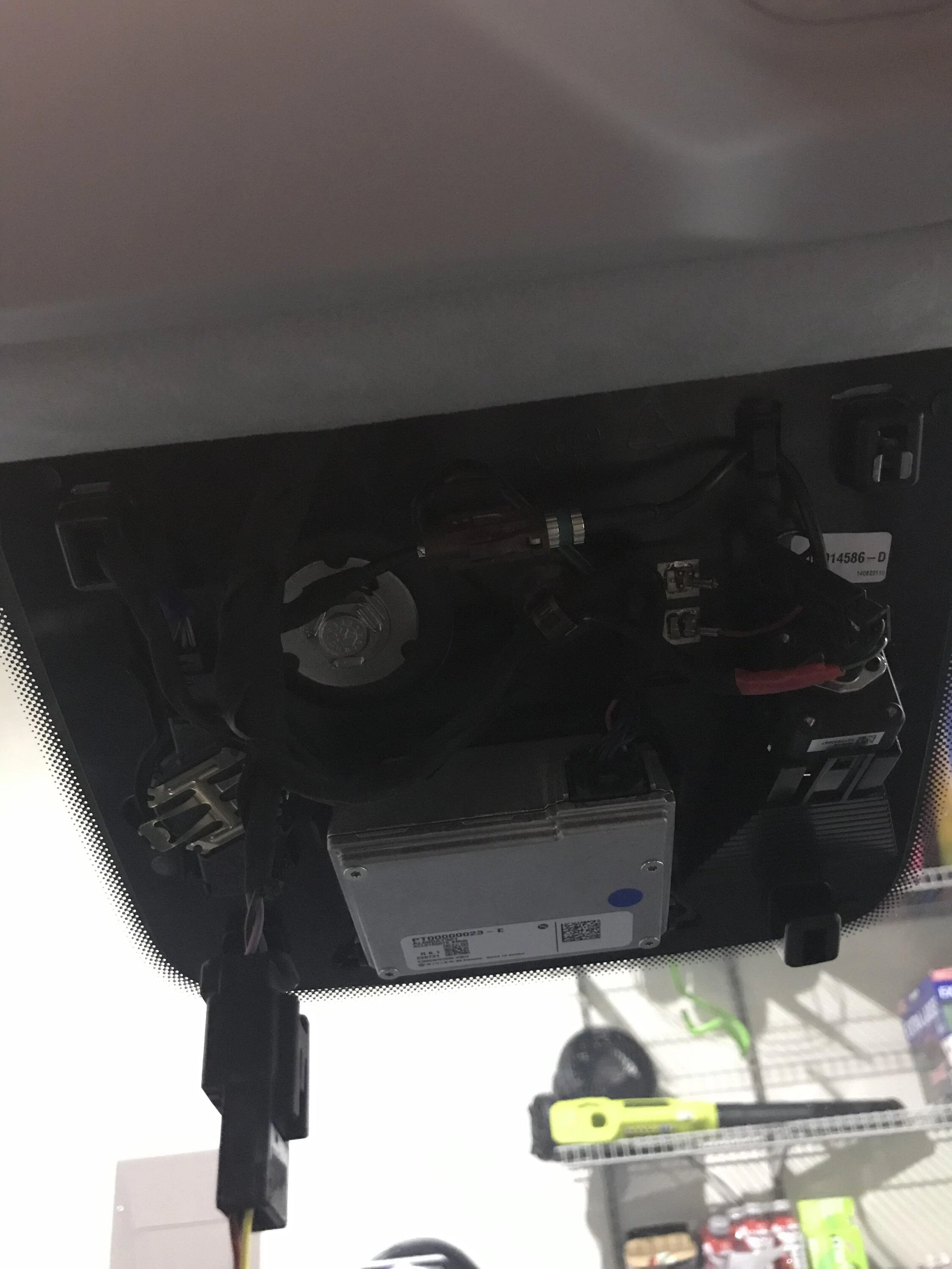

I think yellow is constant, i know red is accessory
I just don't understand why It is staying on if it is accessory.

I have been checking occasionally on the detector. I left it in there and 2 hours later I went in and the detector was on. I also turned off the detector and when I went back to check later it was on. I can’t seem to get it to shit off unless I unplug it. Does anybody have a confirmation on what the yellow wire is? It seems that my red is constant on and not accessory.

I was thinking about this too. The gear guard is causing the radar to turn back on. I think I am going to run a voltage test on the wires and find out what yellow is for sure and try to find one true auxiliary

Ok so testing voltage I got 12v on the red and 8.33v on the yellow. I cannot figure out how to have the vehicle turn off while I am in it to test the voltage. As soon as it registers weight in the passenger seat the screens and everything power up. I guess if I could have somebody lock it and I am on the center console it could work. Or maybe there is an easier way that I haven’t figured out…
