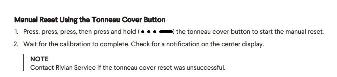

Hadn't seen this posted, service asked me to do a tonneau cover calibration yesterday. Apparently it was added to one of the recent updates.
Press the external tonneau button 3 times quickly and then hold for 5-7 seconds. Next open fully and close fully the tonneau cover. When successful I got a notification inside that tonneau calibration was completed successfully.
Didn't' fix my issue but maybe it will help other people, it definitely did something though so in a pinch it's good to know.

I had to do this 3-4x already and it only works for a day or so. The calibration is actually in the manual as well...pg 145
