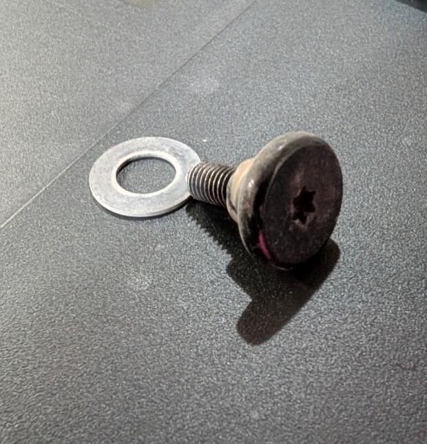

I drove my R1T a couple of hundred miles with my tailgate down and the bolt that holds the tailgate support cable in place fell out along the way.
Believe it or not, Rivian wont sell me one and I have no idea where to find a replacement. I live 5 hours from the closest service center and they dont have any mobile service appointments coming to my area for the foreseeable future.
Can anyone tell me what to call this bolt and/or where I can find one?

Rivian won't sell you a bolt? Wow!!
Anyway, remove the existing one from the other side, bring it to you closest hardware store and match it up with a good quality metric equivalent. You may need to put a lock nut up against the tailgate side to keep the cable eye from binding and to lock the bolt in to prevent this one from coming loose too.

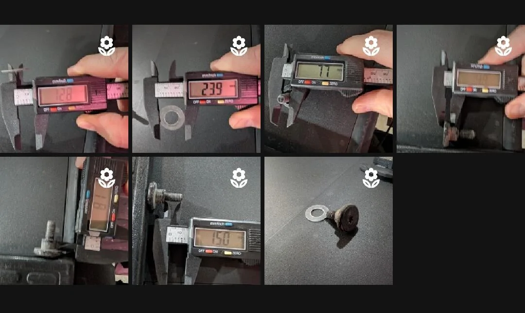

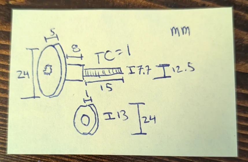

If I'm understanding Riviot's nice sketches, then you just need a regular M8 bolt of the correct length, and an 8mm long spacer with an ID of 8mm and an OD of 12.5mm (close to these diameters might work fine).
Thanks for this 'reminder' for us reading this to put Loctite on these threads! I'd recommend using the blue for good but not permanent locking.

It’s a shoulder bolt might try McMaster Carr’s website they sell many unique fasteners.
