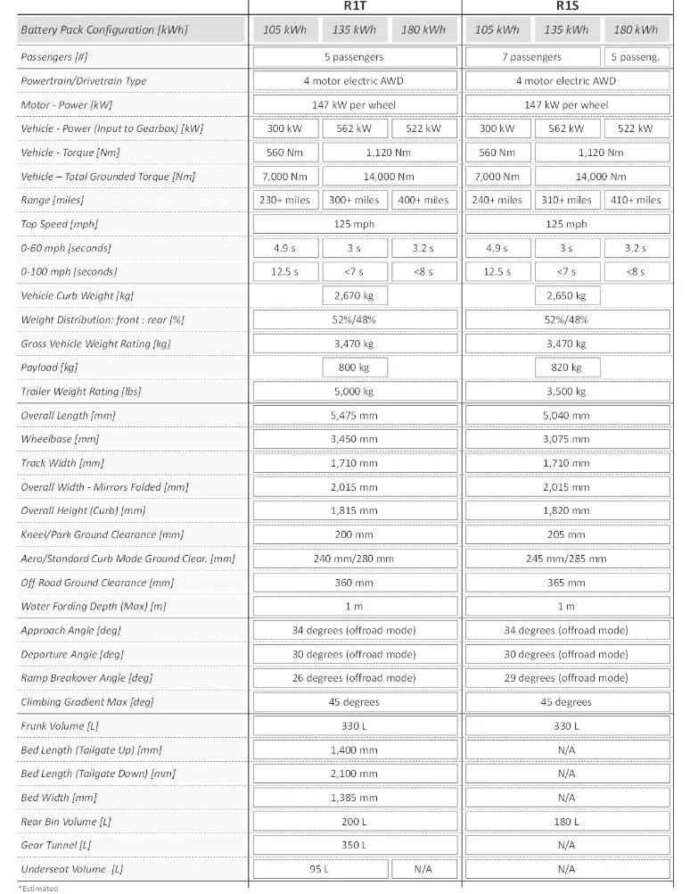

I hadn't realized the 135 model will be faster than the 180. And looks like no under-seat storage for the 180 truck either.
That's not what the chart indicates. The "Gear Tunnel" (350L) is available on all models of the R1T. It is the (95L) under seat volume that is not available on the R1T; presumably where the extra 45KW worth of batteries will be stored.

Was deep diving into the specs - if the production R1T keep these approach angle, departure angle and breakover angle #'s, they would basically be class leading in the pickup segment.
