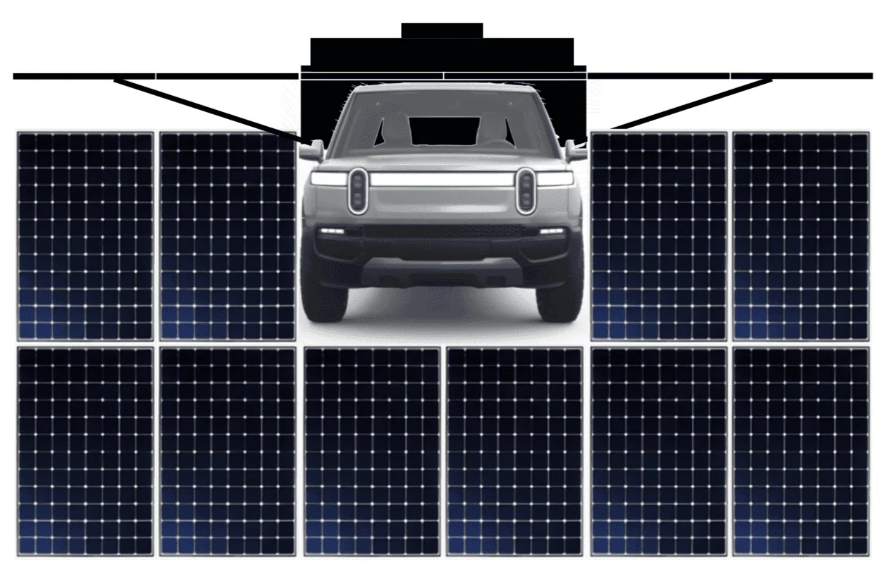

Hi! One of my primary uses for the R1T is as an ideal roadtrip/overlanding vehicle. It has 4 spacious seats, good range, and tons of storage to start. But I've also been daydreaming abut building a custom camping rig that would fit in the bed and provide storage for camping gear and a platform for a rooftop tent and hopefully some solar panels and backup batteries for off-grid charging. The rig could also be set up as a basecamp allowing the truck to do local trips while the backup batteries charge off the solar.
I know there would definitely be a hit to aerodynamics on the highway but otherwise does anyone see issues with this plan?

You'll get max 8km a day with any kind of meaningful solar setup, and thats if the R1T doesn't move.
I would like the solar for that reason, as if I'm camping for a week, thats an extra 45km of range.
I wouldn't bother with auxilliary batteries/base station. More hassle than its worth, and the car is the battery in any case. Rooftop tent would be good, especially if solar could be on top during the day and either folded out or a hard roof at night, however water collection tarp and some storage for water would also be a good idea for a proper camper. The spare tyre compartment would be able to store probably 50 litres of water maybe, but you'd want more if you're doing an extended trip. You could easily store the spare tyre on a metal rack that lives on the bonnet. Put a kitchen in your gear compartment, a fridge in the frunk and you've pretty much got the entire bed free to play with.

If those 10 panels he shows are 300W panels he'd get about 1/4 kW from each in full sun for a total of 2.5 kW and he might get as much as 4 hrs equivalent full sun per day (perhaps more in parts of Oz or in the US desert areas) for 10 kWh which might give him 25 - 30 mi (40.5 - 48.6 km) in sunny weather in the summer. Provided, of course, that he didn't use any of the juice for anything else.

My hope is that 10 300W residential-roof-top-style panels would be enough to set up a basecamp during the day to charge up the backup battery and then transfer that energy into the truck via an L2 charger overnight, topping up the R1T with enough range to run around the next the day. The idea being that you could drive out into the wilderness and maintain your charge enough to always be able to get back out of the wilderness and to a real charging station. 25-30 miles per day seems sufficient for that.
Also, worst case scenario it's possible to limp along at 25 miles a day and get back to civilization no matter how far out you go.

Of course what would really be nice is if the truck had a panel in the bed with 10 - 20 standard connectors for solar panels into each of which one would plug a panel within certain spec limits. Behind each of those connectors would be a MPPT upconverter which would charge the vehicle battery directly. Not only would this load miles but the energy would also be available for use around the camp through the 120 (and we hope 240) V outlet(s) in the bed. This is entirely feasible and would make a great addition to the truck but I doubt they'll do anything like that. Thus you will have to have a separate controller(s) and a battery to store what the cells collect plus an inverter to charge via L2 as you indicted. The battery takes up room and is heavy and all the conversions lose energy.

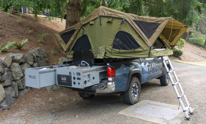

This company, out of Montana, makes custom, clamshell platform tents with a steel frame for support and fold out sides. By removing cushions from the platform bed, you can stand inside the bed and by using the fold up sides for attaching the solar panels, you've actually got an overland rig where much of the design, fabrication and installation work is already done. The downside is the company's products are so popular there's a 9-12 month waiting period
If it were I, I'd start with something like this and then add on custom features to an already proven platform. https://gofastcampers.com/ (Once the first platform tent is built for a Rivian by GoFast, subsequent orders will go fast/er.) (Or, better yet, get ahold of a Rivian-Amazon van and start customizing.)

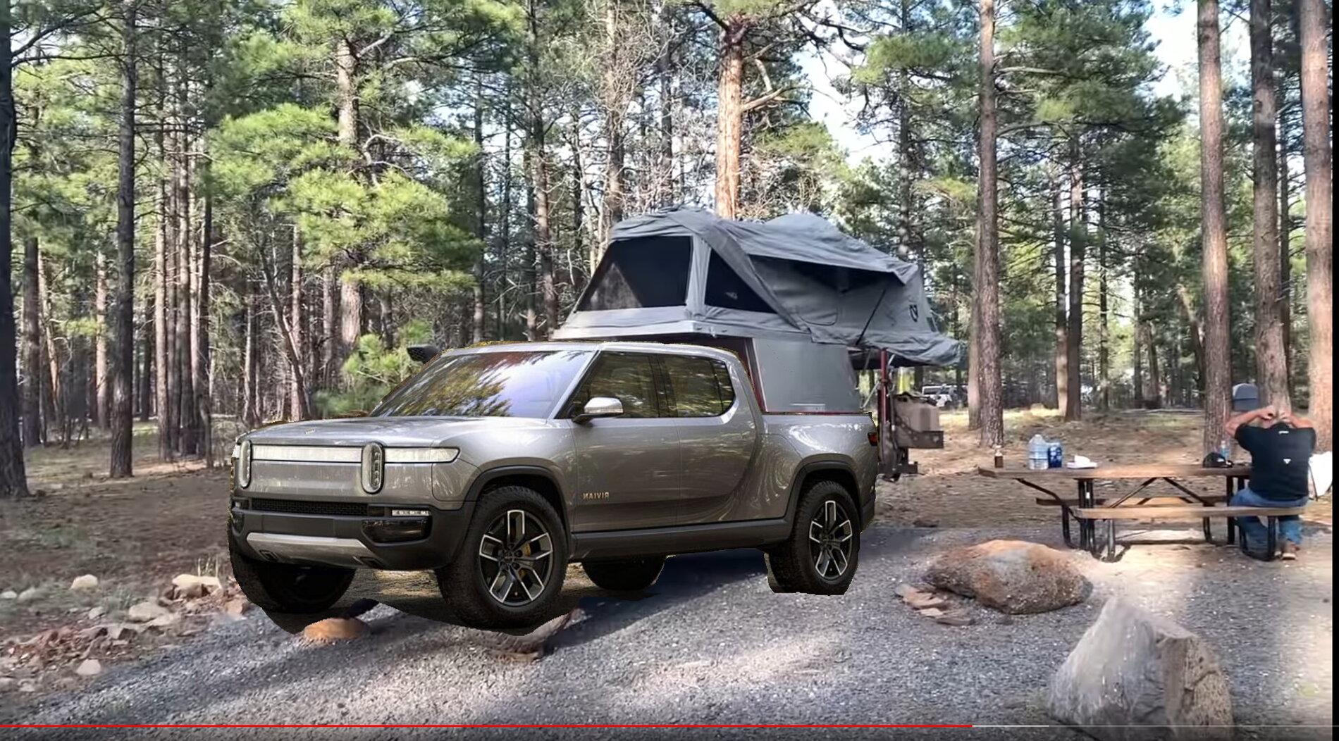

  • AT Habitat - after comparing the leaked R1T stats to the options for the habitat, I think it should be possible to get one fitted properly into the back of the R1T
    • In the end, this isn't the tent ill be going for, but its similar to the one you posted, and takes care of building the rest of the camper for you
    • PRO: it can be removed for daily driving if you really wanted to

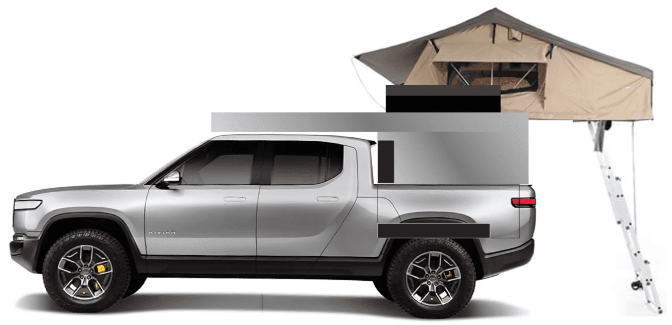

    • I did a VERY SLOPPY edit for my own considerations:
Rivian R1T R1S R1T Overland Rig Possibilities Rivian with AT Habitat sloppy
