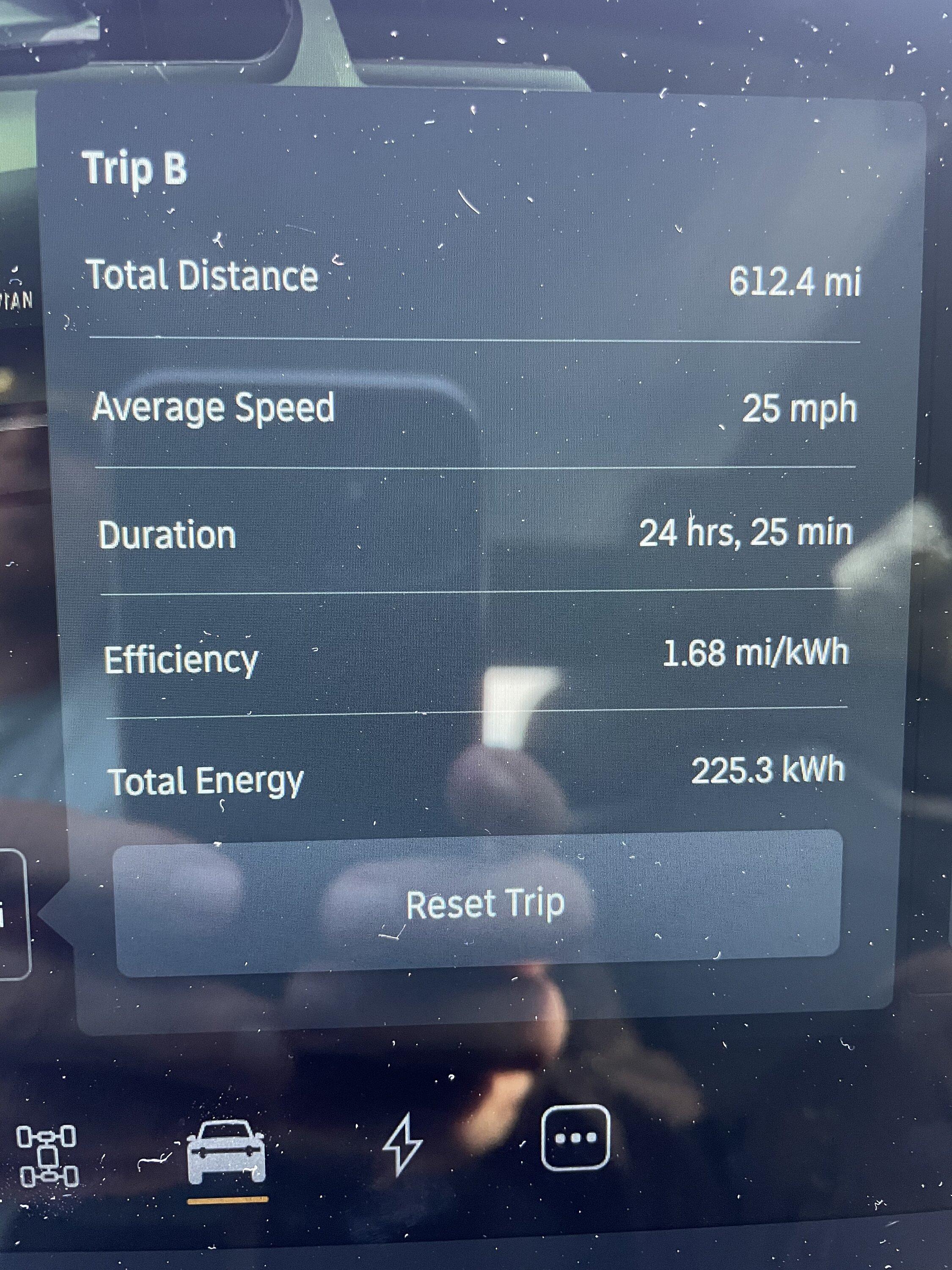

My Trip data is saying that I’m getting efficiency of 1.68 mi/kWh for the trip but total miles were 612 and total energy was 225.3 kWh. If I divide those numbers, I’m getting 2.71 mi/kWh. What am I missing?

It's a bug, came in one of the recent updates. Efficiency number is right but energy used is not.

I noticed the bug shortly after the last update, was on the phone with Rivian for something else and mentioned it to them. The guy on the call did not say "oh we know about that" so I put in a ticket, sent pictures of the bad math and showing it was correct back in November. Hopefully fixed in the next update. Not a big issue, just multiply the total energy used number by 2 and you have the right answer.
