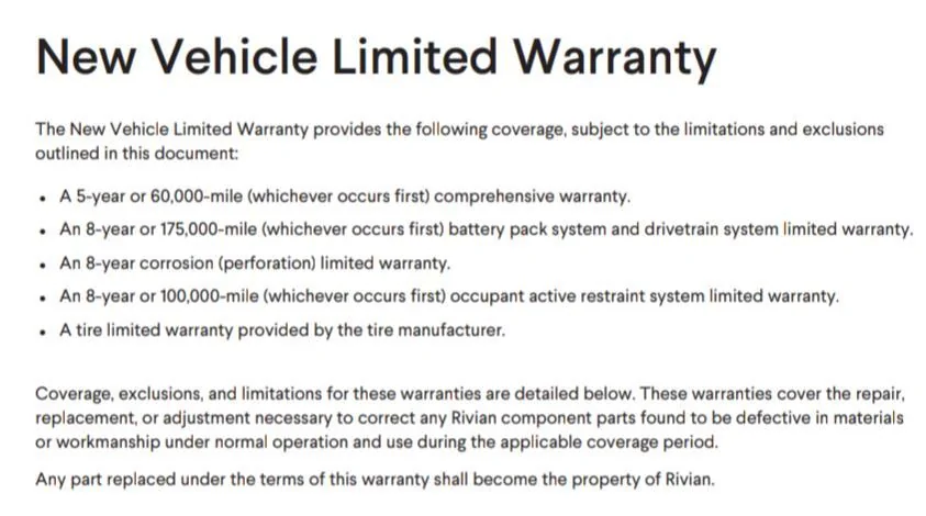

I'm nearing 3 years and almost at 60k miles, so I feel your frustration, but my subframe problem was identified early enough and (knock on my noggin) I've only had tailgate issues since.
Since you have a battery/drivetrain issue, it's covered for even longer. You've got 5 more years and 125k miles to go! I recommend keeping it.
https://rivian.com/support/article/new-vehicle-limited-warranty-guide

well, Rivian has one less excuse as to why they can’t figure it out. Good news is the launch edition has an 8yr 175k mi warranty on battery/drive components and new car warranty good for 5y/60k
