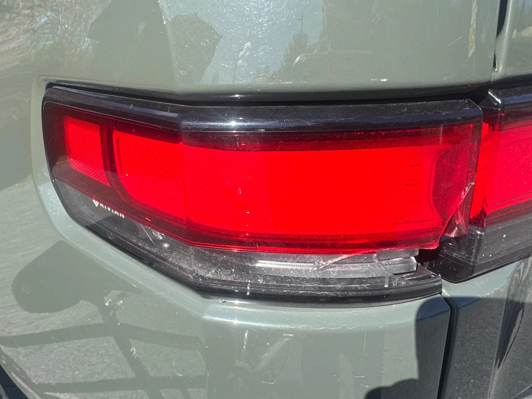

Found a nice one on eBay and ordered.
Looks ez on YouTube.
Anyone ever remove the left inner bed panel?
Any chance it will flex enough without having to remove the front panel that covers the retracted tomneau?

Angle at the forward end of the side bed panel is held captive by the front/tonneau panel. Nonetheless, you should be able to take out a few bolts and flex the panel to get access to the bolt for the tail light.
Think I will stop in at my SC tomorrow and ask about their price on a new rear light bar. All the second hand ones I see have some damage. Will report back. Part number is PT00000470.

You won't be able to find just the lens. You'd have to replace the whole rear light bar.
Yup.

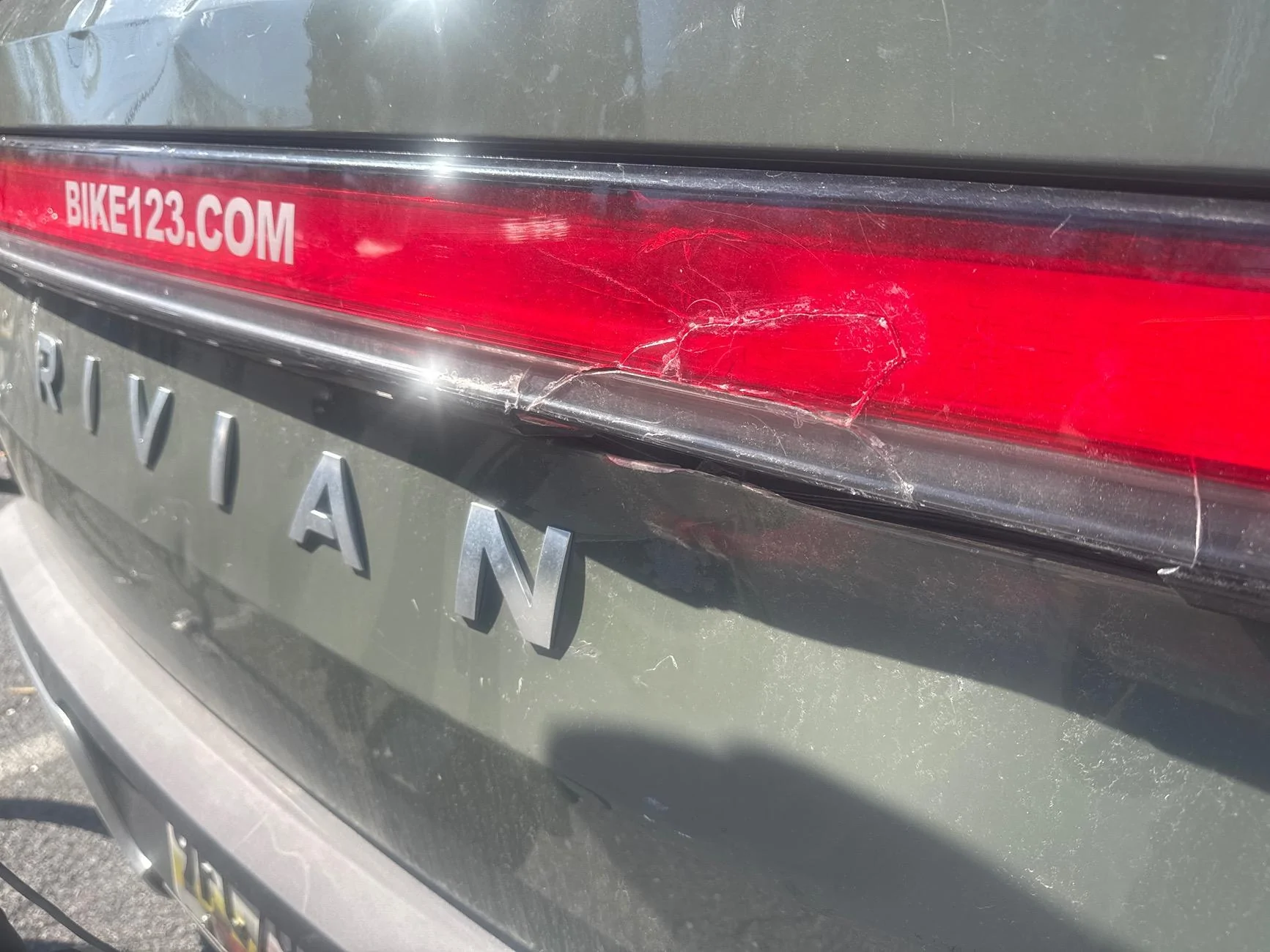

Mine had a crack/hole in it from OO damage. Repaired it with 3M kit and it works fine but it isn't pretty.
Then again, replacing it without also replacing my dinged tailgate is probably silly.
I assumed that thanks for confirming.
It’s functioning but when a complete one comes along , even scuffed and some cracks……. I’ll get one
Likely not as simple as the corner
Update:
Several ‘nice’ light bars on eBay $300-$350 delivered.
I’ll wait for the report from Rivianero ( please check on labor thanks) on the new one and start looking for a how-to ( or an if-possible)
I’d like to have a dinged tailgate instead of this dented one ;-/
