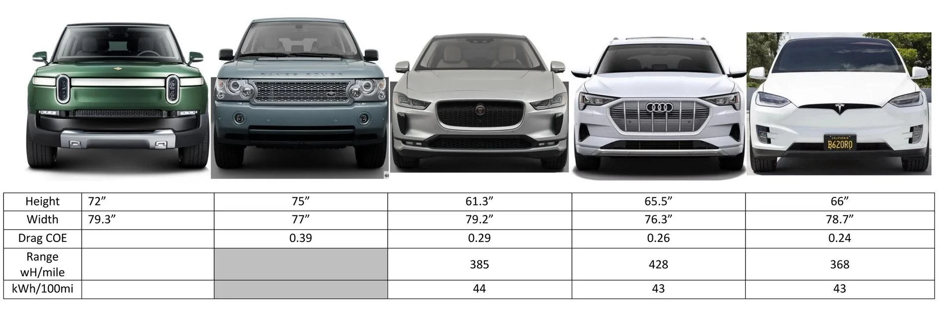

It will be interesting to see the Drag Coefficient and Energy consumption for the R1S when the official figures are released. In the meantime, it is interesting to speculate using the available data and comparable vehicles.
This photo shows the Drag Coefficients for various vehicles, including the Range Rover which is similar in design, as well as the other large (ish) BEVs. The R1S is taller and wider than all the BEVs. It is similar to the Range Rover (shorter but wider), which has a Drag Coefficient of 0.39. This is much higher than the Model X, which is 0.24.
Frontal area is another important factor in determining the impact upon range, but I was not able to locate these figures for most of the vehicles. The picture will guide you in comparing among the vehicles on the differences in frontal area.
The efficiency of the powertrain is another element. Tesla made significant improvements in the Model X efficiency over the years, primarily with the move to permanent magnet motors. Does Rivian use permanent magnet motors?
Rivian can improve upon the Range Rover drag coefficient with the a smooth underbody and other design choices, but an improvement beyond the 0.3 to 0.35 range will be difficult due to the overall size and shape of the vehicle.
When you factor in the following:
- Relatively high drag coefficient compared to other BEVs (projected)
- Large frontal area compared to other BEVs
- Large tire sizes of 21” for road tires, 22” for performance tires and 20” for all terrain
- High performance motors delivering quick acceleration (range is reduced in high performance motors over regular motors in a Tesla for example)
You might conclude that rated average energy consumption will be above 400 wH/mi, probably around 425 wH/mi using the 21” rims. (wH/mi is the amount of energy required to move the vehicle 1 mile. The attached photo shows the energy needed to move some other BEVs). Using 132 kW as a battery pack size (they have said it is no longer 135, but somewhat smaller), you come to a range of 310 miles for the R1S Large Pack with 21” Rims.
Tesla vehicles see a ~10% range reduction by going from 20” to 22” wheels. The change on an R1S from 21” to 22” is less severe and may equate to about a 5% range reduction. This would give the R1S Large Pack with 22” Rims a range of 295 miles at 446 wH/mi (a 15 mile range penalty for the larger rim size).
What do others think about the wH/mi ratings for the R1S with 21” and 22” rims.

I'm missing something. If the consumption for the Tesla is 368 Wh/mi then the consumption for 100 miles is 36800 = 36.8 kWh yet the table says 43 kWh. ??
Plus the consumption for the X isn't anything like 368 Wh/mi. It's rated consumption is 272 Wh/mi. I realize about 280 in normal driving and a little over 300 at high speed on the freeway.
That aside my gut says the R1T will use something like 420 Wh/mi with the factory's most efficient wheel/tire. But that is no more than gut as I have no idea what actual Cd nor effective frontal area may be.

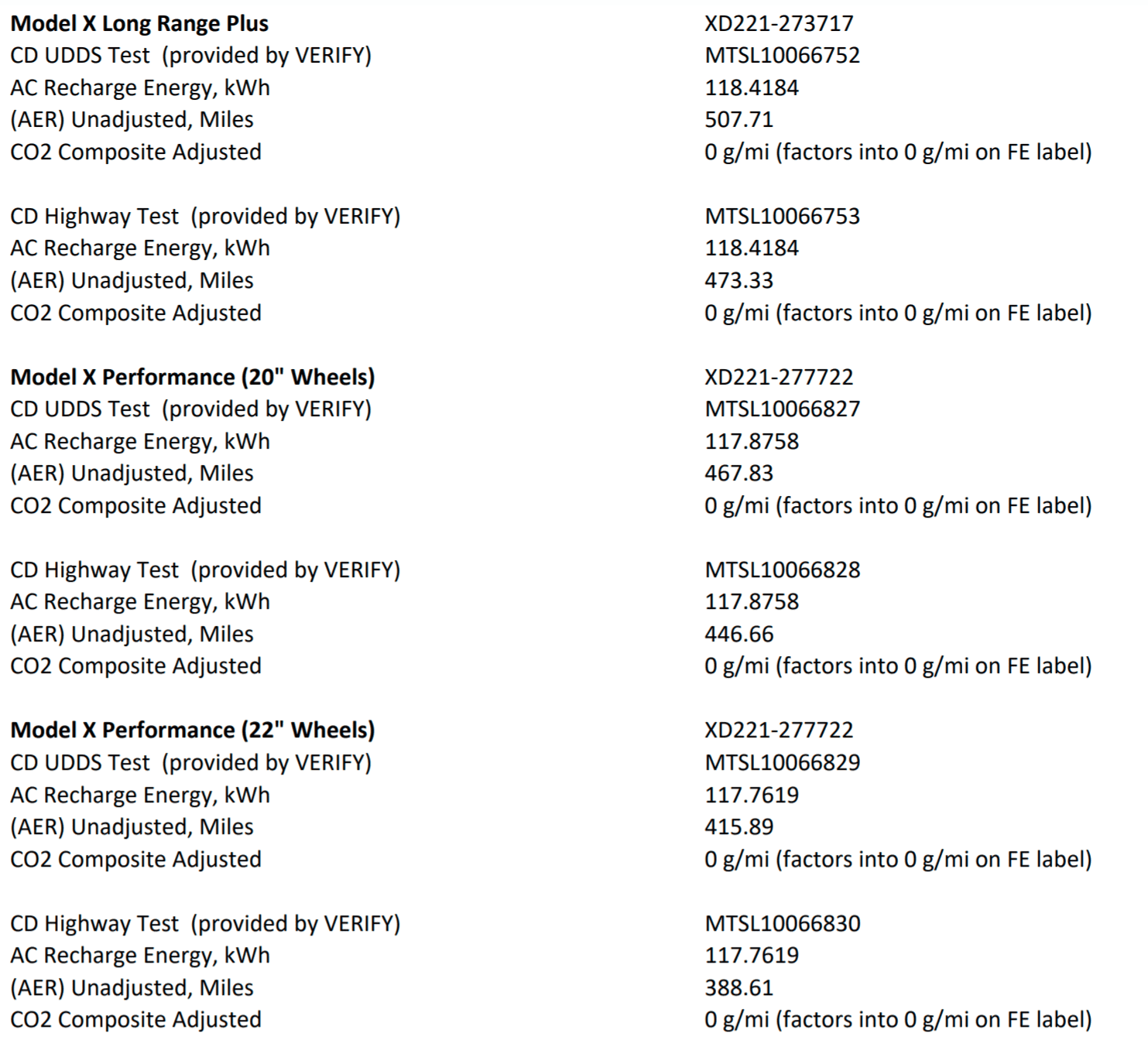

They provide 2 different energy consumption numbers that I am still researching. The first is shown as 43 kW/100 mi. The second is calculated dividing the size of the battery by the range as shown on the label.
43 kW/100 mile is measured "from the plug", includes charging losses, and thus will corelate directly with MPGe.
The battery size/range metric is difficult as most often only the rated or potential battery size is available (and sometimes not even that). Some companies like BMW also let you know the "usable" portion. Tesla publishes nothing about battery size for any of their vehicles, but the latest Model X testing docs show needing ~118 kWh from the plug to recharge from empty. This is up from ~114 kWh and is a good indication that Tesla is increasing the energy in their packs or making more of the pack "usable" by reducing upper/lower buffers in order to help get the improved EPA range ratings.
Rivian R1T R1S R1S Range and Energy consumption 1606585897735
https://iaspub.epa.gov/otaqpub/display_file.jsp?docid=51236&flag=1
When in use in EVs, batteries (as a rule) will not be "fully charged by the BMS (at cell level, 42.V would be fully charged and the usual upper limit is ~ 4.1V). Nor does the car allow the batteries to be fully depleted (to the rated cutoff voltage - often 2.5V but ranges up to 3.0V)
Thank you for this data and link. Interesting and helpful.
I read the document and looked up the UDDS test procedure. Am I reading it correctly, that the 118 kWh shown in the data is not the size of the battery, but rather how much energy was used to recharge the battery, including charger energy loss and energy used by the car during charging to maintain pack temperature etc?
Could the variation you mention from 114kWh to 118kWh be a change in charger efficiency or increased energy for pack temperature maintenance?
It is indeed the amount of energy used to recharge a battery that is run to zero on the dyno (numbers are provided for after both the UDDS and hwy tests - on some vehicles there is a slight difference).
This is done under lab conditions with temperatures and other conditions being equal (or as close as a lab can achieve)
There is some unknown +/- error percentage, but as range has increased for the X, charging kWh has increased over the 2019 and 2020 applications:
https://iaspub.epa.gov/otaqpub/display_file.jsp?docid=46587&flag=1
https://iaspub.epa.gov/otaqpub/display_file.jsp?docid=48715&flag=1
A couple of extra kWh is not enough to account for the amount of range increase, and may be due to other factors, but the same pattern exists on other Tesla models with range increases.
The 2021 Model S also shows 118 kWh
https://iaspub.epa.gov/otaqpub/display_file.jsp?docid=51337&flag=1
While the 2020s show 113 to 114 kWh
https://iaspub.epa.gov/otaqpub/display_file.jsp?docid=48713&flag=1
and the 2019s 111 to 113 kWh
https://iaspub.epa.gov/otaqpub/display_file.jsp?docid=46586&flag=1
Something about getting more range out of the vehicles results in a touch more energy being used to recharge.
