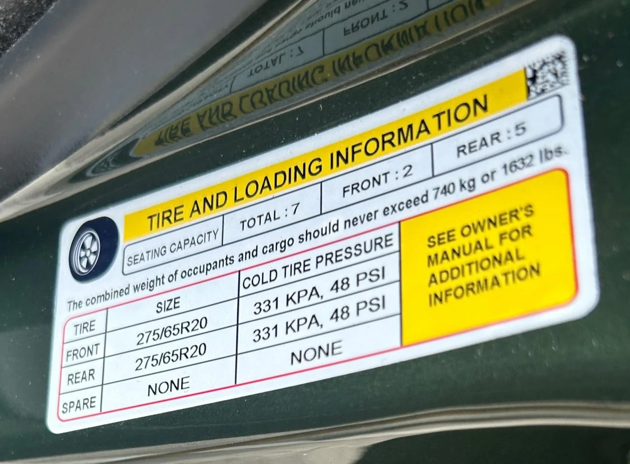

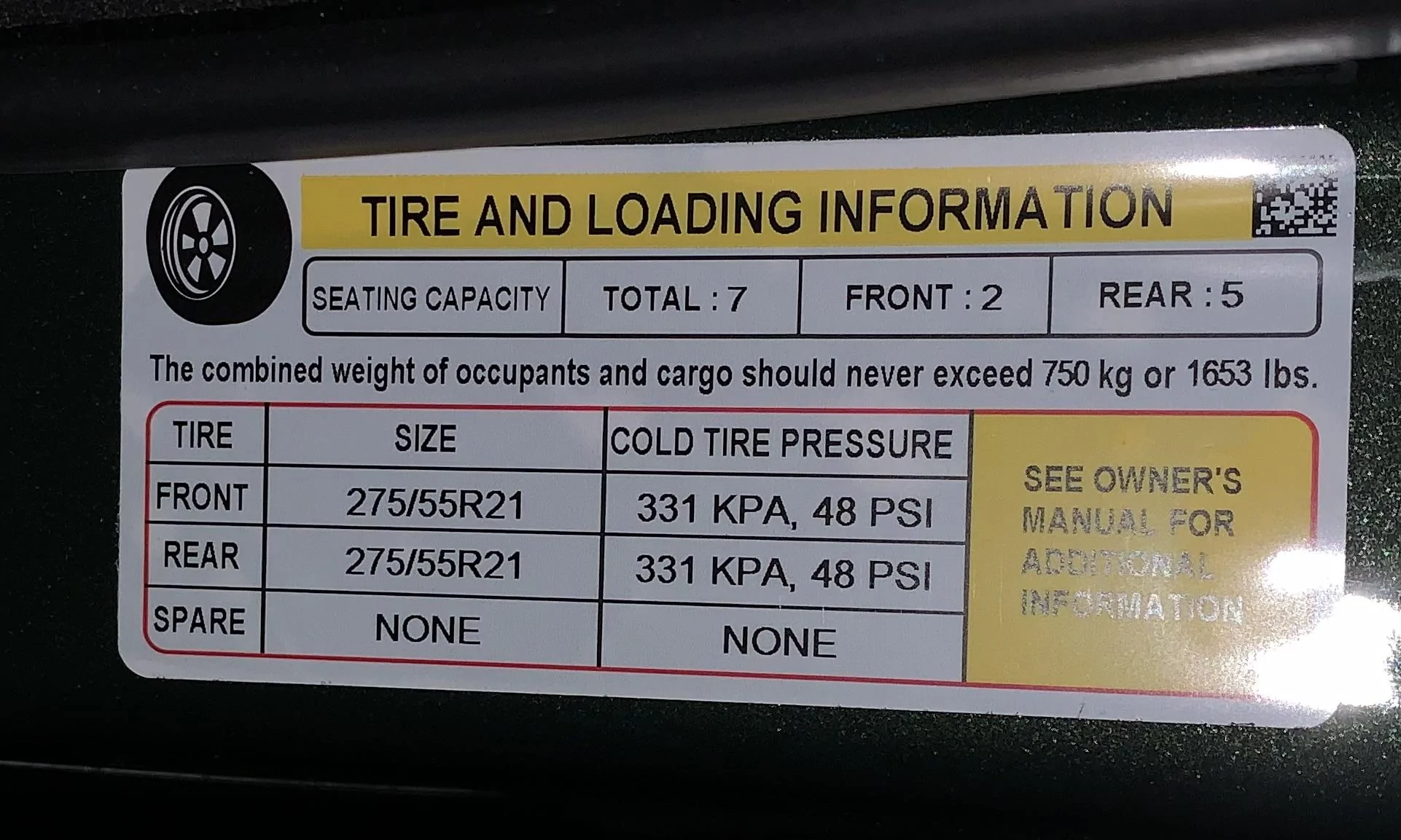

I did a search for this but couldn't find a thread with real life R1S payloads, so I'm posting this in case people are curious. I just took delivery of my R1S and was pleasantly surprised that the payload was at 1632 lbs, since I had seen a bunch of R1Ts with payloads in the 1300-1400 range.
It's an Adventure model, Quad Motor, Large Battery, 20" AT wheels, no underbody shield, no spare.

I have an identical R1S, except it's a Launch edition. Same payload: 1632.

Payload for LE with underbody shield and no spare, 1/23 build: 1508

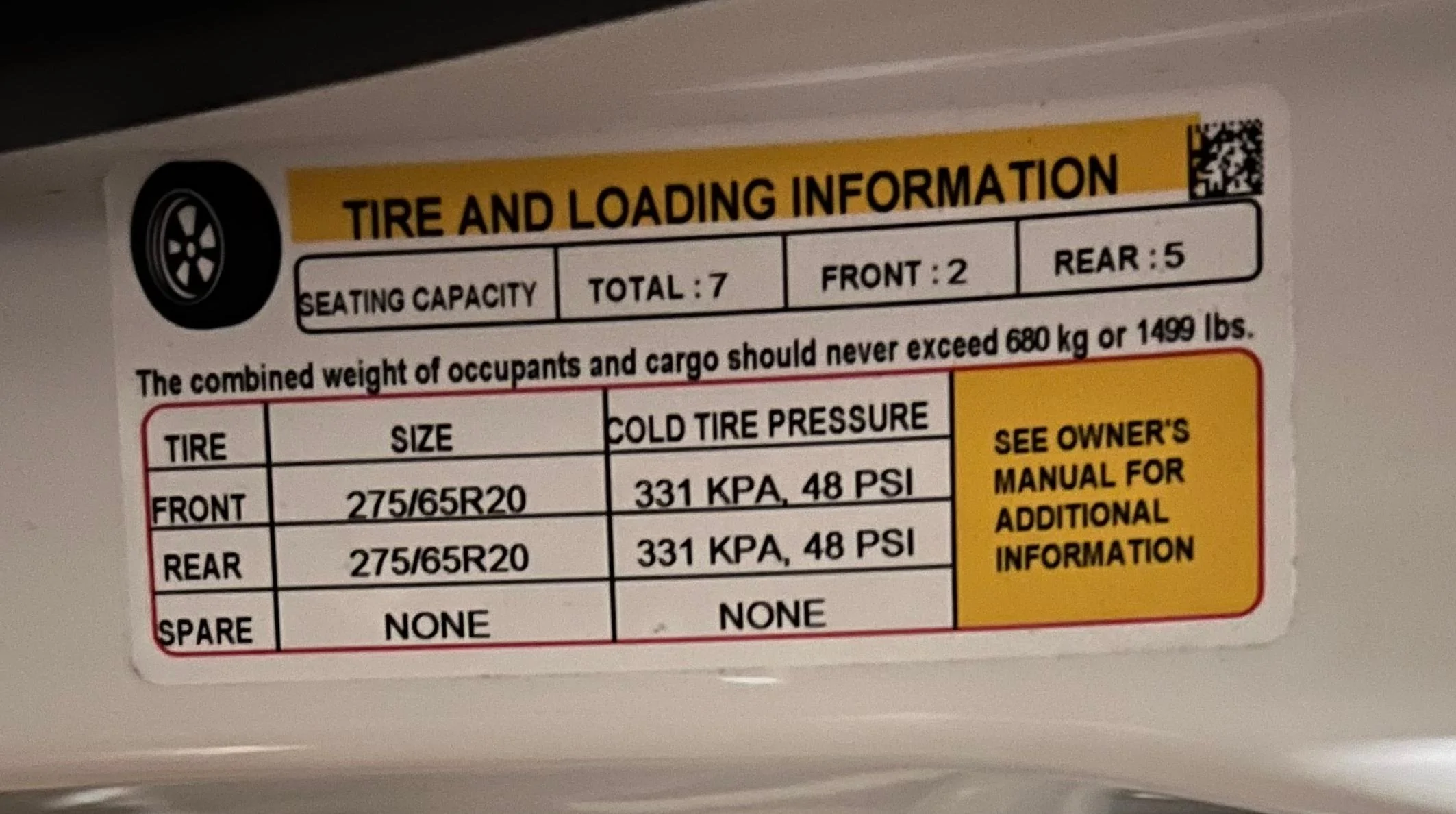

Chevy Express AWD, Lexus RX450h, Rivian R1S
1499 Lbs. on my R1S Adventure, Quad, Lge Batt, 20" AT, Reinforced shield, no spare

Adventure, quad motor, large battery, 21” wheel, no underbody shield, no spare has a very slightly higher payload of 1653lbs.
VIN 11xxx
Rivian R1T R1S R1S Payload Stickers IMG_4593

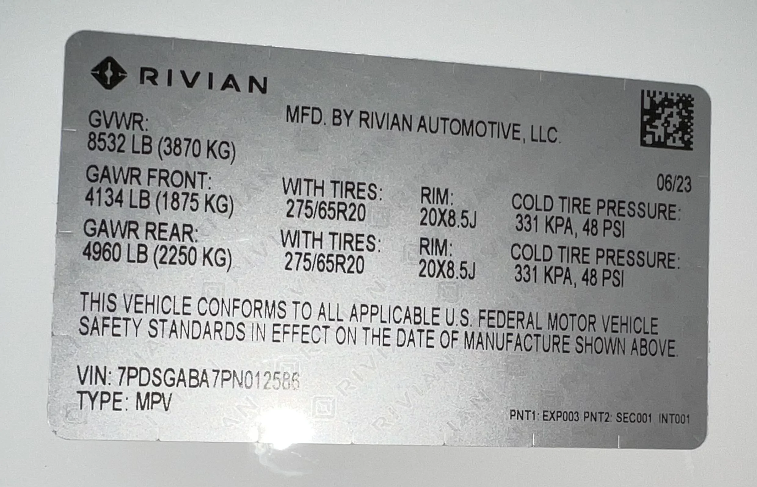

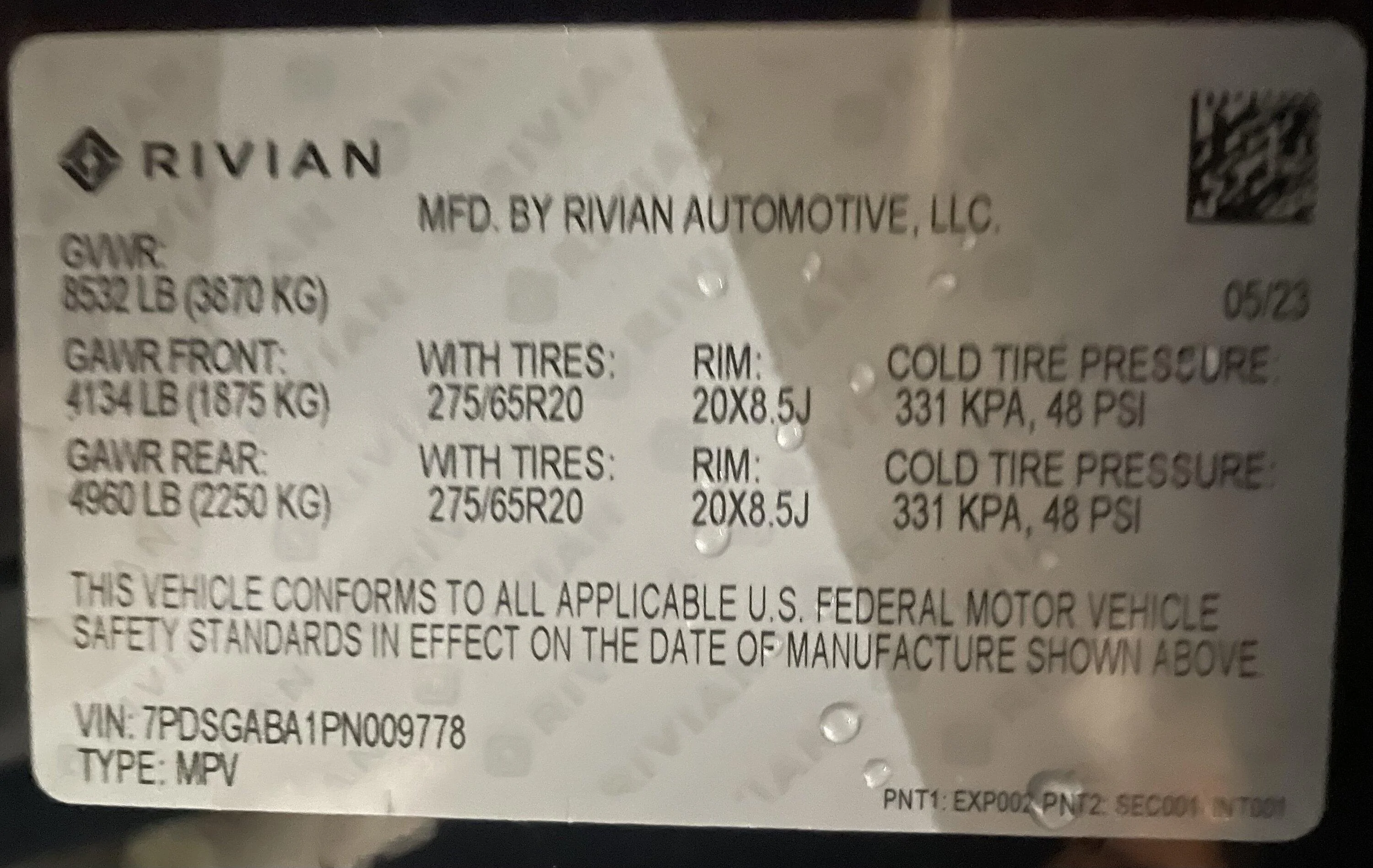

Going a little deeper in the vehicle weight ...
"Curb weight is the weight of a vehicle when it is completely unmodified with standard equipment, a full tank of fuel, and no passengers or cargo. GVWR (Gross Vehicle Weight Rating) is the weight that the vehicle should never exceed in order to be driven safely, and includes everything loaded on, including driver, passengers, and cargo, as well as the weight of the vehicle itself. Payload rating is the amount of weight the vehicle can haul and is calculated by subtracting the vehicle's actual curb weight from its GVWR. GVWR is the maximum weight the vehicle is rated to carry."
These tags are from my R1S which is the Adventure model, Large battery, Quad motors, 20" Dark w/AT tires, Reinforced underbody shield, no spare.
Rivian R1T R1S R1S Payload Stickers 1688435432399
Rivian R1T R1S R1S Payload Stickers 1688435489094
This scale ticket is from a certified truck scale. They did not know about Rivian; thus called it a "Jeep". It was totally empty when it was weighed except for whatever came with it as received.
Rivian R1T R1S R1S Payload Stickers 1688435608108
To summarize the above, my R1S has a Curb Weight of 6,980 lbs.. It has a GVWR of 8,532 lbs.. The "Tire and Loading" tag says it can carry an additional 1,499 lbs.; however, that is incorrect! It can actually carry an additional 1,552 lbs. which is the difference between the GVWR and it's Curb Weight.
I am not sure, but the 53 lb. difference may be the weight of the compact spare which it does not have.
I also learned the adding the Front and Rear GVWR numbers does not add up to the Vehicle GVWR. Apparently, this is quite often the case. Because it is possible to overload one of the axles without overloading the vehicle itself, axle specific GVWRs are also provided.

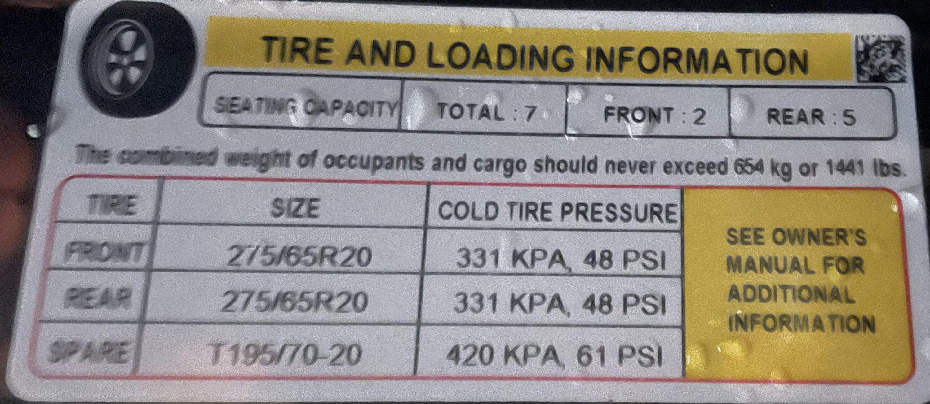

Audi
20 AT, Q large, underbody, compact spare
1441 lbs payload

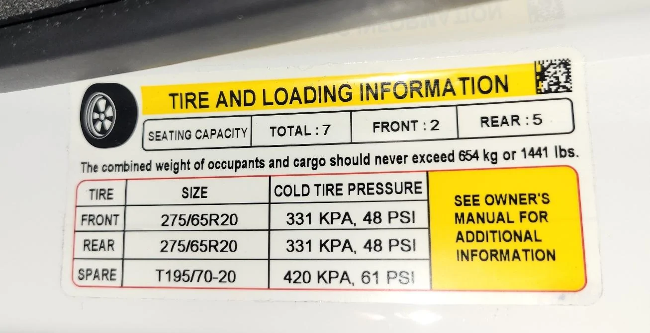

Ced
Mar 16, 2019
New York
2023 Rivian R1S AT
Same, 20 AT with underbody shield, compact spare. Losing close to 200lbs of payload with all-terrain package (shield and tow hooks).
