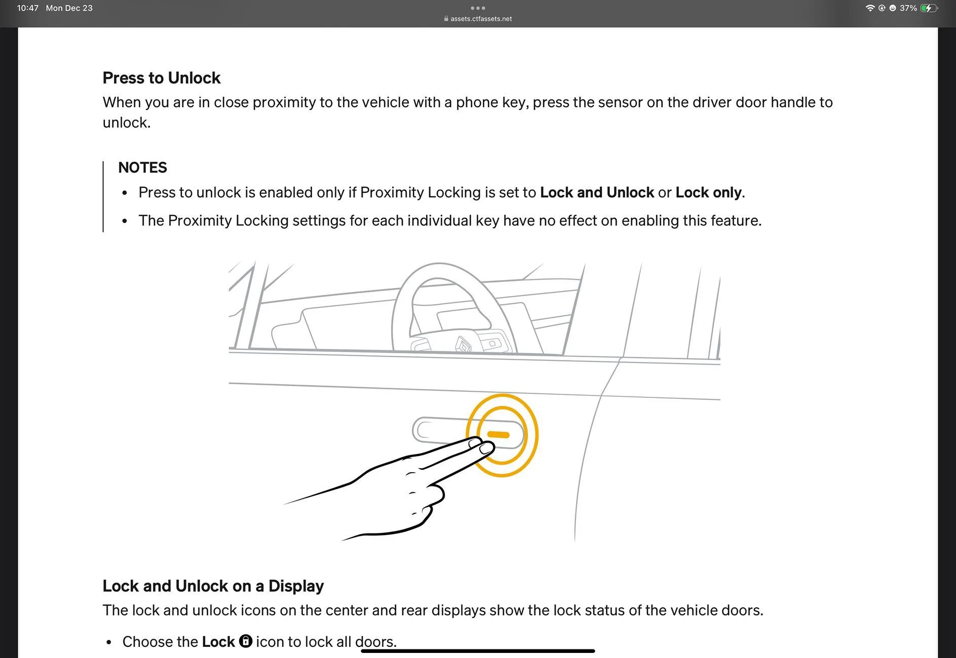

What are people’s experiences with this from the manual? It *LOOKS* like what I want, but I can’t seem to get it to work. The handle doesn’t seem to have much of a ‘press’, but I’ve tried just a touch, a touch-and-hold, and a press. Proximity locking is on Lock Only (at Home)

Not sure its much of a press; probably more like a touch on the indentation part. If its anything like my Volvo, that had a similar behavior where if you had the keyfob with you, you could just touch on the indentation to lock and unlock. Could be a short delay (like 1 second) before it registers. Haven't tried this on my R1S but I might as I do prefer that behavior.
What I've resorted to is just closing the Rivian App on my phone so that it doesnt trigger the lock/unlock eveytime I walk by it at home. Have you tried that?

You can also tap your phone to that part of the handle and this works for me, though it does require one to take the phone out of your pocket. @mpshizzle mentioned this in a thread and it works for me every time! The button press on the handle doesn't seem to work well for me unless I take my phone out to tap it. I also leave the proximity on lock only at home.

This works on my gen2 R1S. It's not even a press as much as it's just putting your fingers, hand, wrist, etc on that spot. I've tested this many times. At home, proximity off at home, phone in pocket, touch fingers, palm, wrist, etc on that spot and within a second or two it unlocks. Seems to even work just touching my sleeve to that area.
Examples, this & this

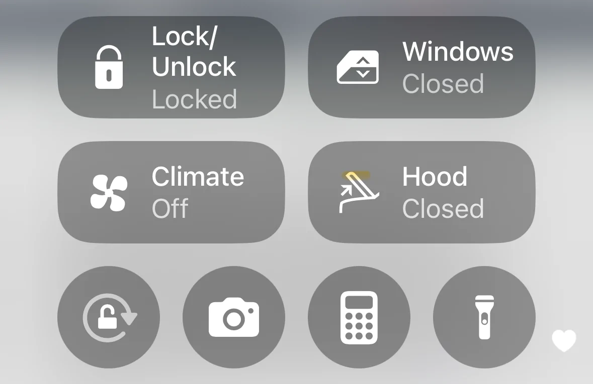

With my g2 R1T (at home, with auto unlocking off) I have had success with lightly touching my iPhone/finger to the handle, although it seems a bit more flakier in cold/wet weather. More reliable is using the iPhone Control Center
Rivian R1T R1S R1S Gen 2 - Advice on Managing Proximity Locking 1735062445495-2h

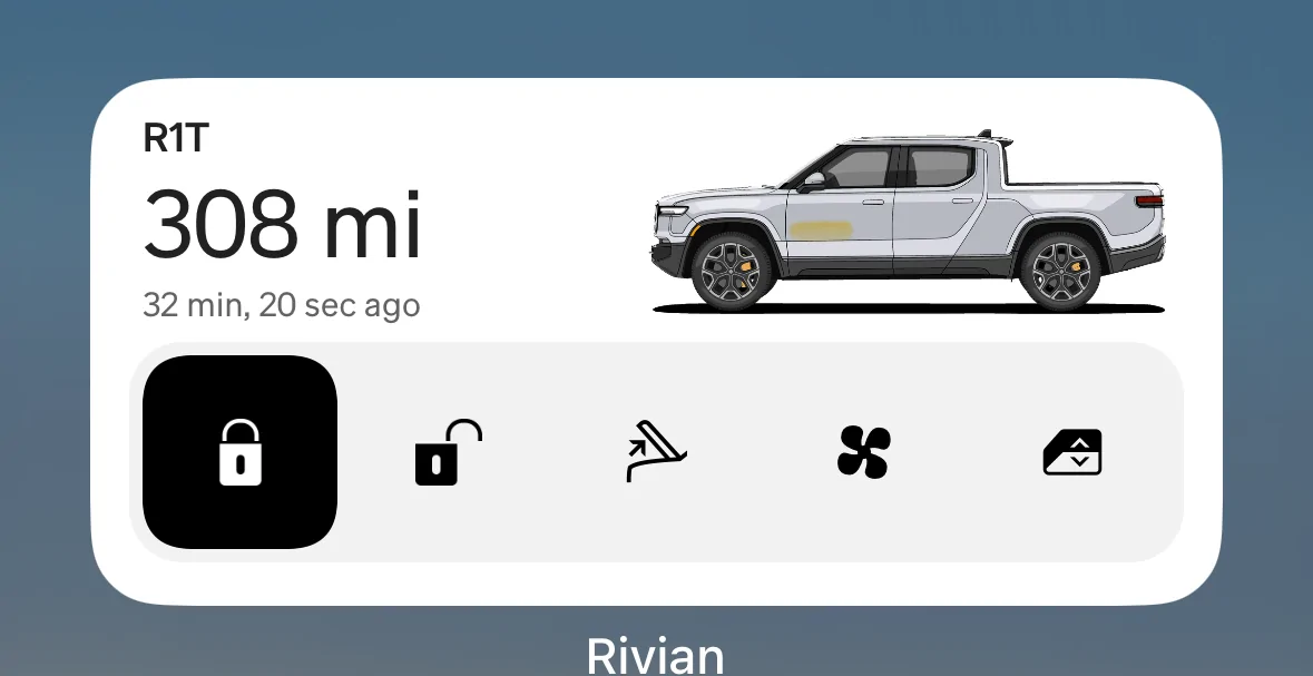

Or Home Screen widget:
Rivian R1T R1S R1S Gen 2 - Advice on Managing Proximity Locking 1735063045467-gd
