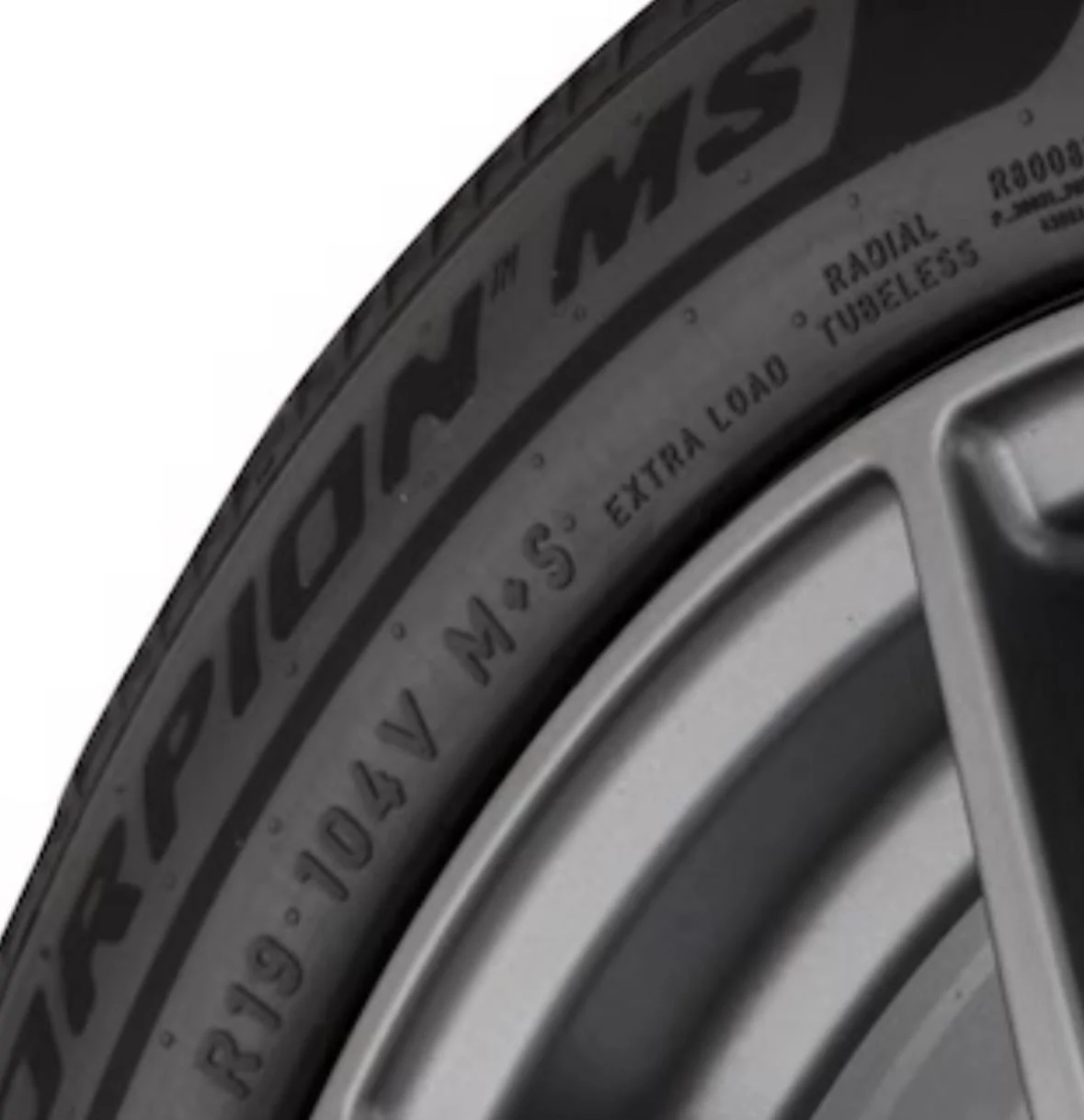

I believe your OEM tires are Pirelli Scorpion MS All-Seasons, which would mean they are M+S rated:
Rivian R1T R1S R1S driving in the snow IMG_4950
If you have these tires, then you will not be required to chain up on I80 or US50 unless they activate R3 chain control. I don't recall the last time they ever did that, however; they always close the roads instead whenever the snow gets that bad. CHP will still require you to possess traction devices at all times, regardless of your vehicle's requirement to chain up or not.
