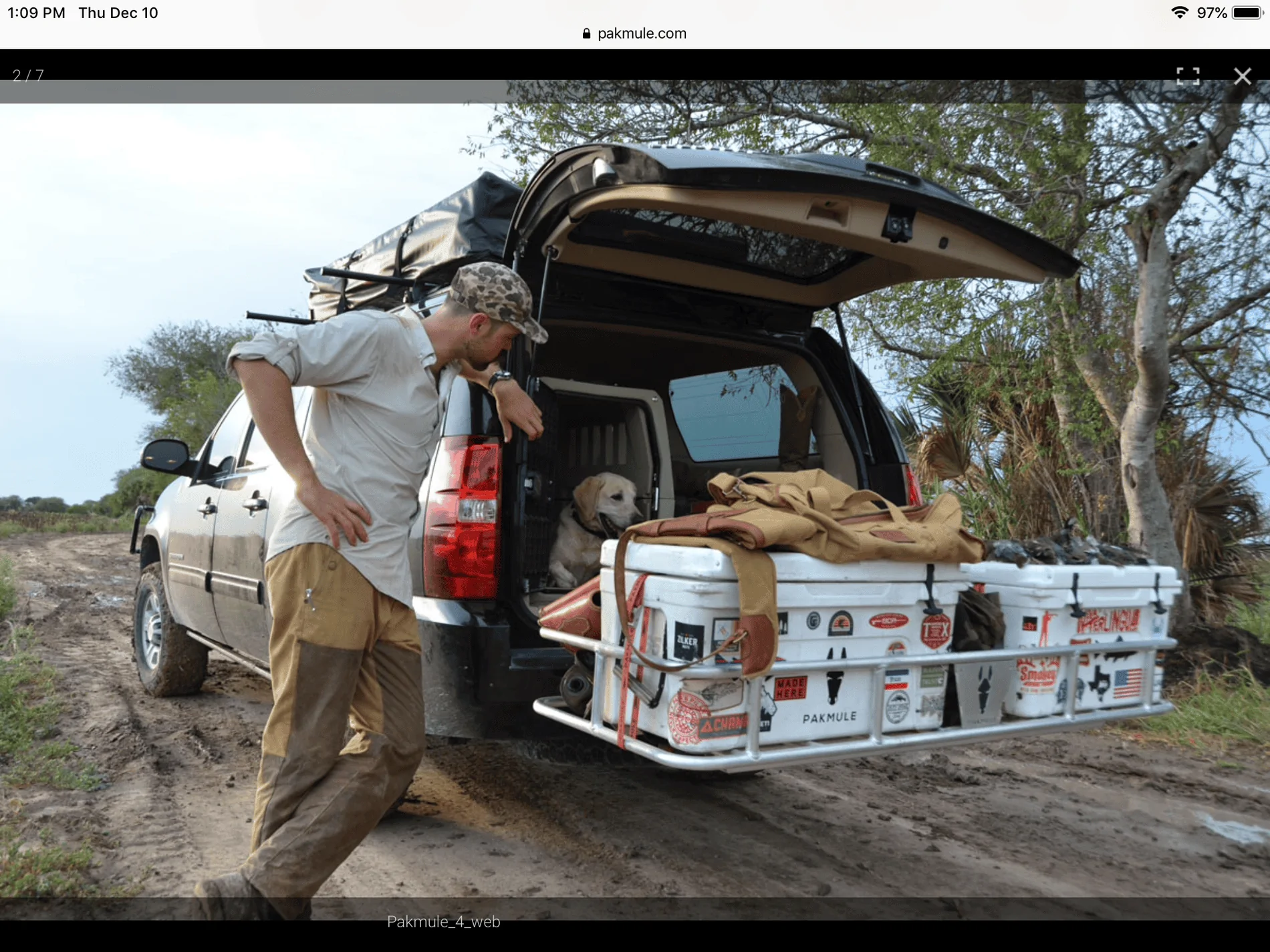

Here’s an option for more space to consider. Pak Mule’s hitch basket fits the R1T’s 2-inch receiver, is solid aluminum and practically bombproof. This is not the cheapie you buy at Harbor Freight - this is solidly built and is priced that way. I threw in for one because they had a special that you got their wall storage hanger free with a basket purchase and saved $100. Great way to haul coolers, firewood, bags or what have you. Pakmule.com.
My only caveat to this is Driver+. I know that Teslas don't always play nice when trying to use Autopilot with an obstruction back there. You may have to "drive dumb" if you're using a hitch basket.
