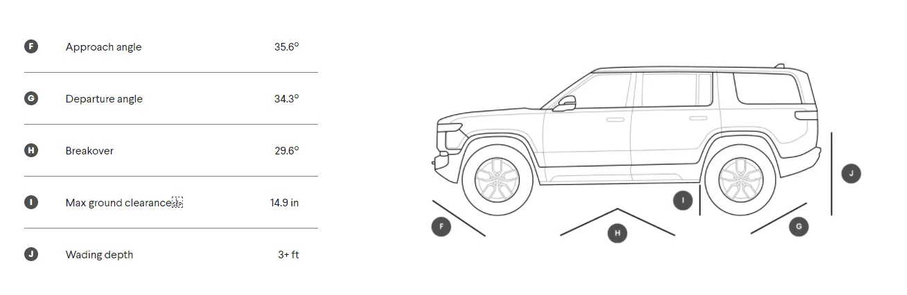

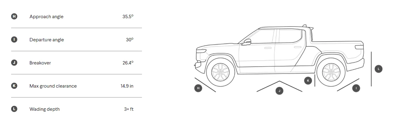

My guess is as good and possibly better.
It is the same drive train but shorter vehicle and shorter wheelbase. That gives it advantages in three of the categories (Approach, Departure, and Rollover)
Rivian R1T R1S R1S capability vs R1T offroad? 1633588909319
Rivian R1T R1S R1S capability vs R1T offroad? 1633588925493

The R1S will be better with a shorter wheelbase and a shorter rear overhang. However, the lack of a full size spare is a really big disadvantage.

It will be better in some ways and worse in others. It depends on what type of off-roading you do. High-speed desert running, for example, will benefit from the longer wheelbase on the R1T.
People saying one is always better than another are grossly over-simplifying it.

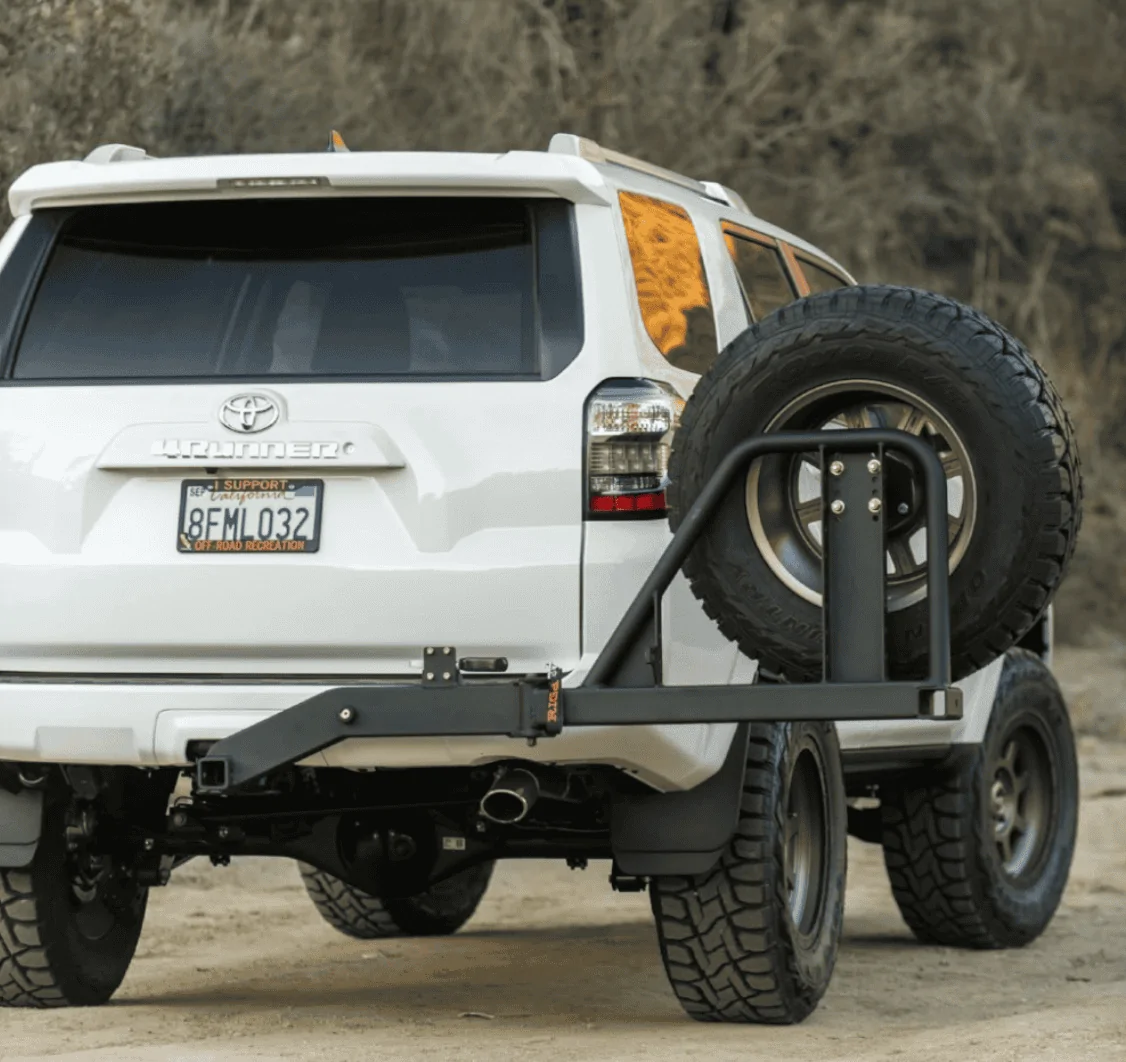

If the R1S is your choice for off-roading but you want a full size spare, there's a quick and easy solution - spare tire carriers for the receiver are readily avaiable in a number of designs.
Rivian R1T R1S R1S capability vs R1T offroad? 1633661014698

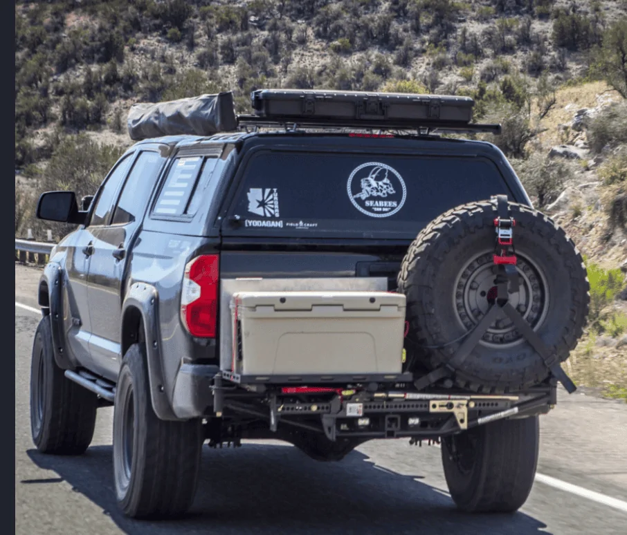

Here's another:
Rivian R1T R1S R1S capability vs R1T offroad? 1633661357366
