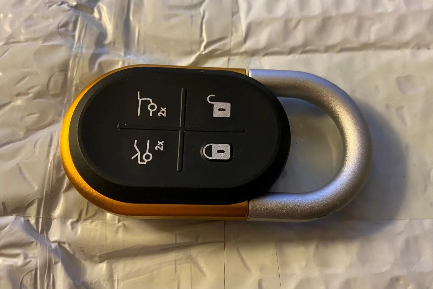

Concerning genuine Rivian key-fobs:
  1. Can a fob be programmed to work with either an R1T or an R1S? (Or are they model-specific?)
  2. Will a fob work with both a Gen 1 and a Gen 2 vehicle? (Or are they generation-specific?)
  3. Concerning the key-fob in the photos, is there any way to judge the age/generation/model?
    Rivian R1T R1S Questions About Key Fobs 1
    Rivian R1T R1S Questions About Key Fobs 2
  4. Finally, I know that Rivian key-fobs are not currently being supplied with new 2025 vehicles, and are supposed to be available as paid accessories sometime in 2025. I assume (but do not know) that the new fobs may be re-designed (and perhaps be incompatible with earlier vehicles)? Anyone heard any rumors or facts about this?
Thanks for any information.
#1 - Key Fobs are model specific. T is for T, S is for S.
#2 - Gen 1 Key Fobs (all fobs in the wild currently) can only be used on Gen 1 vehicles. You CANNOT program a Gen 1 Fob to work on a Gen 2 Vehicle. The technology is different.
#3 - The key fob in the photo is for a 2024 Model Year R1S. That is when they started using the white outlines on the fob. There may be a few LATE build 2023 with these, but they would be some of the last 2023’s to roll off the line.
# 4 - There are currently no fobs available for Gen 2 vehicles. If they end up producing them, that’s anyone’s guess at this point. Same with if it will look different.
