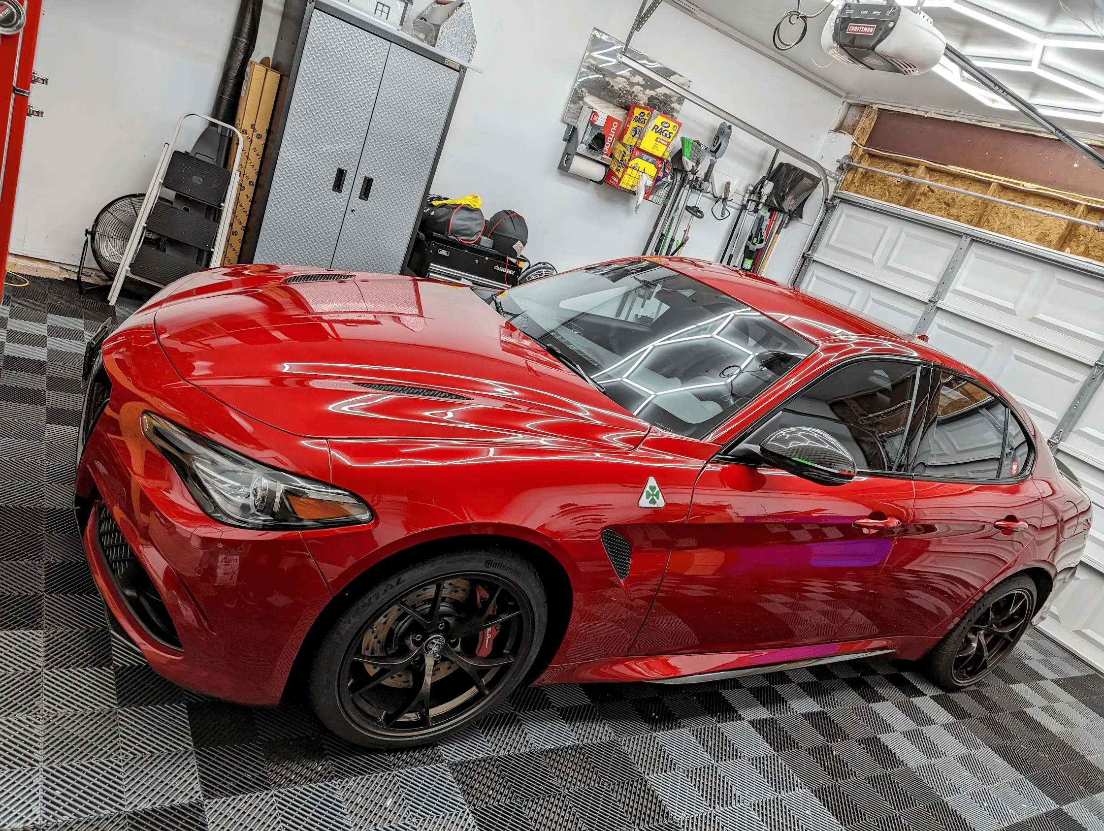

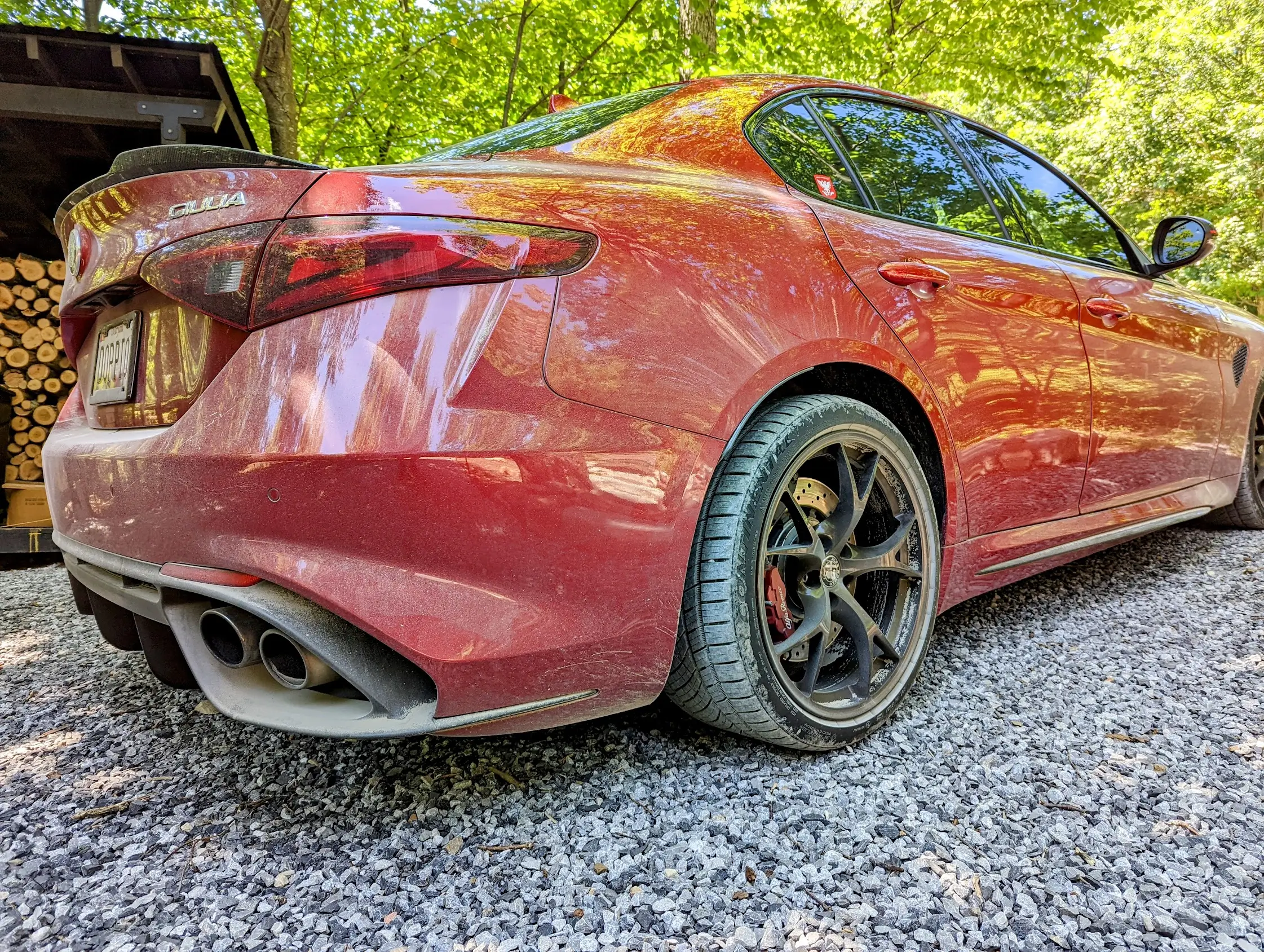

I use a LOT of FicTech on the exterior because it reduces a lot of labor/application time because you apply ceramic boosters etc to the outside of the car when its wet after washing. Its so easy and brilliant and gives amazing results (assuming you have taken care of your vehicle prior). From last week, a before and after shot (sorry no Rivian for reference YET)
