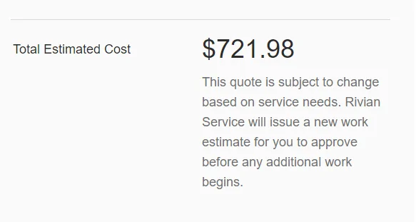

They send me the estimated cost to approve the 12-volt battery replacement.
Rivian R1T R1S Proactive replacement of 12v battery 1721776472054-t0

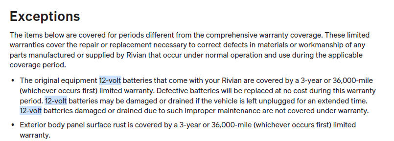

I objected to the cost because the Rivian warranty document mentions a 3-year / 36k-mile warranty on the 12-volt battery. I am still waiting for a response.
Rivian R1T R1S Proactive replacement of 12v battery 1721776647880-c2
