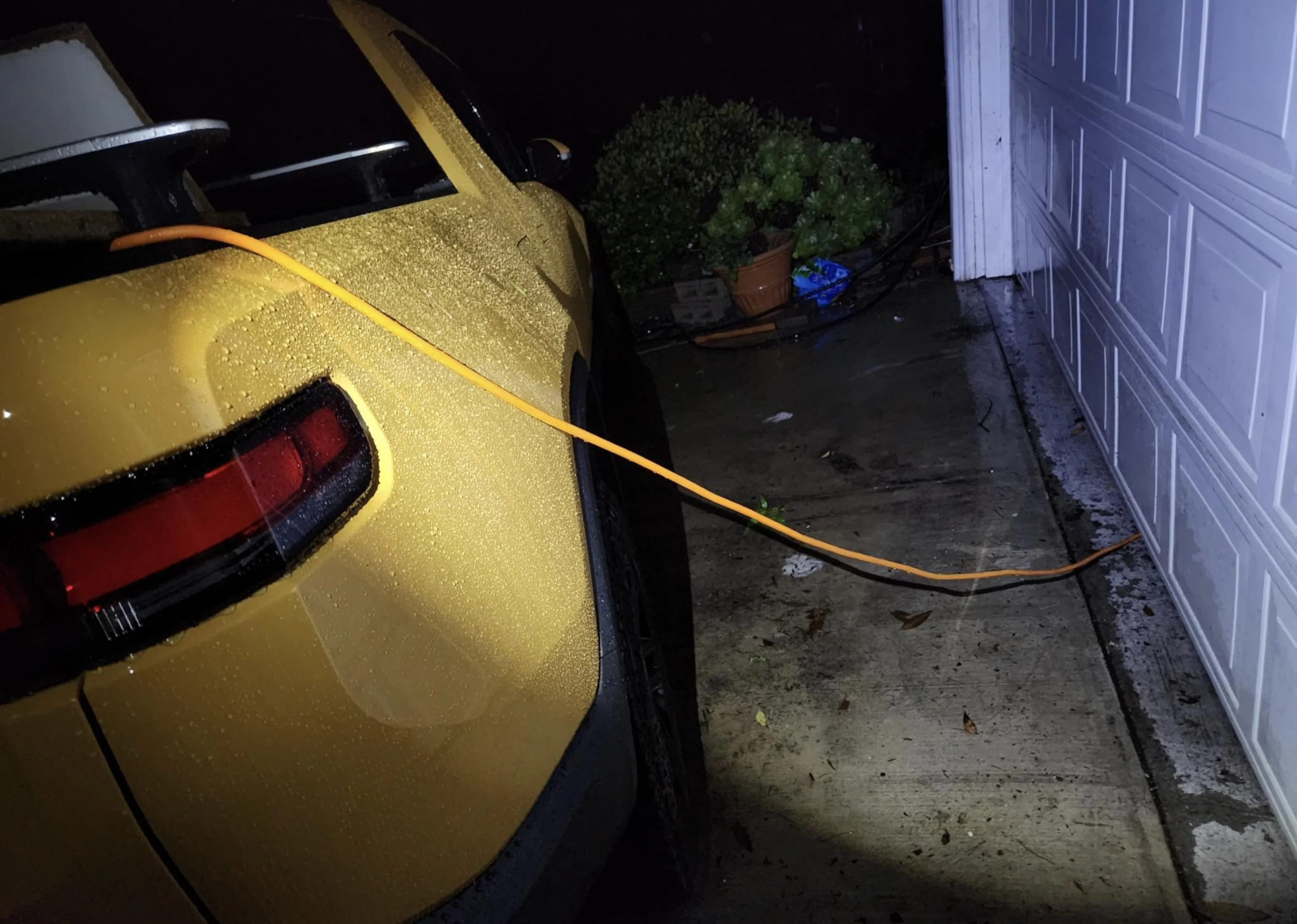

So we are having some heavy storms in LA. Power has been out for a few hours and the estimated time for it to come back on is 12 to 24 hours. I’m not even 2 weeks into ownership and my R1T is saving me. I’ve got an extension cord running into the house. The only house on the street with lights, working fridge, and high speed internet. The issue is I didn’t charge today and I’m sitting at about 45% charge. More than enough power technically, but I’m still a bit worried about going to bed and waking up to a dead truck. I know you can set a timer for the outlets, but what about a % charge minimum? I couldn’t find it in the menus. i know the lightning has it. I wouldn’t want to go below 20%.

I had the same issue in the last storm. Was pretty much maxing out the 1500w available and used only 7% in my 17-18 hour outage.

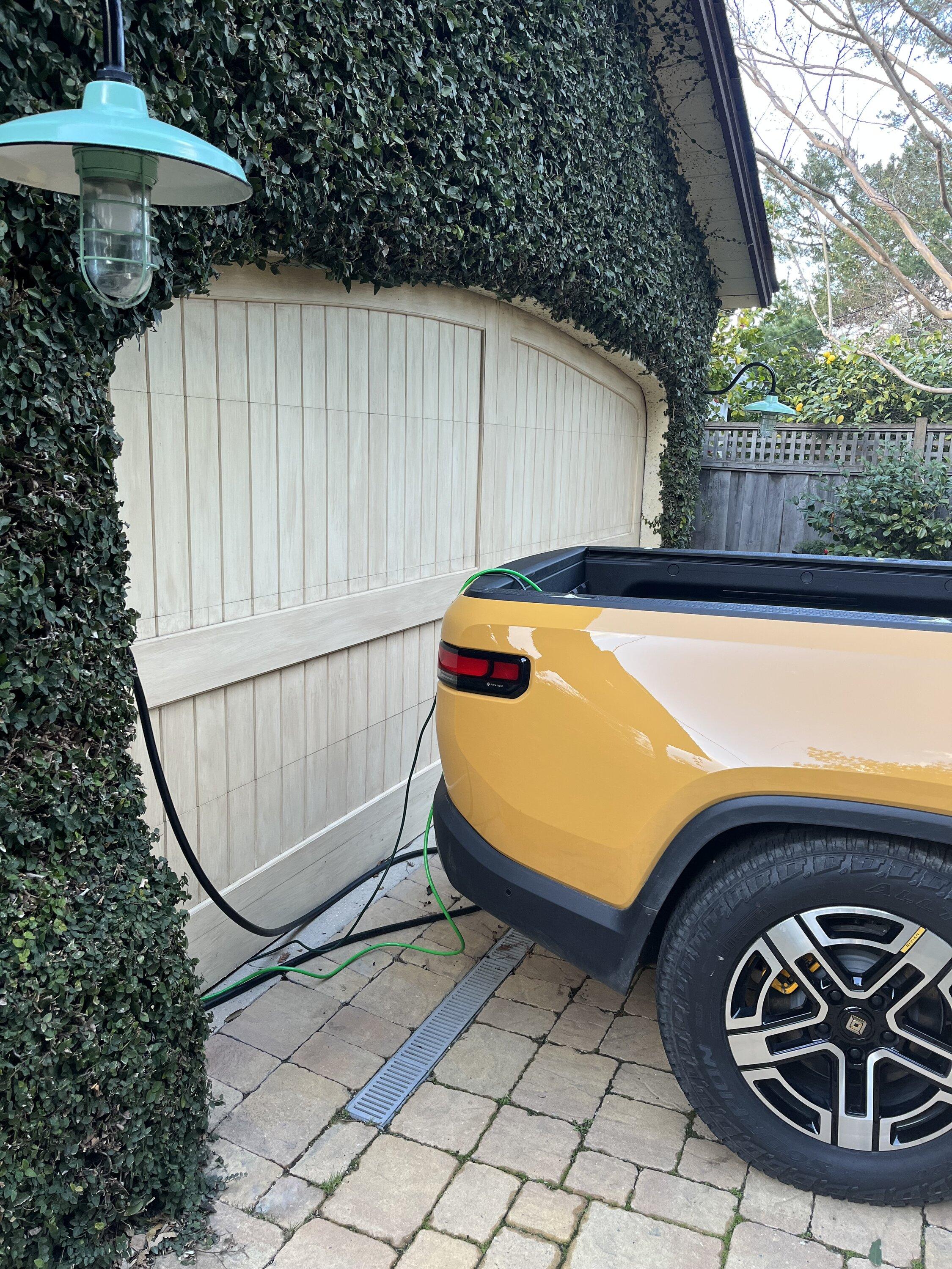

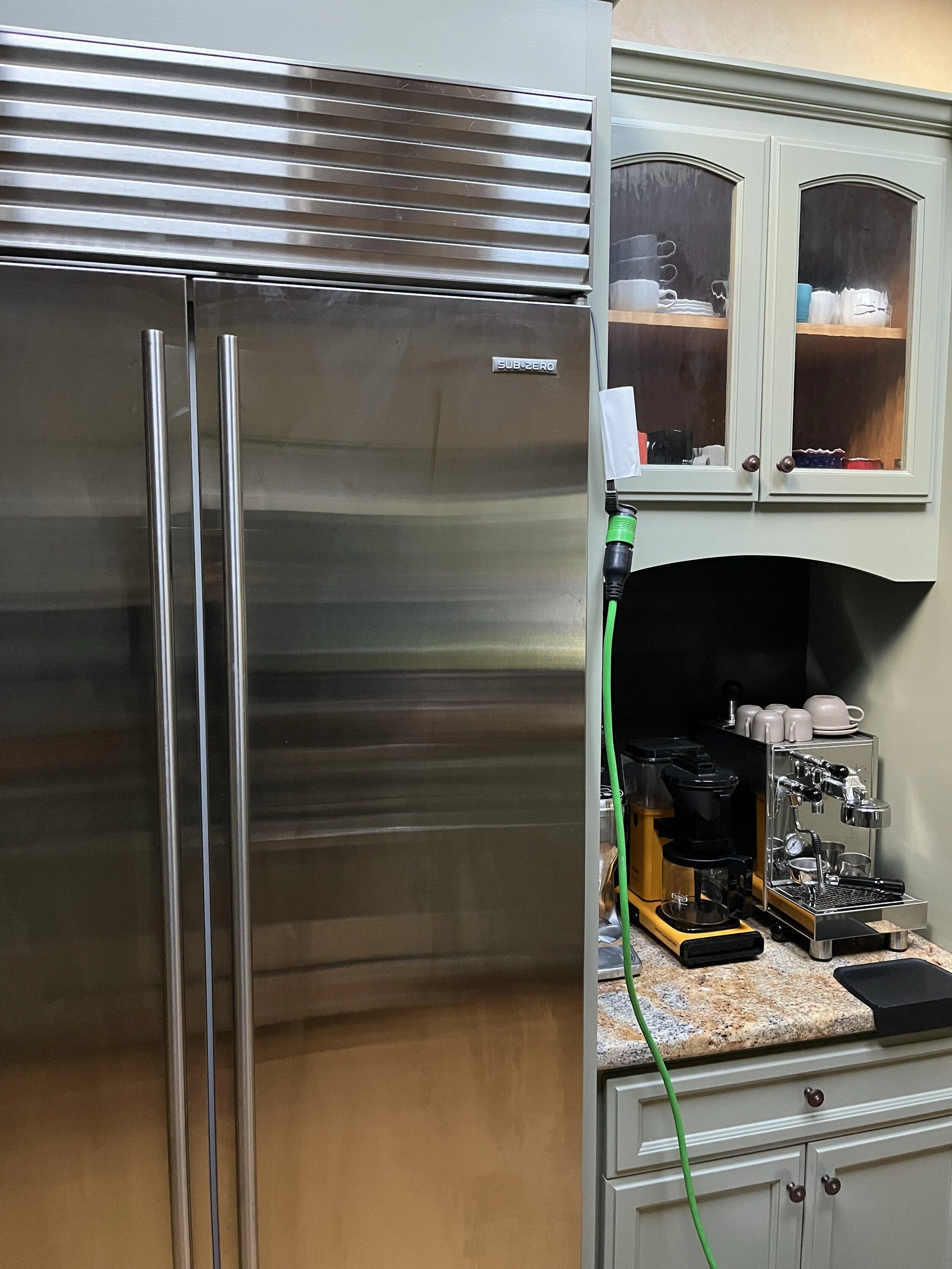

We just went through a similar experience up here in the Bay Area. We had no power for 52hrs, which was fun. We've never been without power for more than 4hrs in the previous 14yrs we've lived here, we're very much in an urban developed area and not on the fringe. Using the two 120v outlets in the truck I powered our fridge, tankless water heater (gas), furnace (gas), and some random small devices. At one point I unplugged the water heater to power a fan and my bike trainer (Wahoo KickR) so I could get in a workout. I mostly unplugged the w/h because I didn't want to daisy chain even more extension cords. Started with 64% battery, ended with 50% after 52hrs. No idea how close I was to maxing out the available power from the truck; the furnace and water heater are minor electrical loads seeing as they're gas. The fridge might not have needed much power since it was already cold? Either way it made a huge difference having hot water and heat. Not sure how much temperatures matter but it was uncommonly cold here with lows in the 30s with highs in the upper 40s. It would've been nice to able to reset the 24hr outlet timer via the app vs having to remember to go out to the truck to reset the clock. Obviously compass yellow R1T's offer more electrical power than all other colors so you should be good for several days ;).

This is basically what I did. The truck has 2 outlets in the bed. I ran one extension cord direct to the fridge since I figured this was the biggest load. The other was a power strip where I daisy chained 2 separate cords to the w/h, furnace, and one additional for small device charging. Not saying this is the best way, but it seemed to work.
