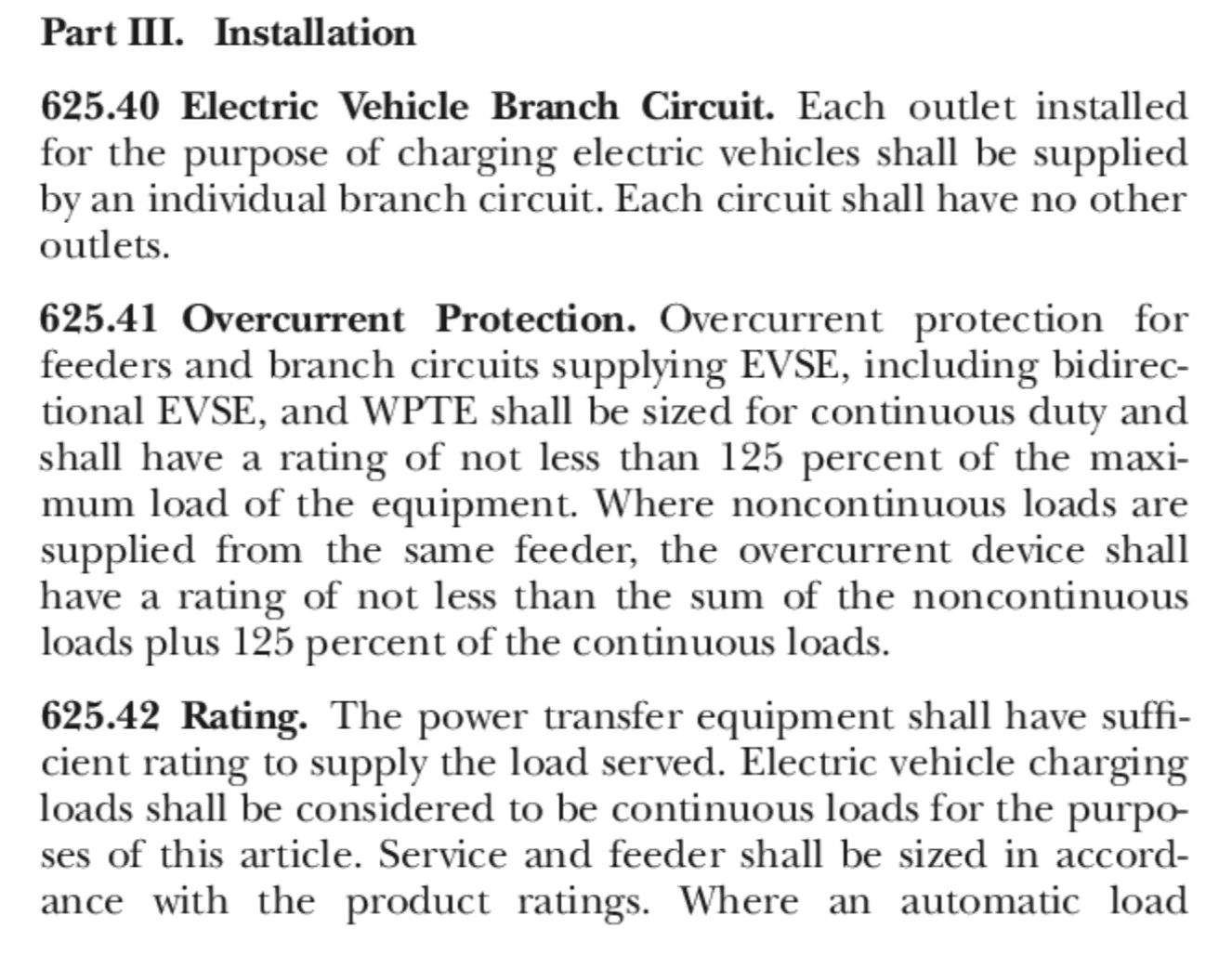

I guess my question is now, are there any disadvantages to sharing circuits with a dryer, aside from the fact you can't charge a BEV while using the dryer.
The obvious one is that it violates NEC which requires that EVSE be the only load on the circuit it is attached to.
I suppose the other one is that most dryers are on a 30A circuit so that you will get half the charging speed you would get with a dedicated 60A circuit.

The NeoCharge units are UL/cUL listed, but as far as I can tell, Dryer Buddy is not.
Rivian R1T R1S Potential Truly Game Changing Tech - Nano Diamond Self Charging Batteries 1599069704909
Rivian R1T R1S Potential Truly Game Changing Tech - Nano Diamond Self Charging Batteries 1599070035219
The NEV specifies that a circuit installed for an EVSE be dedicated, but makes provisions for using existing circuits that may have other loads as well.
The NeoCharge units appear to qualify as an automatic load management system, as do some models of the Dryer Buddy

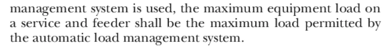

The intent of 625.40 is clear. If you use one of these devices you plainly remove the protection that 625.40 is designed to provide. If the outlet is installed (for the dryer) then there is no question of any inspector (except perhaps an insurance company inspector) ever looking at it and as an outlet installed for a clothes dryer, pre or post NEC2020, was not installed for the purpose of charging electric vehicles then you would have an argument in the case of denial of an insurance claim. The decision to adhere to 625.40's intent or work around it is up to the guy buying the system.
625.42 does not say that if you have an automatic load management system the requirement of .40 goes away. What it does say is that the installed EVSE must be rated as continuous and compatible with the load shedding gear. For example, a Tesla HPWC installed behind a Symphony 50A load shedding module would have to be set as if behind a 50 A breaker because the maximum it can draw is 40A when so set.
These devices are indeed load management devices. If the car's load exceeds what ever you set into the device as the current limit then the car's load is switched off. This is perhaps not the usual sense in which the term is used but technically it is load management but it does not have anything to do with .40.

.41 states that other loads may supplied from the same feeder (and the formula to calculate circuit rating in that circumstance), which is in conflict with if you interpret .40 it as meaning any circuit used to charge an EV. If you you take .40 to mean actually installed for the purpose of charging an EV, then existing circuits can have other outlets and loads. If this was not the case, portable 120V EVSE could not be used on existing circuits (unless you for some reason had one with just a single outlet and no lights or anything else hardwired)
