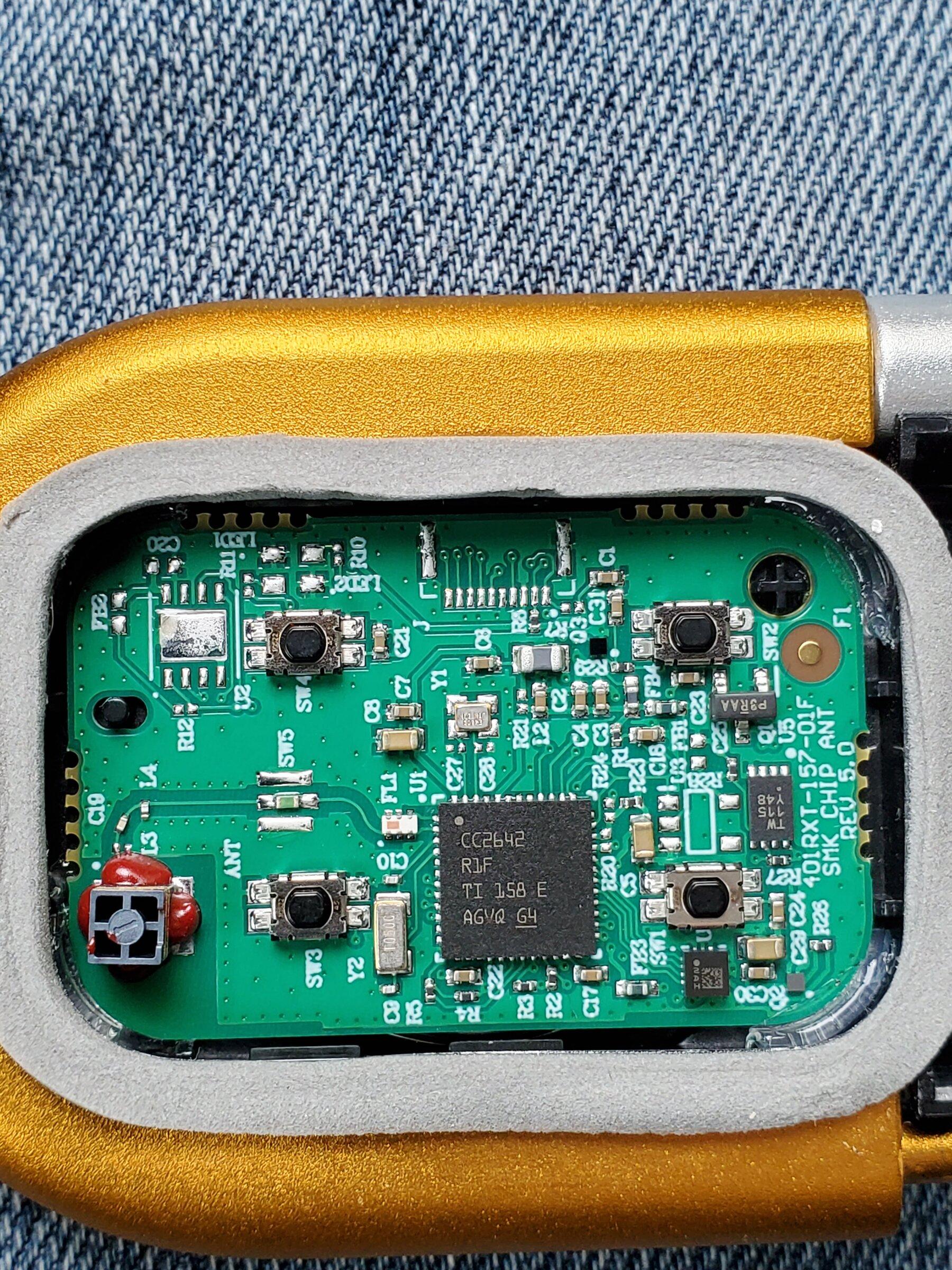

As a short disclaimer, I make no claim to be an EE, and I don't deal with embedded systems. But I was curious about the FOB, based on the language in the settings page that has been discussed here, so I took it apart. I'll post pictures when I can.

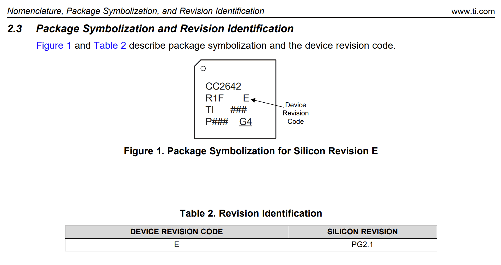

The FOB has, what appears to be, a Texas Instruments CC2642R SimpleLink Wireless MCU with Bluetooth 5.2 Low Energy:
There is an interesting demo posted by TI using this chipset as well:
Connect: BLE connected electronic door lock demo | TI.com Video
And here is the datasheet:
CC2642R SimpleLink™ Bluetooth® 5.2 Low Energy Wireless MCU datasheet (Rev. H) (ti.com)
