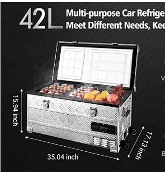

I have one currently in my current car (4Runner) that is very convenient. But, 19 inches tall. DOH. This is the only one that I have found that will fit under the tonneau cover, but not sure of the brand.
Rivian R1T R1S PORTABLE REFRIGERATORS for Rivians -- 12V or 110V?? 1648831475327
This looks promising! Anyone have any experience with Bodega car refrigerators?
