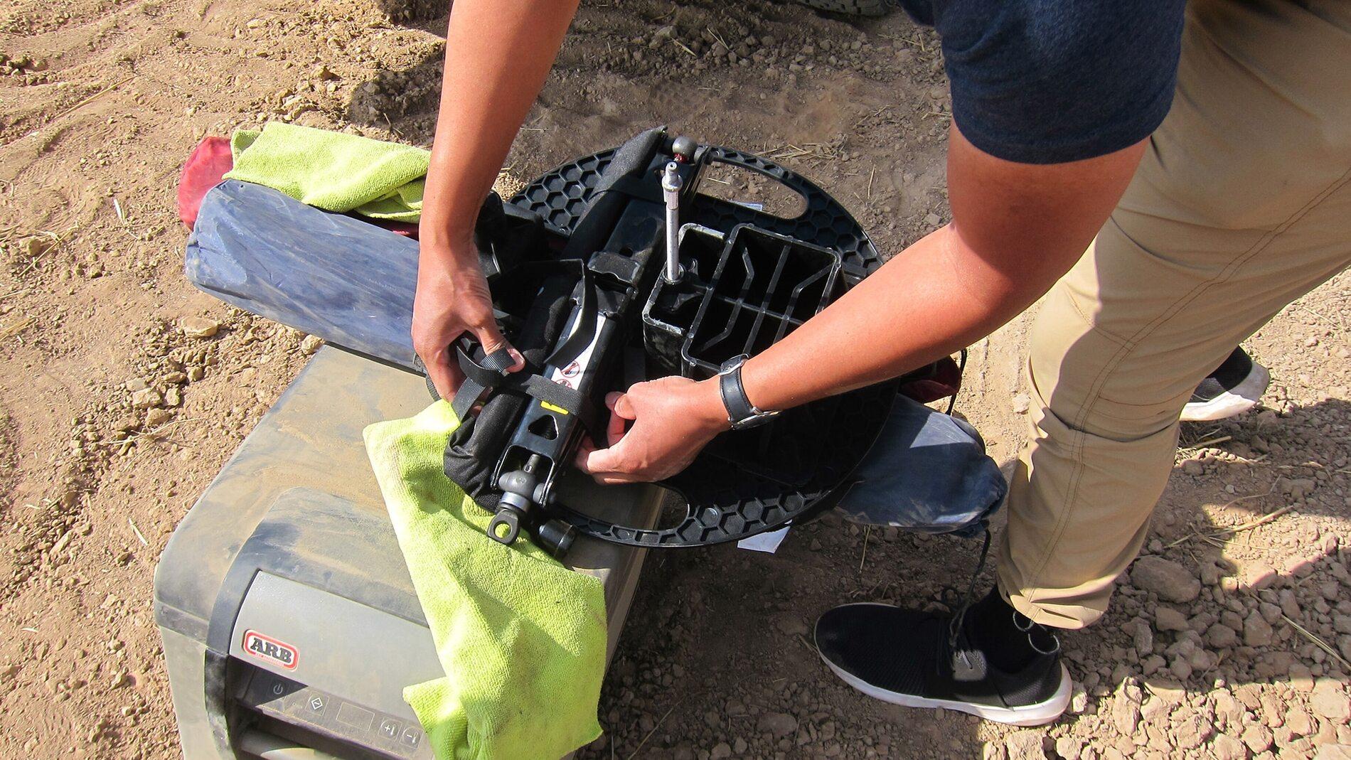

I don't claim to know anything about portable fridges, but I did notice one in the MotorTrend tire article:

I'm sorry - You appear to be incorrect. That is clearly a table. :p
Ok yes - I bored..... at least next week there will be football on Sunday.
