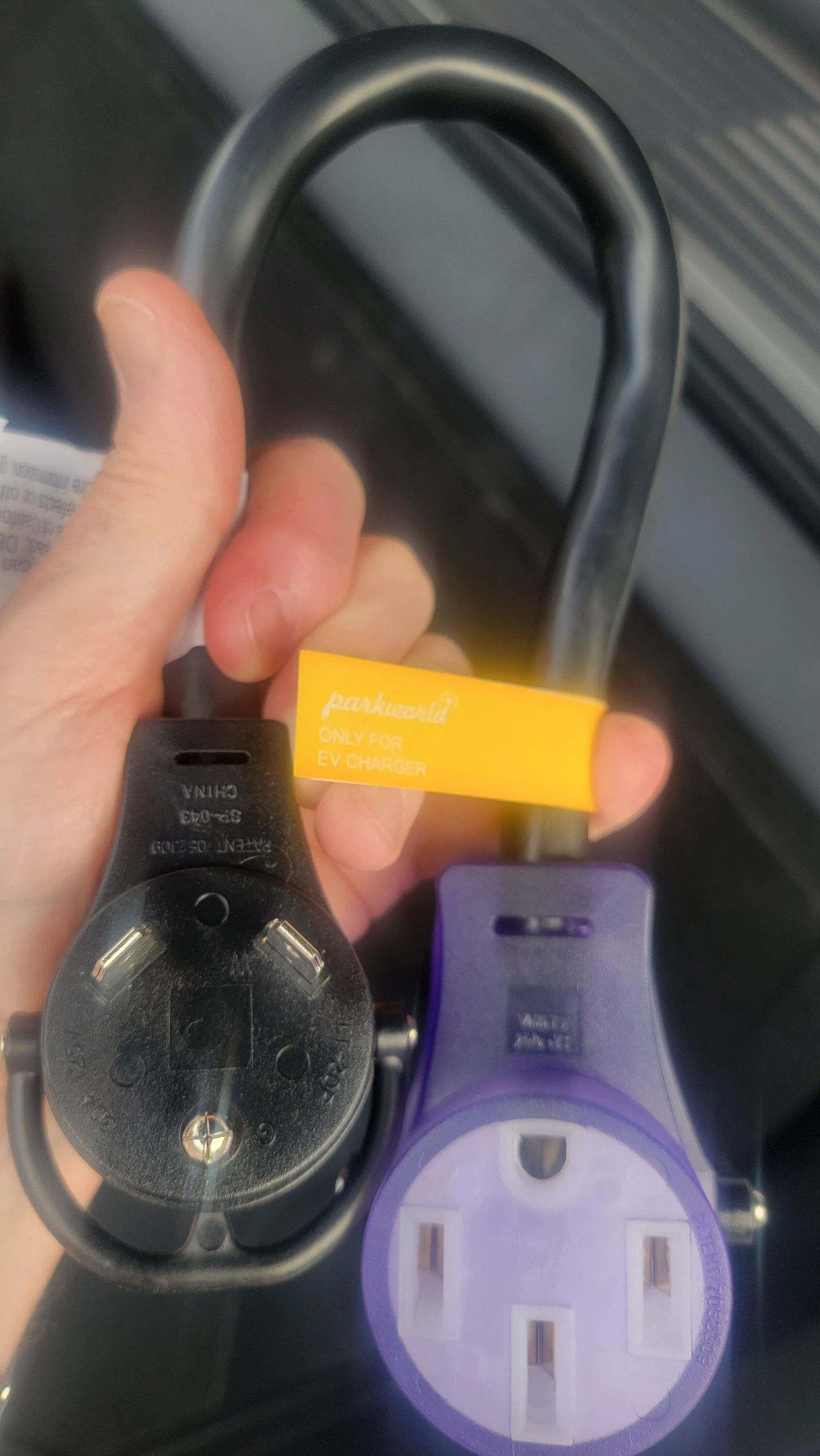

I picked up this adapter off of Amazon (~$39) to allow me to plug the portable charging unit into a 30-amp circuit.
Correct me if I'm wrong, but when I plug this into a 30-amp circuit to use the Rivian's portable charger, isn't it best to reduce the charge on the User Interface to 24 amps, to avoid overloading the circuit from which I'm charging?

You can use an adapter and limit the charge to 24A in the charge settings.

There is a big difference between the TT-30 plug and the 14-30P.
The TT-30 is 120V 30A (3600W) and typically used at RV parks. You would get about 2880W of charge.
The 14-30 is 240V 30A (7200W) is used for dryer plugs and will provide about 5760 W of charge.
@JEV,
Thanks for that clarification! I was aware there was a lesser charging-rate involved, but didn't know the numbers. I picked this up just In case it becomes the difference between gaining some juice, or being stranded. In checking out the internet for RV parks, I noticed some remote ones are limited to 30 amps, and thought it wise to grab this.
If it saves me only once, I won't regret the purchase.
Thanks again!
